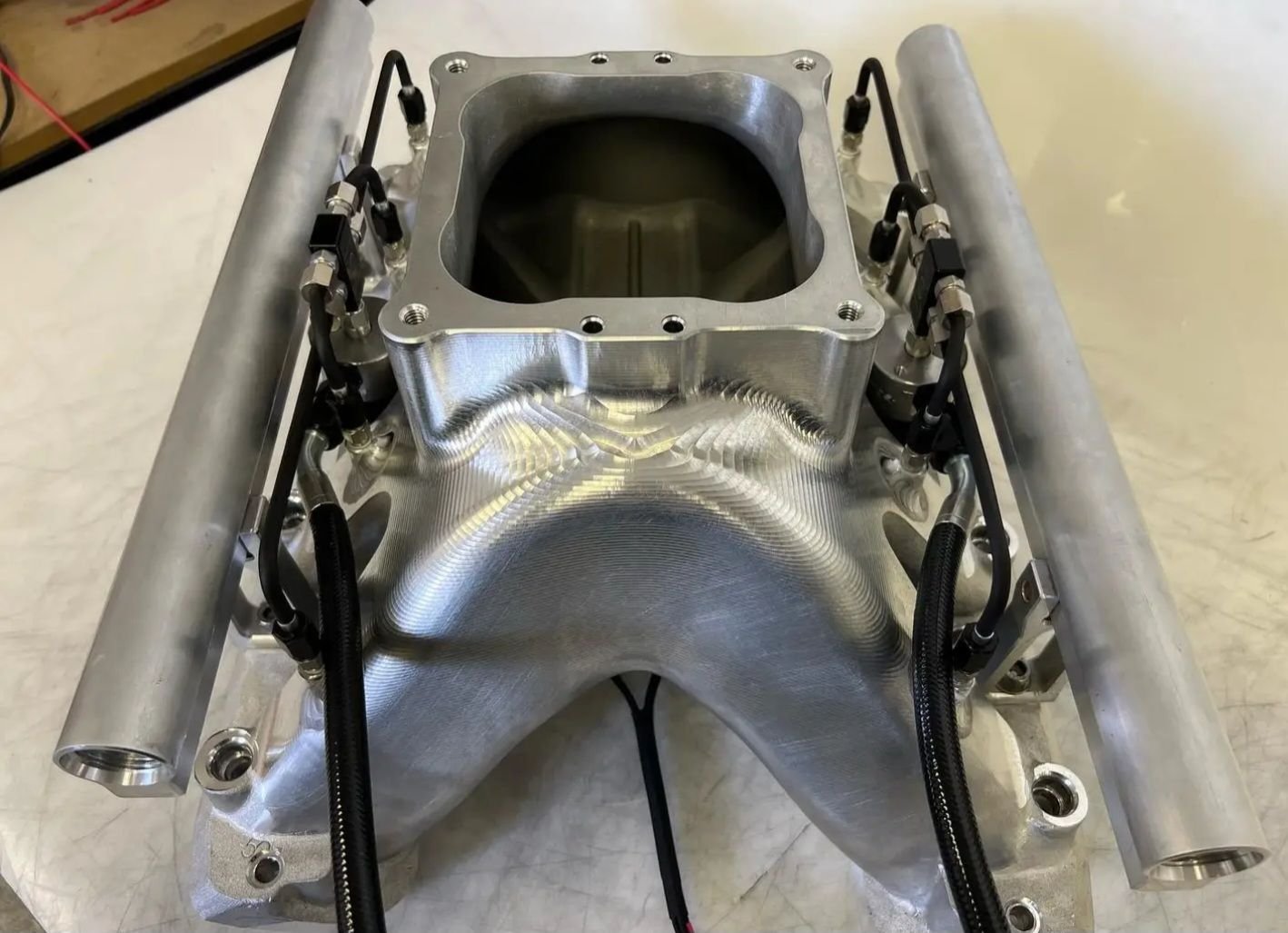

Finally back from FED for a valve job and had chambers softened for N20. The new 4.5 intake is out getting plumbed with a dry kit and should be back in a week or so. Yep I'm gonna fck around and find out!

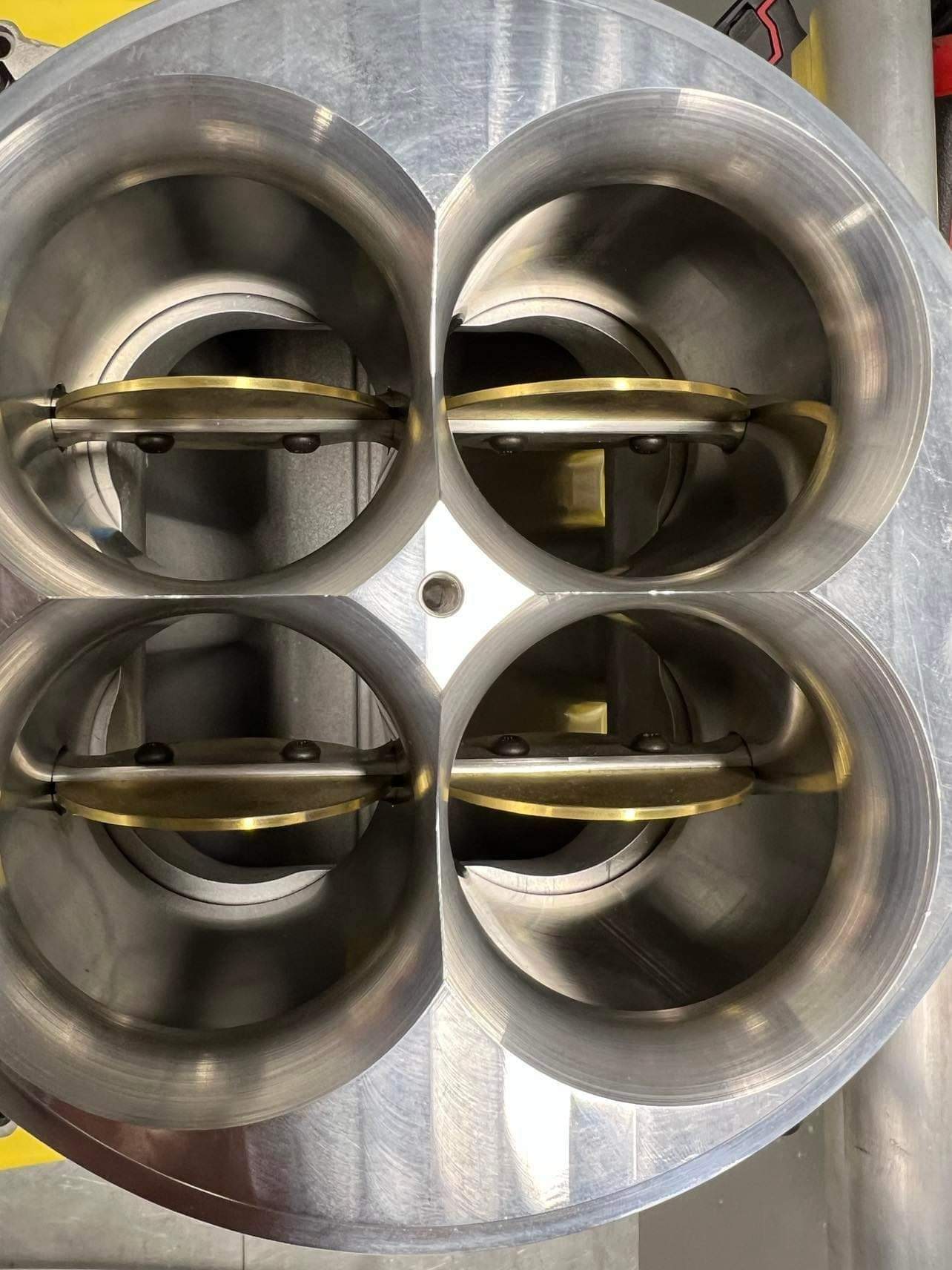

Houston, we have a problem. Intake going back to FED to get the port match corrected. Unsure which TB they used so my Accufab 6500 will be headed their way for proper alignment. My head hurts.

FED made good on their error by fixing the port and turning around the intake in a week (shipping on them too). Learn from my mistake and if a shop is going to port match anything, don't assume they have what's needed. Send them everything. In my case it was the intake AND the throttle body.

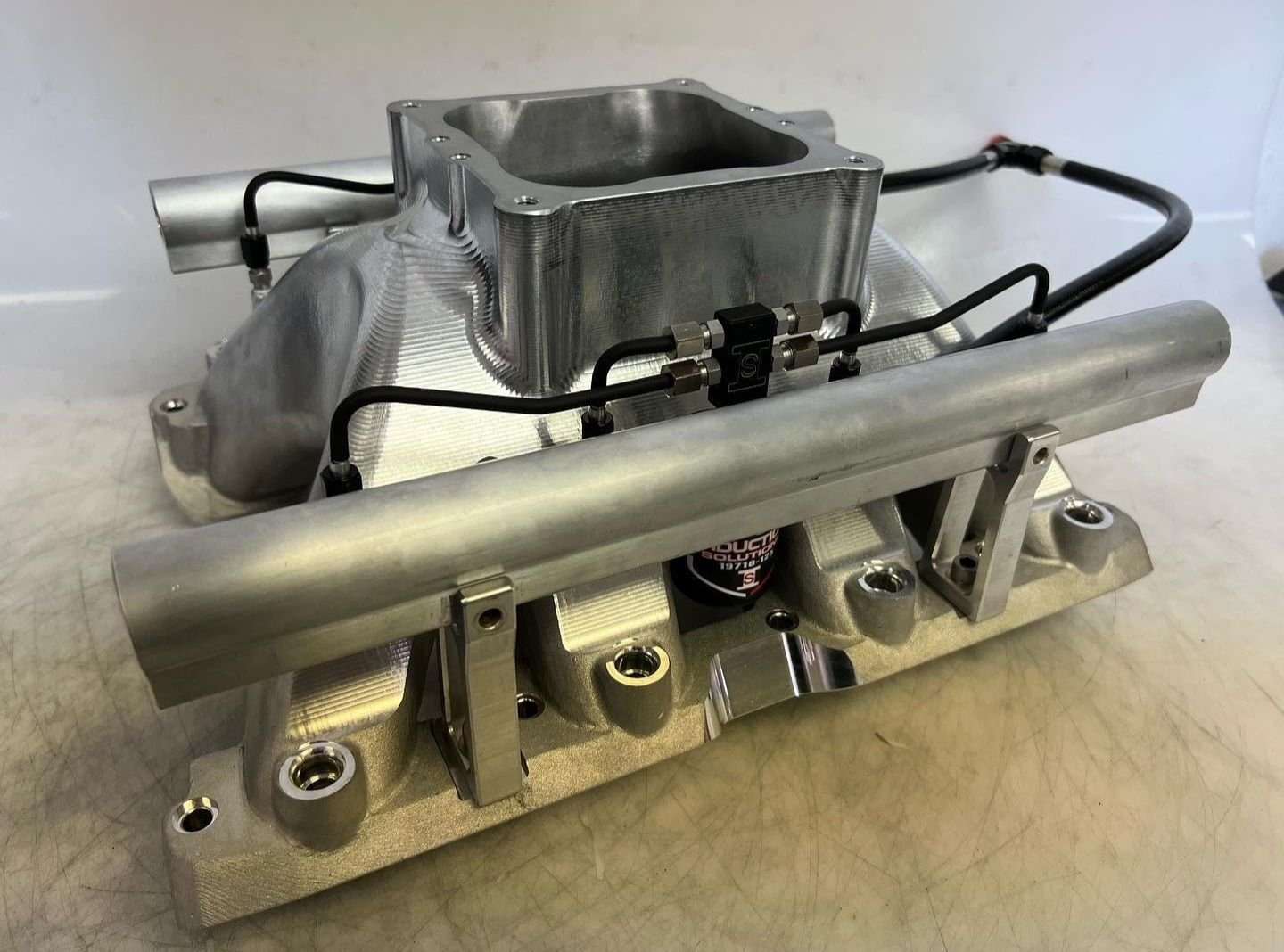

New nitrous combo almost complete. And man the 6500 TB is so much bigger than the 4500.

looks great. who makes that timing pointer?
