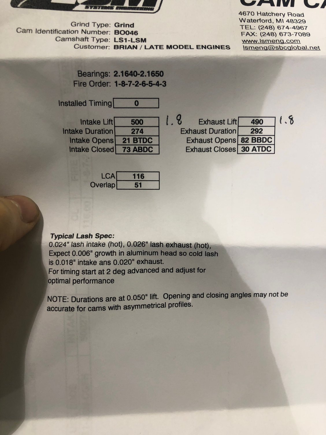

Pretty stoked to get this update from LME, still waiting on yet another cam but progress is being made.

Old Jul 26, 2020 | 01:15 PM
  #85
Darth_V8r's Avatar
Moderator
Joined: Jul 2014
Posts: 10,451
Likes: 1,873
Dang that is one healthy bump stick
it is for sure, will have to stay on top of checking springs.

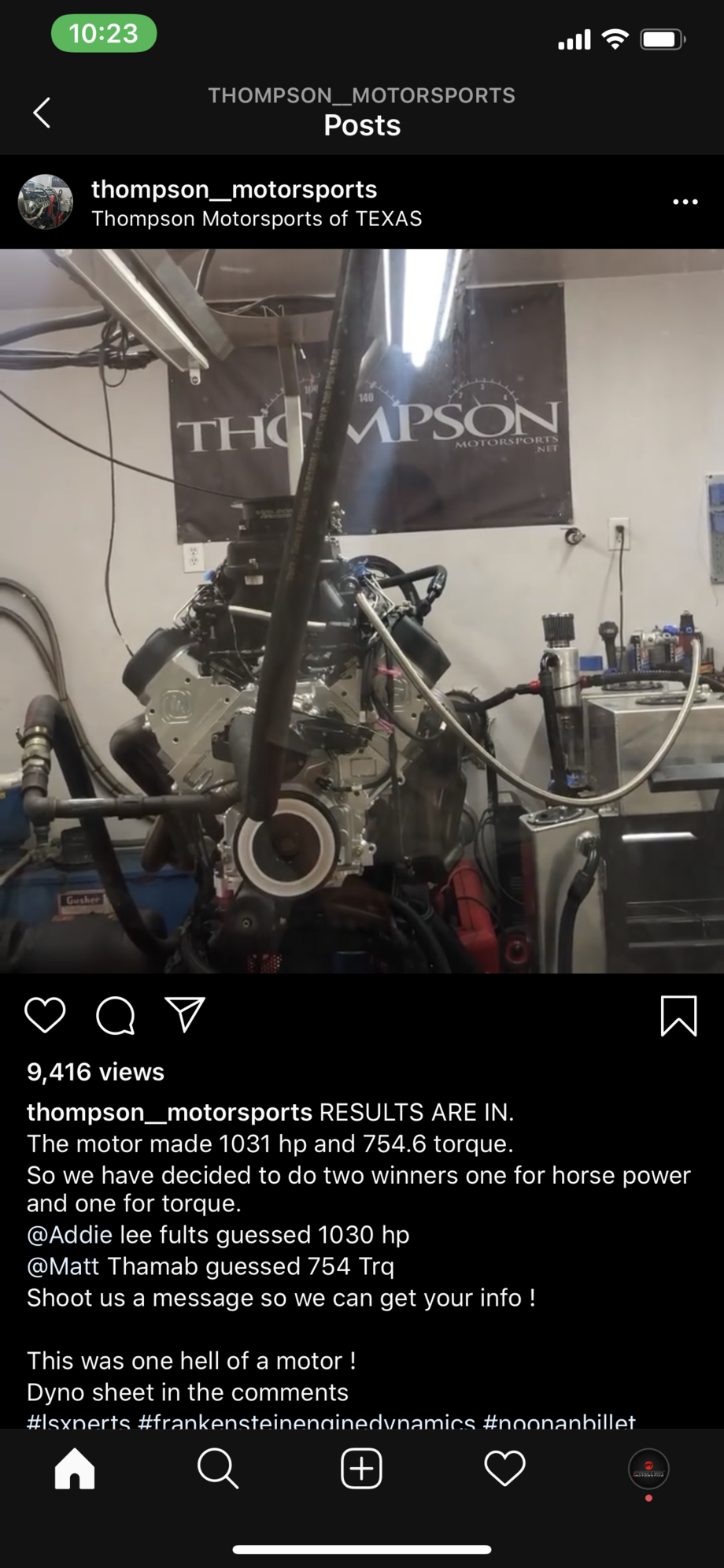

Update 8/20
The motor is complete and should be going on LME's engine dyno today. Any guesses to what it will make?

This is going to be the longest day ever! I'm going to play it on the safe side and say 930HP

Was just going to post here, there is no updates. Nothing from LME, at this rate I'd figure I'll see a insta video or post before they let me know how it went. Gets me down a little to see Vengeance getting all the love, I know I'm just a small shop and this is my first motor built by LME but I would have expected better communication. Not to say anything bad about LME, I know their work is top notch and that's why the motor is there and not anywhere else. Will see how today goes and I will post as soon as I hear something, also I'm going to say it makes 1025 HP @8500 and 720 TQ.
