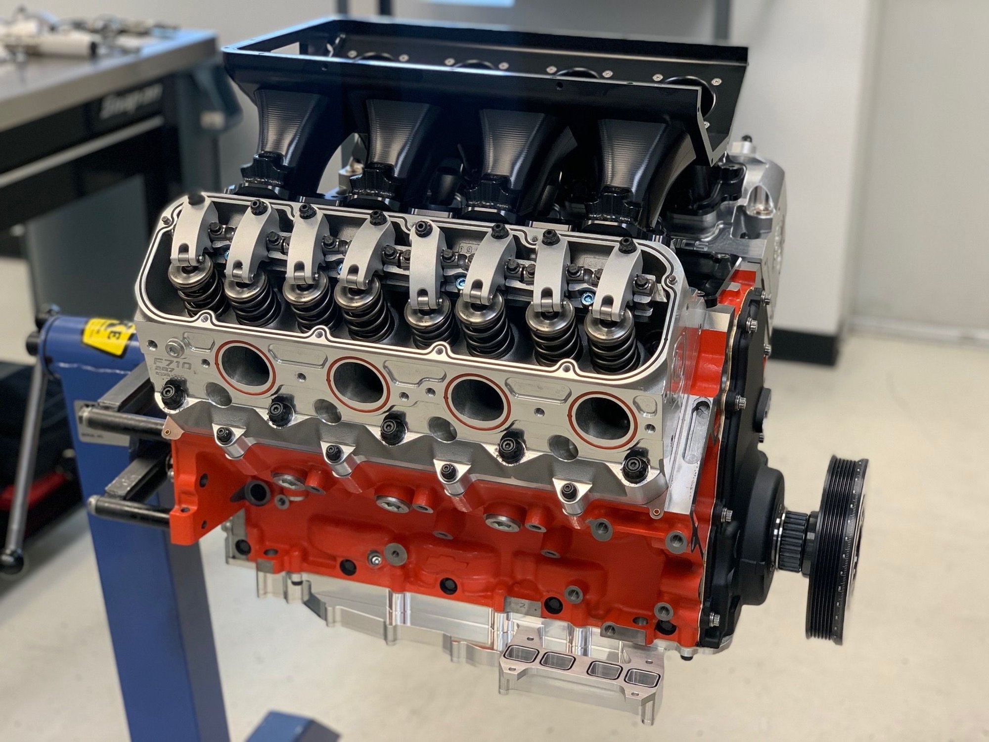

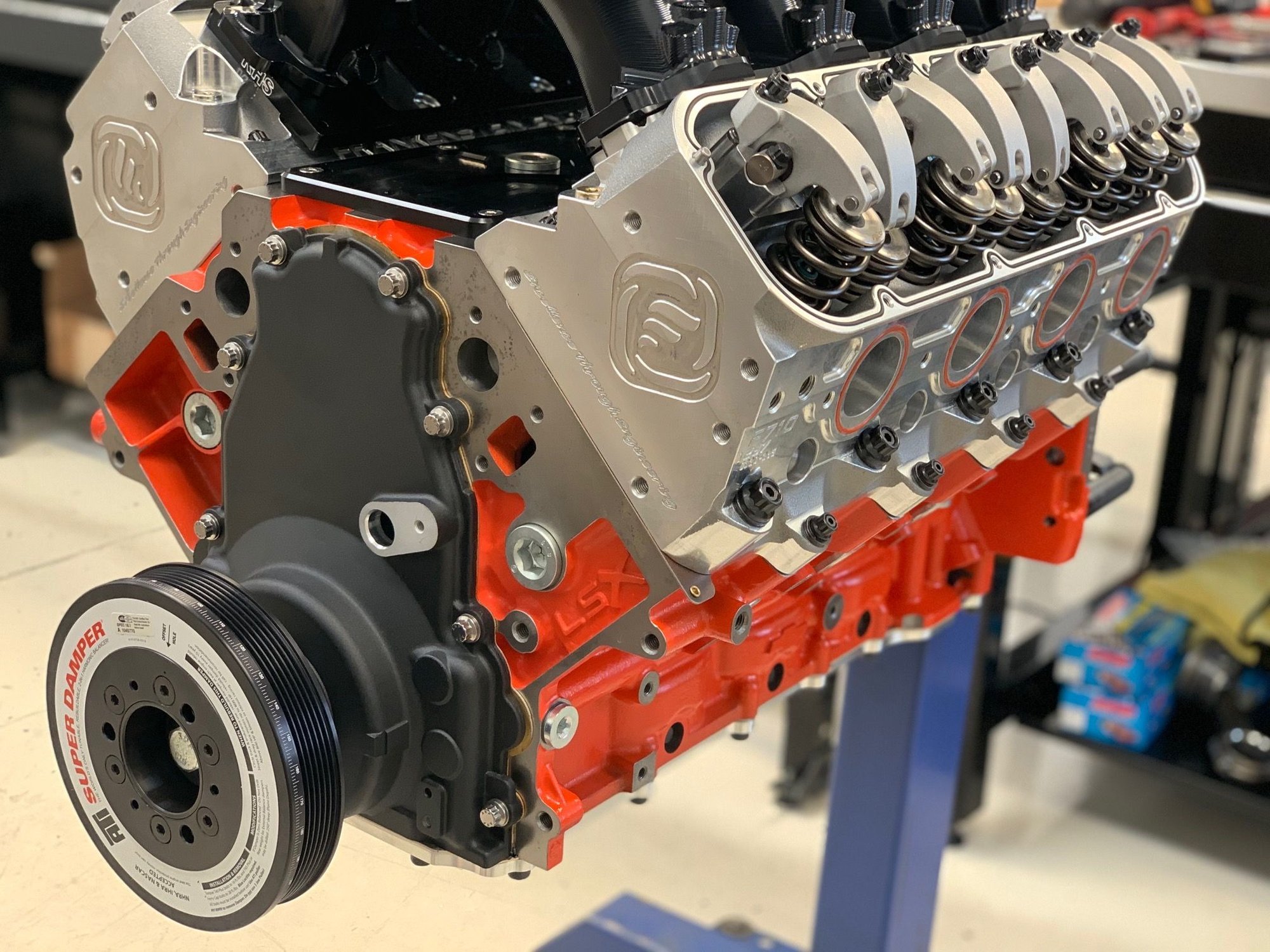

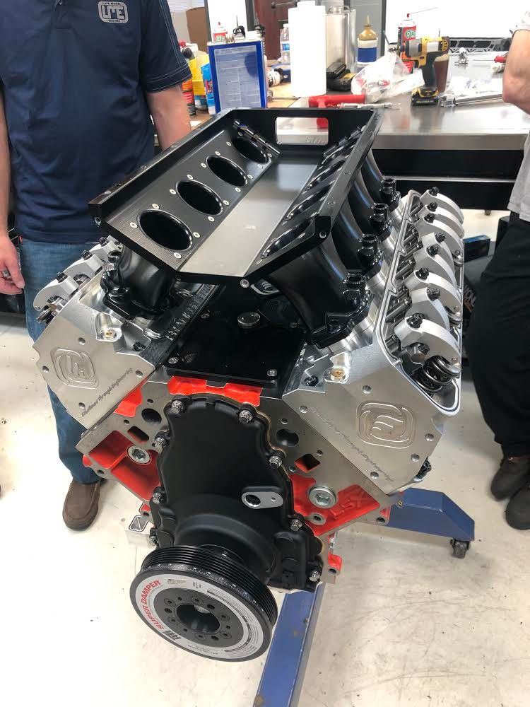

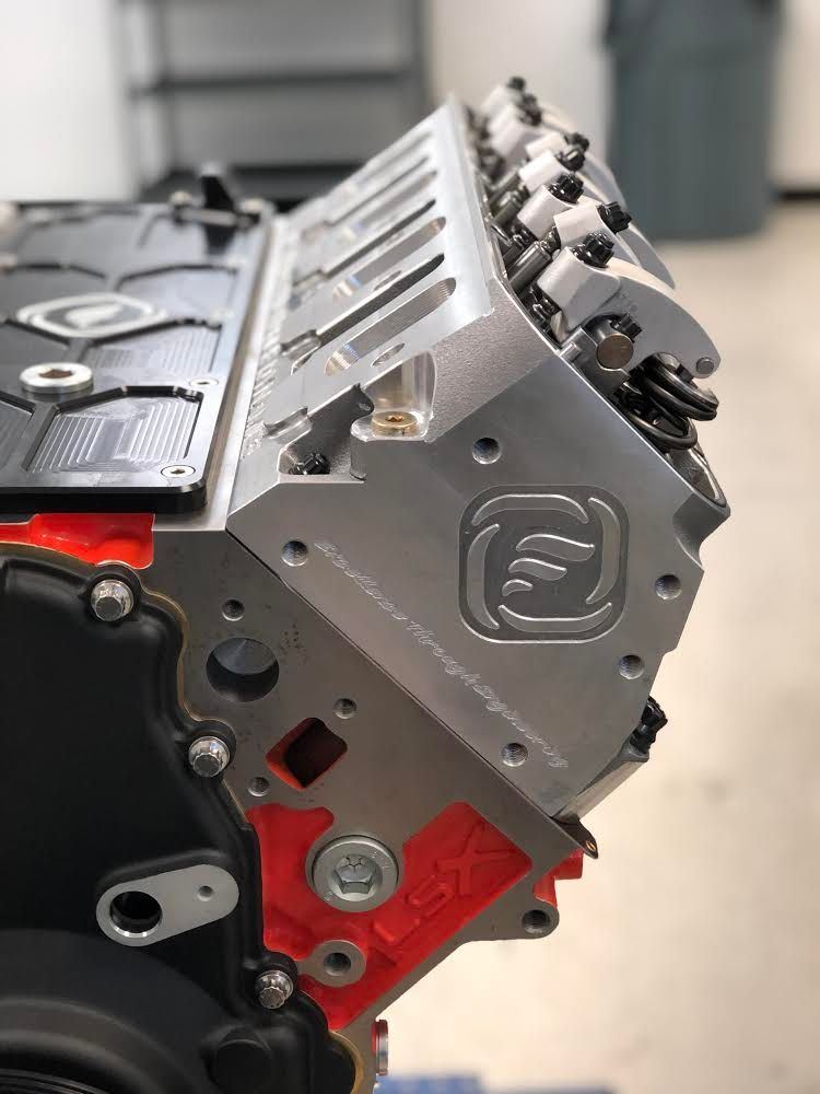

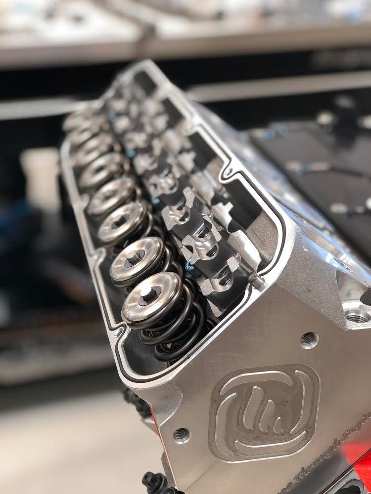

So no dyno today, they were milling the intake spacers for perfect alignment. But I did get these!!! 😍😍

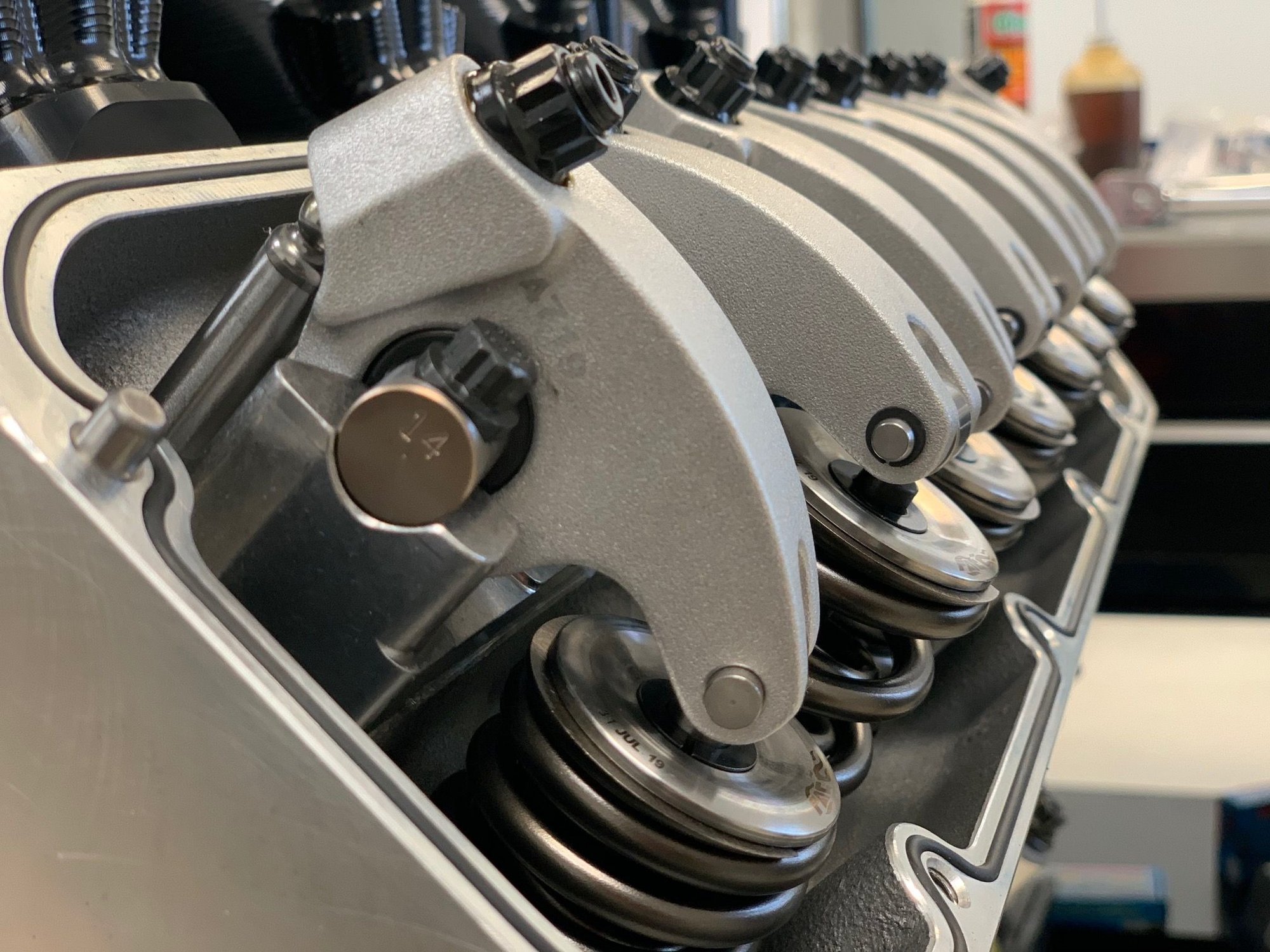

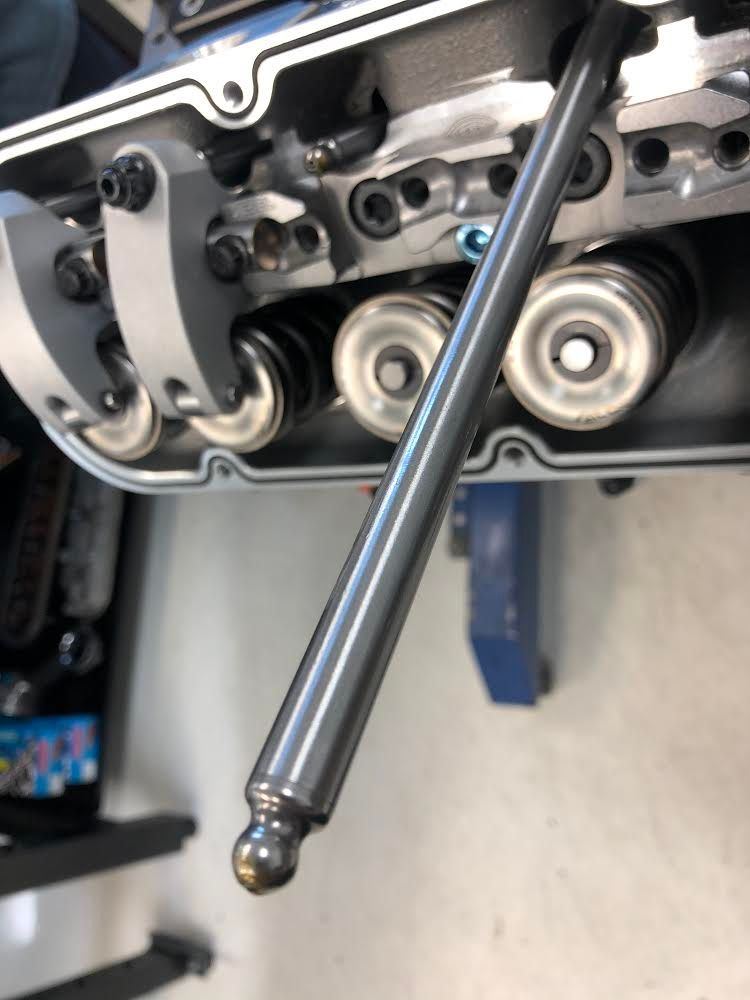

Jesel shaft mount roller rockers?
Whose push rods are those?
Old Aug 21, 2020 | 10:27 PM
  #108
spanks13's Avatar
Joined: Oct 2008
Posts: 1,422
Likes: 618
Why does it use intake spacers on a std deck block?
Old Aug 21, 2020 | 11:34 PM
  #109
95sscamaro's Avatar
Joined: Jun 2009
Posts: 903
Likes: 579
From: Cartersville GA
yes custom Jesel rockers for the F710s, Manton 7/16 to 3/8".
it’s a tall deck block.

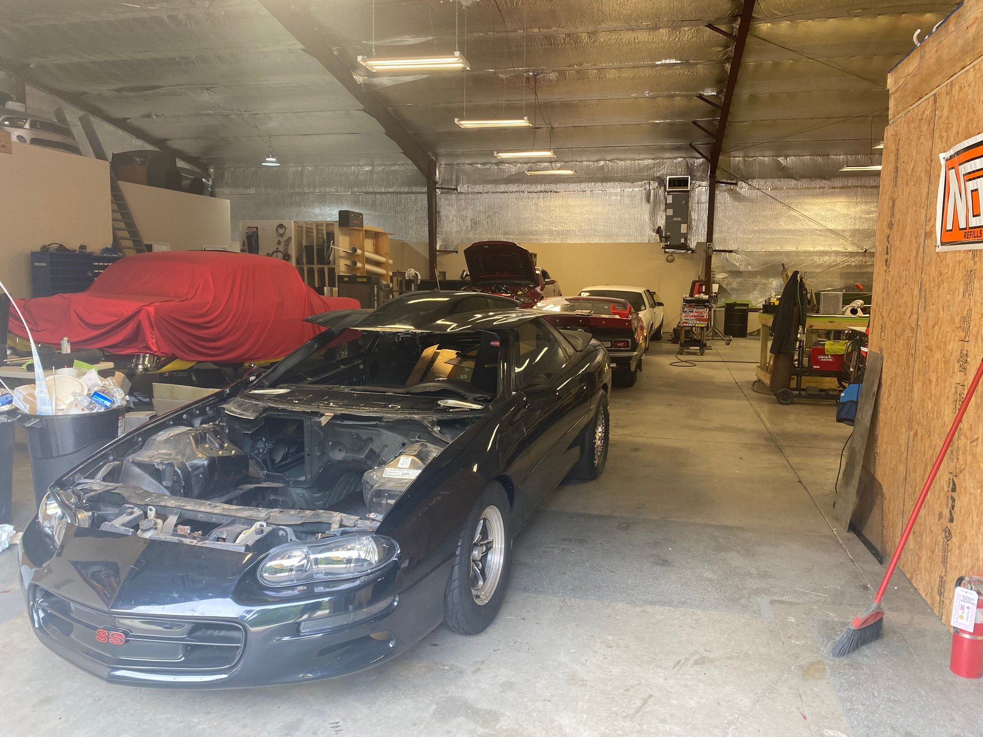

The car hasn’t see the light of day in months, got it dusted off and dropped off at the chassis shop so they can get to work on the cage.

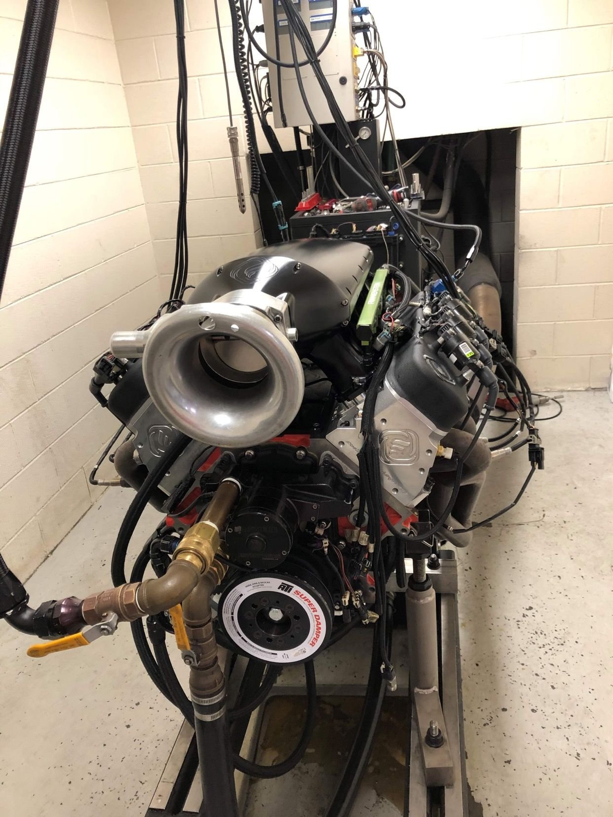

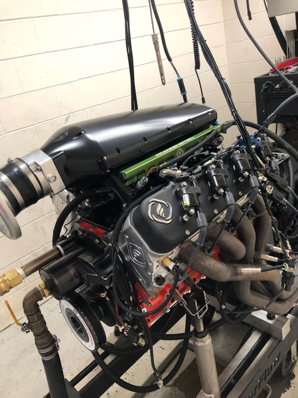

I got an email tonight from LME on the motor, pictures and video below. I did not receive any information on the pull in the video other than what you see. I’m hoping to get all the info in the morning as the numbers are well below what we were thinking. It seems like the cam peeked too early @7500 for being as big as it is, would have thought 8000+. I’m hoping that this was just a first run and that they need to start making adjustments.
