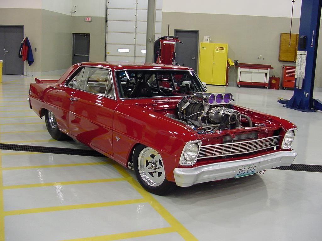

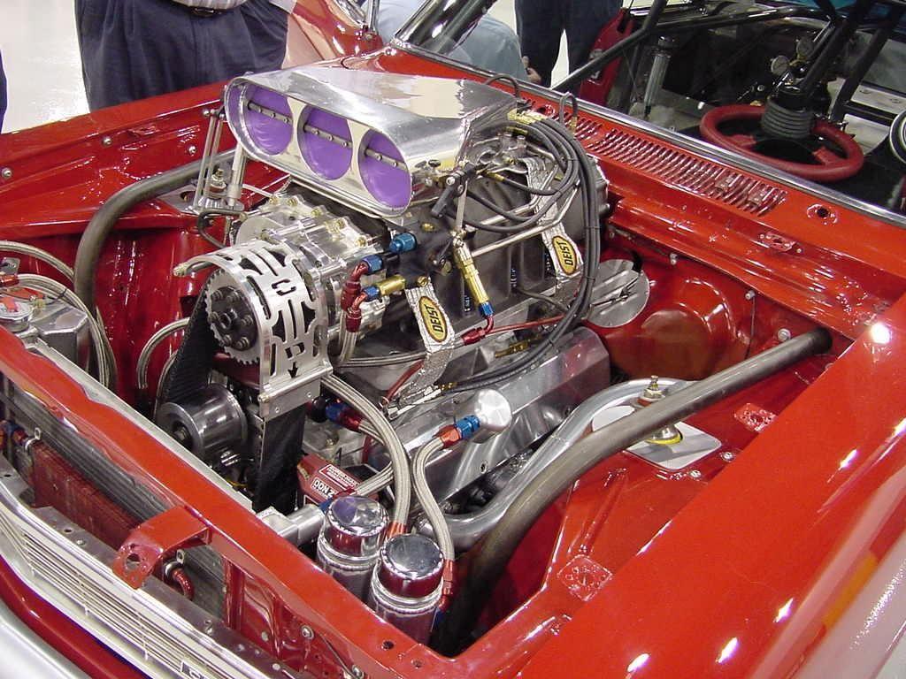

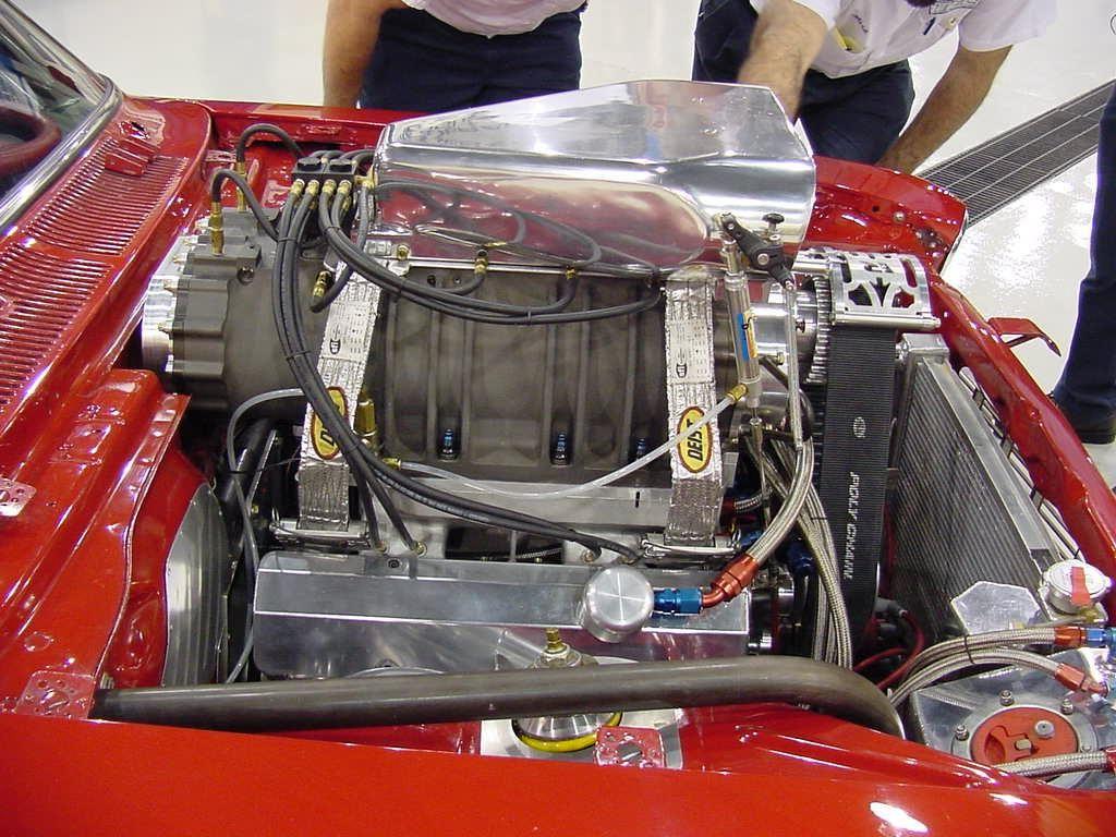

I ran Outlaw 10.5 in 1999 thru 2001 with a blown SBC on methanol. 400" w/ 14* Pro Action heads, 14-71 SSI hi-helix making 35# of boost. I used copper berrylium seats and coated Ti valves and did not have problems with corrosion. It is all about using the right parts or maintaining. Even then the bores looked like crap after awhile, etched and stained. As long as the rings seal it doesn't really matter. I ran many other methanol combos with roots blowers before that one. Most of time with Methanol fuels you use a top lube mixed in the fuel to help with lubricating the engine on the induction side. I preferred cotton candy fragrance. LOL
IMO, the seats used in the Frankenstein heads are nothing special and not suitable for E85 or other dry fuels. Going to need to upgrade. Stock OE LS head casting use seats that are more tolerable to dry fuels, of course since they support flex fuel. The proof is in the pictures I posted. Again, 8 pulls from BRAND NEW, less than a few weeks from running to tear down in a very moderate climate. Just sharing info.,,,

Damn, thats a nice nova!
