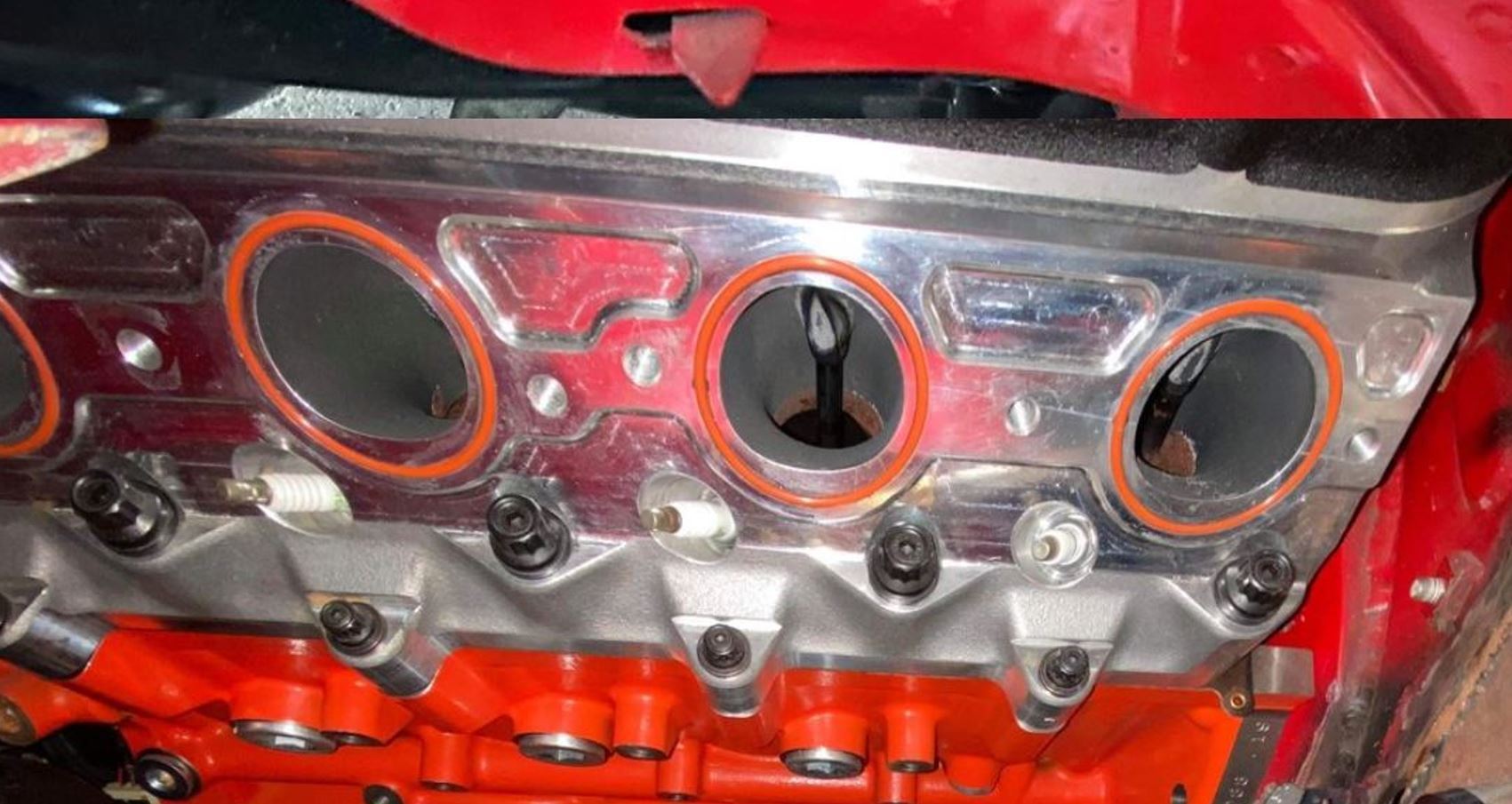

I'll try to post up a picture of the heads we pulled off that turbo car and post them up. They're even worse. Its really about the time lost. He missed a major race because of it. I'm sure the heads flow great, the car made plenty of power and we weren't even leaning on it. BUT all that but that does us no good if they're broke.

Here is the picture of the head. 14 degrees of timing, race fuel and 20lbs of boost.
Where is the issue here?
Look between the valves, aluminum is missing. The valve seats are moving around in the head.
(Not pictured) If you shine a flash light down the exhaust runner, you can see daylight around the valve. The valve seats are trashed.
Old Nov 23, 2021 | 11:30 AM
Damn, O.K. - daylight through the ports is not good!
What was the outcome?
They're out getting fixed and we bought some CID heads.
We are putting legitimate valve seats in the M311 heads and theyll be for sale. We cant keep having failures. If the valve seats are that cheap, what does that say about the rest of the head?
The material missing between the seats is a result of high heat in an area that doesn't have much material. Our F-Series now have interlocking seats to prevent this, though its hardly an issue. The seats moving around, which is more likely that the valve or valve seat angle of the seat is tuliping, could be a result of lots of things to include insufficient spring seat pressure or too heavy of a valvetrain for the application. (just one example). We haven't had any issues with seats moving around on F-Series heads or M311 heads for that matter.
Sorry to see you feel this way, though i'm sure the guys over at CID will take care of you.
Sorry to see you feel this way, though I'm sure the guys over at CID will take care of you.
Same story we got on the phone. Of course its not your fault..... These are a perfectly good Chinese head and valve seat combo. Sorry to see you feel this way? You weren't sorry when you took our money for these heads. Nor anyone else in this thread that has purchased FED products and are having / had issues.
  • Intake Valve Seats – Ductile Iron
  • Exhaust Valve Seats – Ductile Iron
^^^^^^^^^^ This was copied straight from FEDs website pertaining to the M311 heads. What brand valve seats are they? Be careful before you say CHE because we called CHE first thinking they were CHE and they told us that these valve seats are NOT CHE. A very well respected individual in the LS world told us that these valve seats came on the heads when they came from china. Care to dispute that? When we sent them to our machine shop to be fixed, the machinist used the words "dog ****" and "worse than factory" to describe the seats.
Casting outsourced overseas. Engineered, Machined and Assembled by FED in the USA. <<<<<< Right off the FED website. Yeah Yeah we missed it. Our mistake. Figured since it was on your website, you wouldn't mind me posting it here. Valve seats look familiar.....
https://www.alibaba.com/product-deta...c7c7370eTnfous
^^^^^^^ Look familiar too?
This is a quote from the Alibaba (China) website.
Features
1.T6-aluminum castings are T6-heat-treated, low-silica alloy. This makes them similar in strength to 6061-T6 billet and the capability to be machined and welded is also notable.
2.A raised runner design on both intake and exhaust ports is said to allow for more efficient cylinder filling, resulting in better high-rpm operation without sacrificing low- and midrange performance.
3.The exhaust-port exit is on center with the valve, which results in substantially better flow characteristics.
This is a quote from FED. Right off the website. F710 heads specifically.
A357 T6 Aluminum Castings – T6 heat treated, low silica alloy. Similar in strength, machine-ability and weld-ability to 6061-T6 billet.
Raised runner design on both intake and exhaust – Raised runner design allows for more efficient cylinder filling, better high-rpm operation without sacrificing low and mid-range performance.
Exhaust port exit is on center with valve – Substantially better flow characteristics.
Who is copying who here? Just a coincidence?
When we called FED and ordered them, we told FED what the application was, FED spec'd the heads and we even opted for the better inconel exhaust valve. Its not like we told FED that they were going on grandma's Camaro, we told FED it was a turbo car. Everything on this head was bought from FED and for the application as discussed on the phone. FED valve seats, FED valves (inconel exhaust and stainless intake), FED locators, PAC springs, all of it. So if its a valvetrain issue, its still an FED parts problem. Let me be clear here, we don't want anything more from FED. We learned our lesson, we moved on. I just wanted to let readers know and see what exactly is going on here. Every time there is a problem with an FED head, its not FED's fault, it's the customers fault. Then the answer is always "buy the F series head." Apparently when you buy the F series head, its still not their fault. Glad we didn't pull the trigger on that.
The heads made good power. Credit where credit is due. But again, that does us no good if they're broke after about 10 races.
