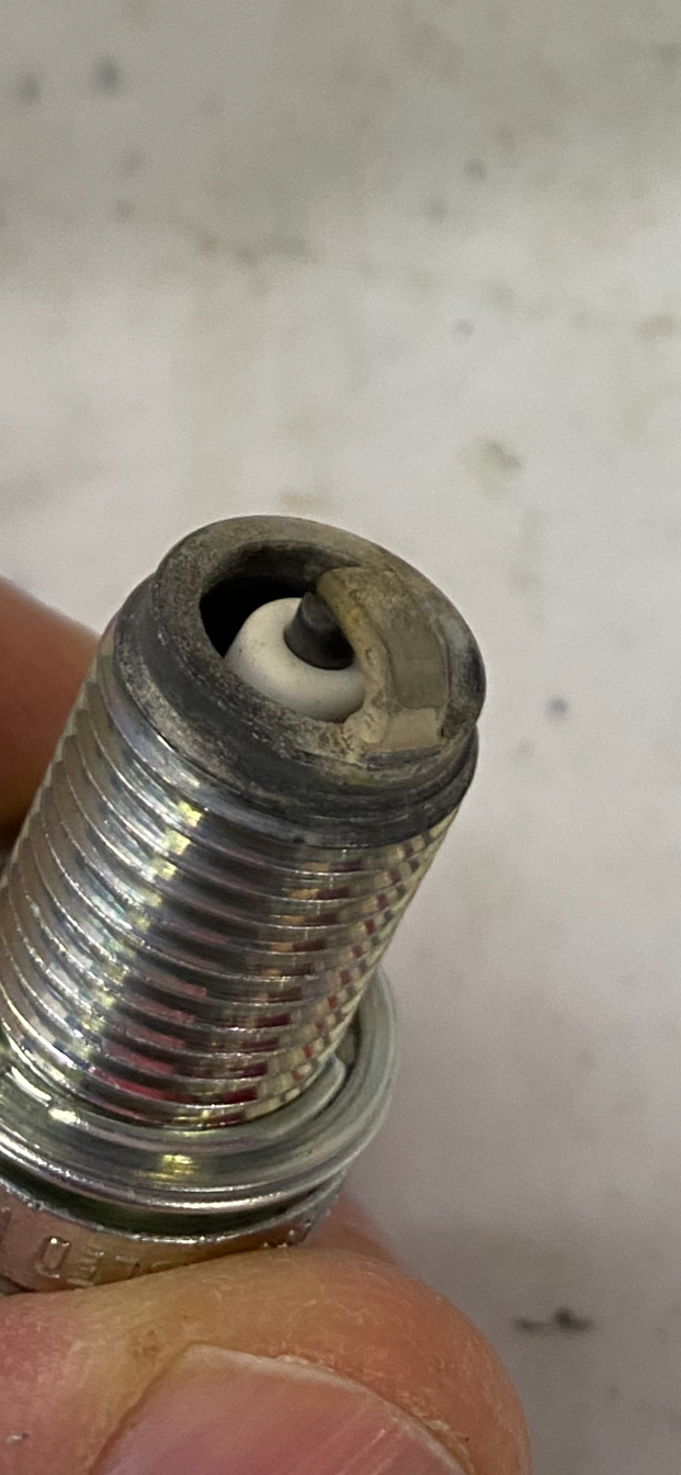

20 to 25 yielded no power increase, so I stopped there. Actually at 25 it lost a couple of inches of vacuum through the pull from rattling.
Plugs were happy at 20. I thought other wise so I experimented. No increase in HP or torque up to 25 degrees. It is a 10 degree head, alot of the BBC 9 and 11 degree heads act similar.
