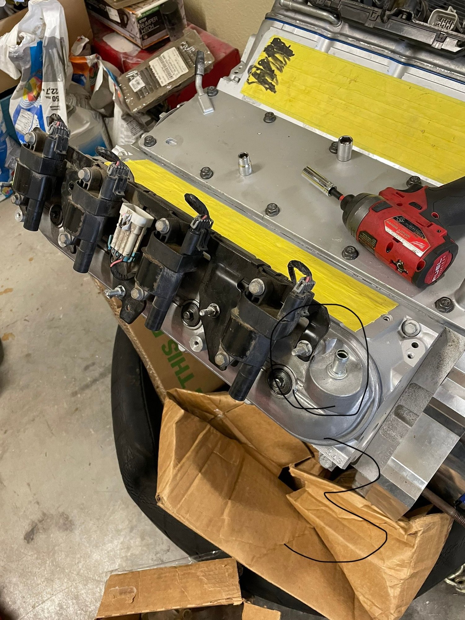

Hello, I have a ls3 6.2 link block that I purchased that has the DOD deleted. This is my first build ever. I’m confused about my valley cover and valve cover. My valley cover has 2 openings. 1 of which has threads (1) and the other looks like a rubber hose slips on to it (2). Each valve cover also has a port on it (3,4). So, my question is, are all of these vents? What is the purpose of these. I want to run a catch can for the pcv (from 2?)

Rear threads are for oil pressure sending units. Front is pcv goes to intake side.
Driver valve cover plugged. Passenger valve cover to throttle body
Catch can goes from valley cover port to can inlet. Outlet to manifold.

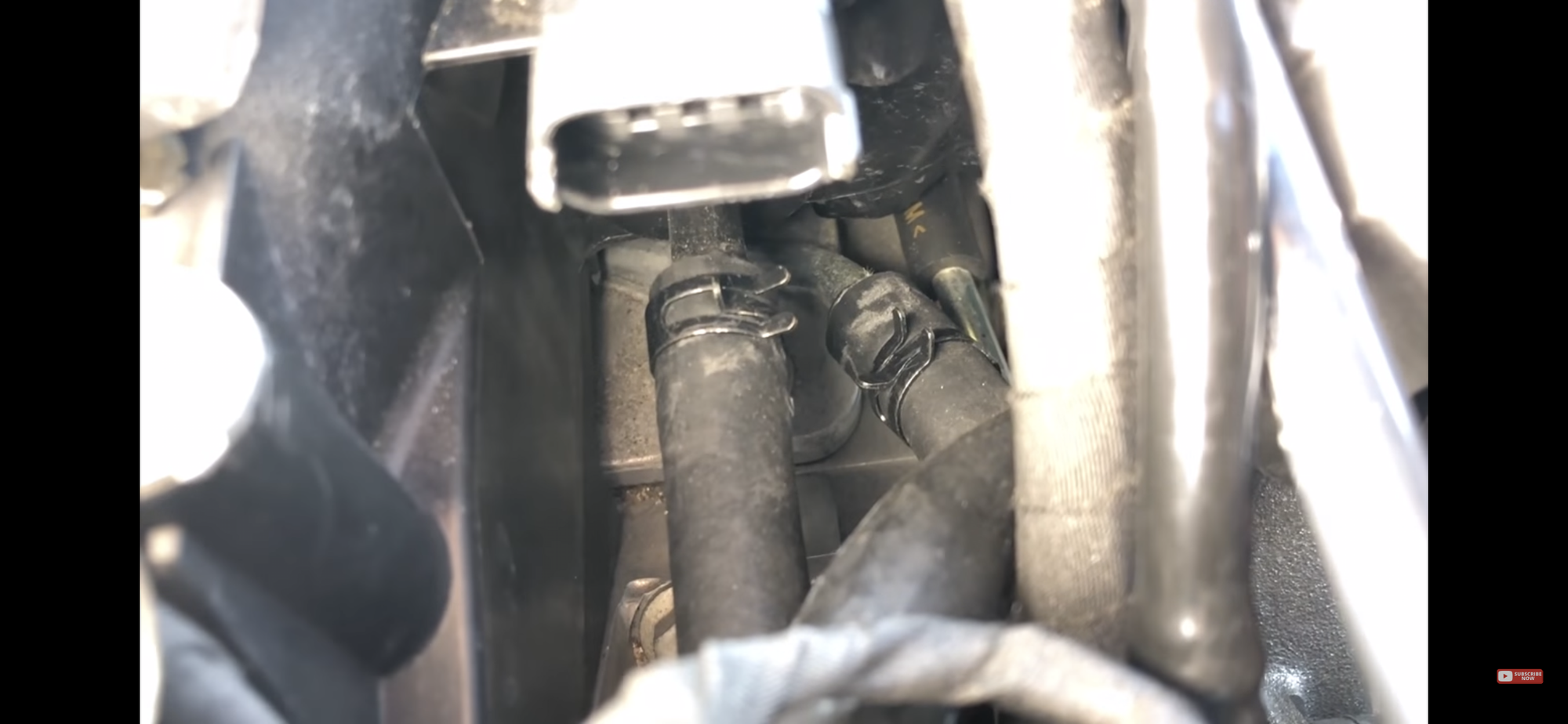

or, I saw a video (pictures below) where a gentlemen ran a line from the front of the valley cover to the catch can and then what looks like from the catch can to the intake. If I decide to go that route (if it works) could I also just vent instead of going to the intake? And at that point could I just cap off the valve covers? Or would it be recommended to have a catch can for the valve covers instead?

I don't think so as I don't feel you will be using large enough lines to ventilate the crankcase. From the valley cover into the sealed can like the red one in the picture and then back to the intake manifold is a common way to address the PCV system but you would not use a breather can for this or you'll be introducing unmetered air into the engine. If you chose to go that route you could cap off the valve covers and run a breather style oil fill cap. I think what it boils down to is whether or not you want to introduce the blowby going back into the intake manifold or not, hence PCV.
