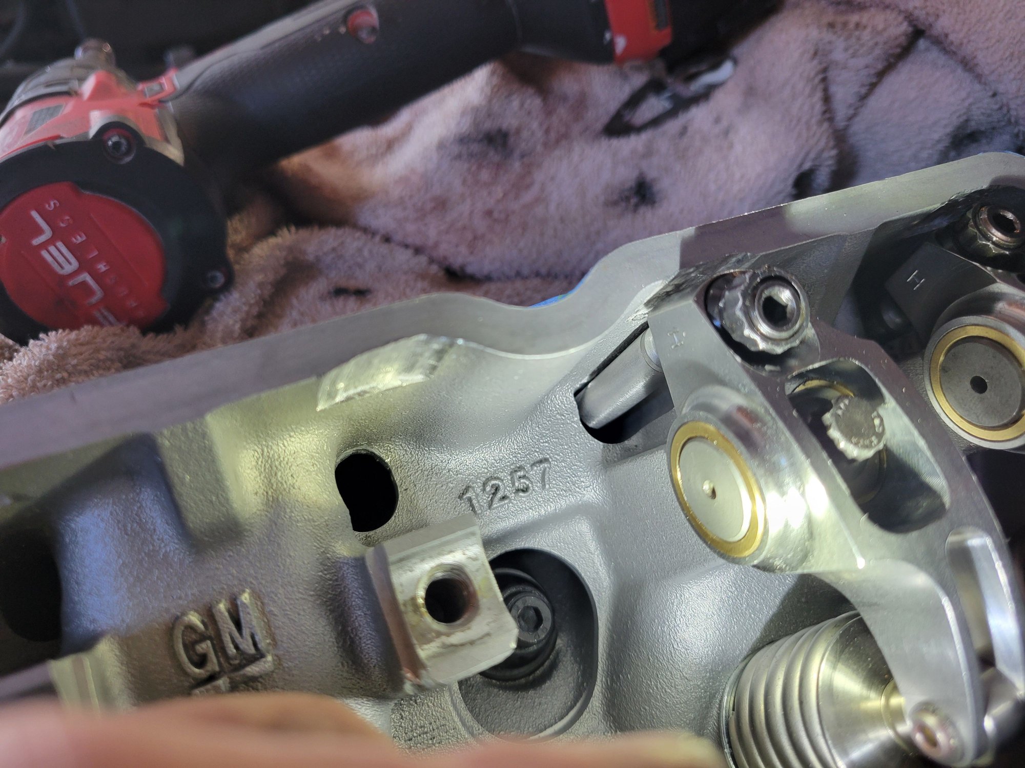

Had i known they needed this much clearancing, i probably would've done straight 3/8ths for the exhaust side and the tapered ones for the intake side. Luckily i decided to throw on some rockers to double check for clearance at the pedestals once i got the pushrods. I've been caught off guard by stuff like this before, so i knew to torque everything down and do a true test fit while stretching the head studs to save my self later. I would have the car together and running by now if it was all pure drop in stuff though lol. Perks of being ahead of schedule i guess.

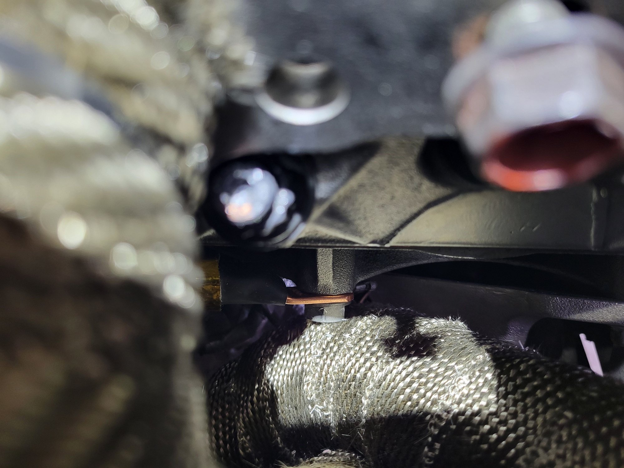

For those thinking of a quicktime bellhousing and use the 2in or larger ARH headers.. a good bit of clearancing is required to fit
And the passenger side header primary hits the ground lug on the block. Moved it to just above the starter. Likely due to larger power and ground wires.
And finally, 3/8 pushrod clearance in the heads. Tight but they all fit now

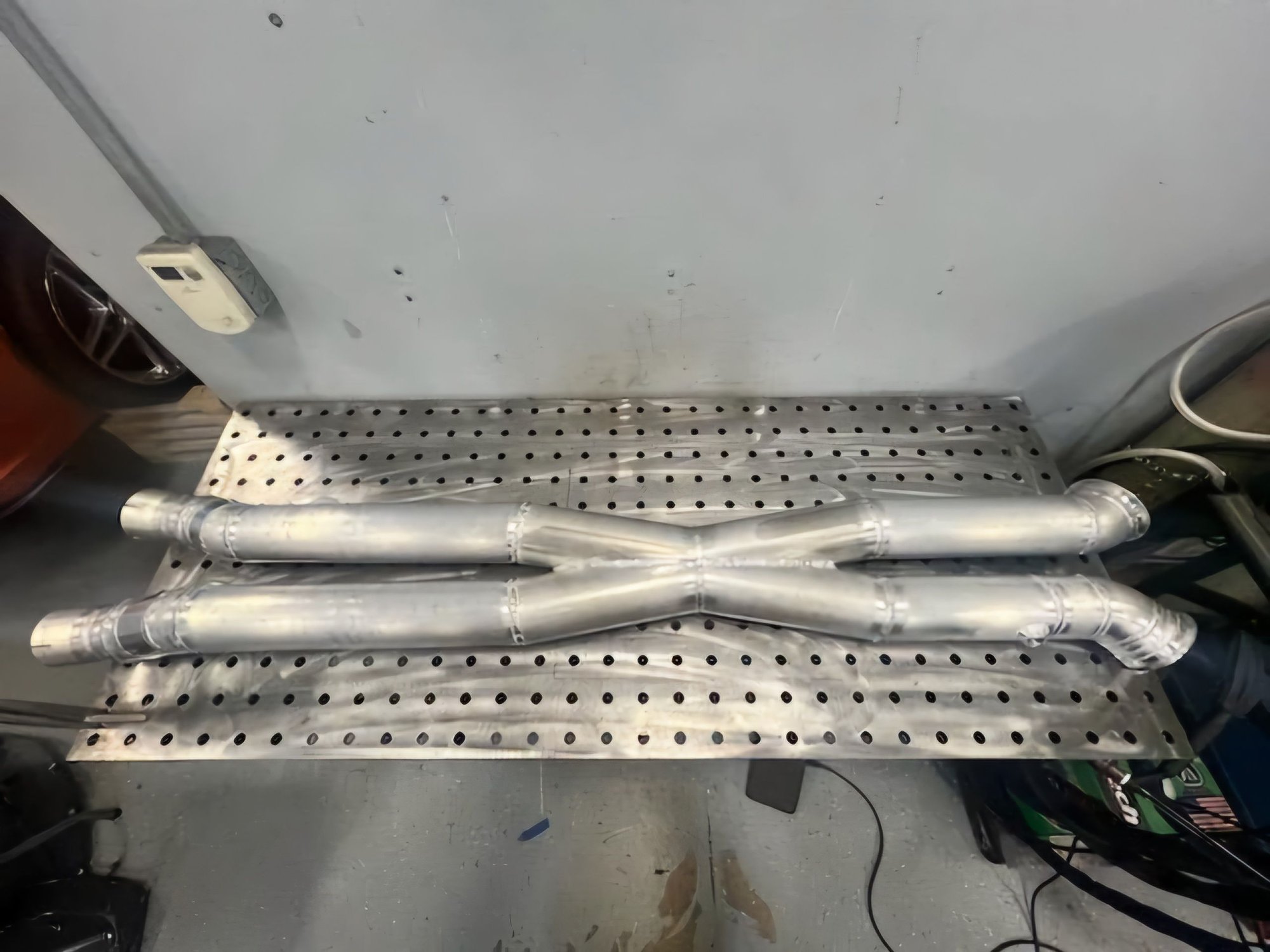

Dropped it off to get the 3.5in aluminum x pipe made. Made sure to tell him to get the merge as close as possible to the collectors. Tune scheduled for June 12th.
Don't care about the sound one bit, but i am curious to hear it with the larger aluminum mid section.

Bad news is that I got an expensive reminder of why I do EVERYTHING myself. I'm completely disappointed in how the 3.5in mid pipe was done. He didn't put the merge where I asked him, which was as close as possible to the collectors. It's directly in the middle. That is something I could live with though. The most disappointing part is how he decided to tie back in to the 3in corsa over the axle pipes. He legitimately just let them hang in whatever position they wanted and then built to that position without ever fitting or correctly mounting the mufflers. It hangs low for absolutely reason and is nearly touching the trans/diff. The over the axle pipes are hitting in a few places, which is completely unacceptable since those the mandrel bent corsa pipes.. they clear just fine if you mount them right.. Just really poorly done overall. I am 100% confident I could do far better but I was hoping to save time on what I thought would be quick and easy for someone with experience building them..
I kept my mouth shut and didn't feel like it was in my best interest to have him give it another go. He seemed pretty happy and excited about it, which sucks cus he's a super nice guy. But if this was his best effort, I either need to do it myself or take it somewhere else. Which I will do after the tuning is done

I really don't want to post it cus it hurts to look at. But he sent me this after i paid. Car was on the ground when I got there, which meant I couldn't look much over until I got home

At least it does look decent. Idk if the X placement really matters. The legs at the back shouldn't be too hard to fix.

Per the header wizard Calvin Elston, the closer to the collectors the better. Same goes for Y merges.
Old Jun 14, 2024 | 11:22 PM
  #100
jayyyw's Avatar
Joined: Dec 2017
Posts: 1,611
Likes: 1,086
Yeah, logically, it makes sense. But the header design will have much more influence on overall power than the placement of the X pipe. There might be a few HP difference moving it closer. Talking single digits.
