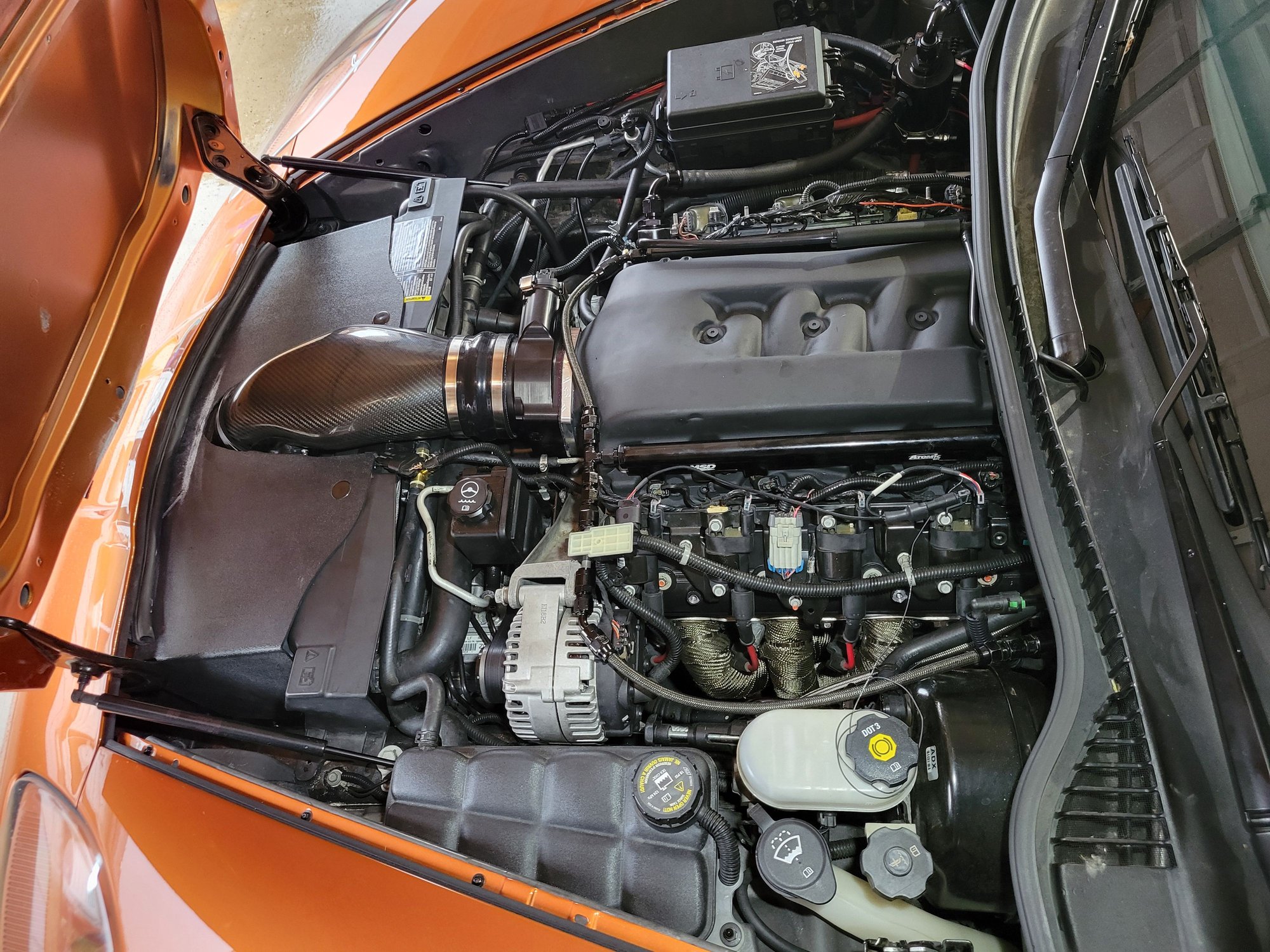

On a more positive note, I got the Halltech CF112 to fit with some trimming to the filter and upper radiator shroud. Pretty much done in the engine bay, just need to decide if I like the flex fuel sensor spot before trimming the excess wire. Have a feeling I'm gonna move it.. Hopefully tuning on Wednesday

I was looking at your PCV / Vent set up. I see a hose going from valve cover to catch can, another hose from catch can to intake manifold (I presume a PCV valve there or orifice) and another hose on the top going somewhere?
Driver side valve cover connects to T that goes to pass side vc and sump tank. Pass side also has large hose that goes to catch can. Smaller, second line from catch can goes to intake manifold, behind TB (the can has a valve on this line/fitting). There should also be a line going from the sump tank to before the TB, but i haven't hooked that back up yet, so it's just vented. The top hose of the catch can is just a vent, most people have a filter on here but i went with road race version that routes any potential spillage elsewhere. valley is capped.

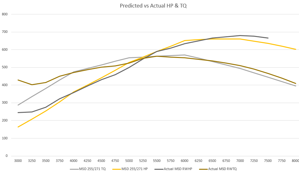

Solid power. Don't remember if you have a number goal with the setup.
With all the testing that I've seen with the Trinity, I don't think it'll make any more power than the MSD. Its definitely going to lose down low.
the number goal was to get as close to 700 as i could. early on, i wanted to be in the 660+ range with as much torque as i could get from about 4500-5000 on. Somehow, i think i got it all right.
The trinity will absolutely lose too much mid range and average power for me to end up keeping it. But i do want to see where it shakes out. The MSD exceeded my expectation in terms of the peak and how well it carries.
The car peaked at 98kpa and fell to 95kpa. there are a few things i can still do to try and solve that, but we'll see if it gets any better at speed first.. little power to be had there for sure.

What compression and fuel did you run?
Awesome results! Ironmask is leaving receipts he’s doing great work.
13:1. Fuel is e85. Its got full flex fuel though, content showed e71 on these runs. Did driveability work on 93 but no high rpm pulls.

Gotta say, i am impressed with how closely the predicted values lined up with the actual. I think the 3.5in collector and mid pipe is the reason for the stellar results up top as i know that wasn't part of the model.. thanks for the push there!

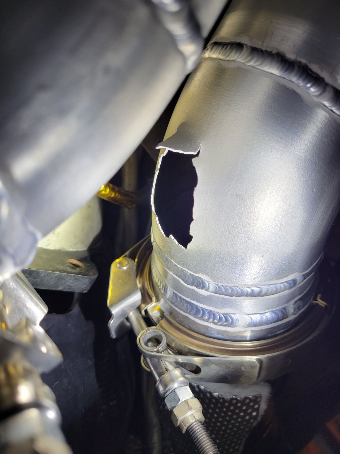

Been quite the journey over the last couple months with the car. I gave it back to the guy who did the exhaust so he could fix everywhere it was hitting. Took him 3 weeks and he fixed everything but one spot.. so I'm done with him going to the place I wanted to originally but couldn't get in to in the time frame I needed. Pay now pay later.. lesson learned. Should've done it all myself!!
The day I brought it home after exhaust attempt number 2, I was obviously giving the car the beans. It blew a hole right out the elbow after the collector on an absolutely violent no lift ****. We explicitly talked about upgaging material OR welding a plate/reinforcement at the elbows to prevent this. I made a plate and covered it up for now. New shop and I will handle it
