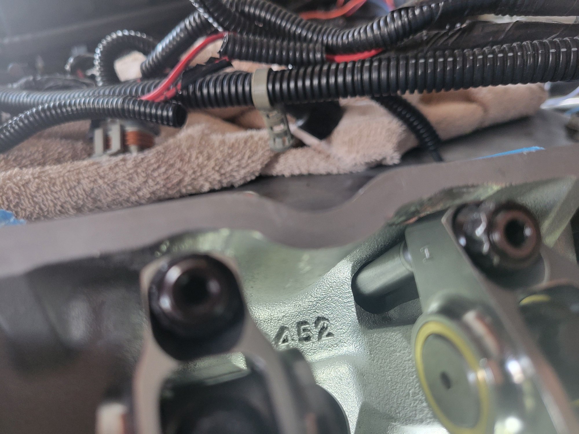

Intake pushrod holes need hogged out for the 3/8 rods to clear at max lift. A few were still really close, which was surprising. Another round of grinding coming up. Exhaust side has plenty of room after 2nd round of clearancing.
