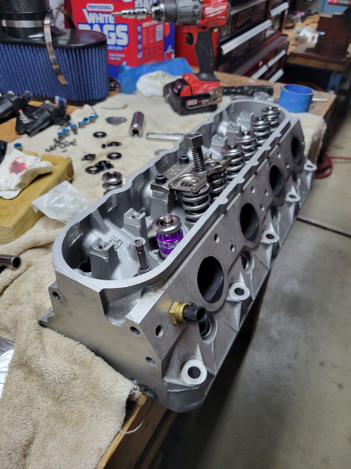

Heads are off. Liners looks fine, so that is a relief.

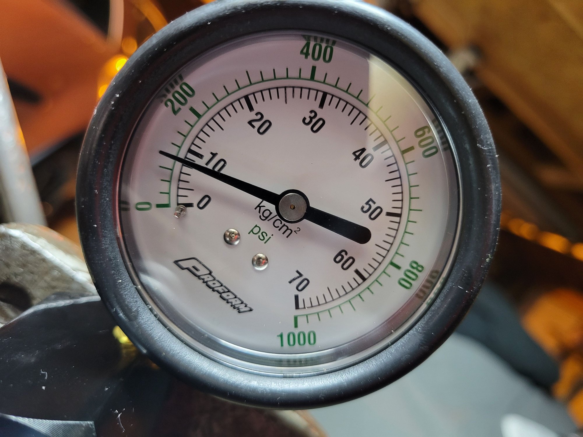

1209x's are off and i am just waiting sone 0.015" spring shims to get here for the 1238x's. the 1209x's showed 120lbs @ 1.800 on my tester, they are completely shot considering they should be 160 at that height. Crazy it happened that fast.

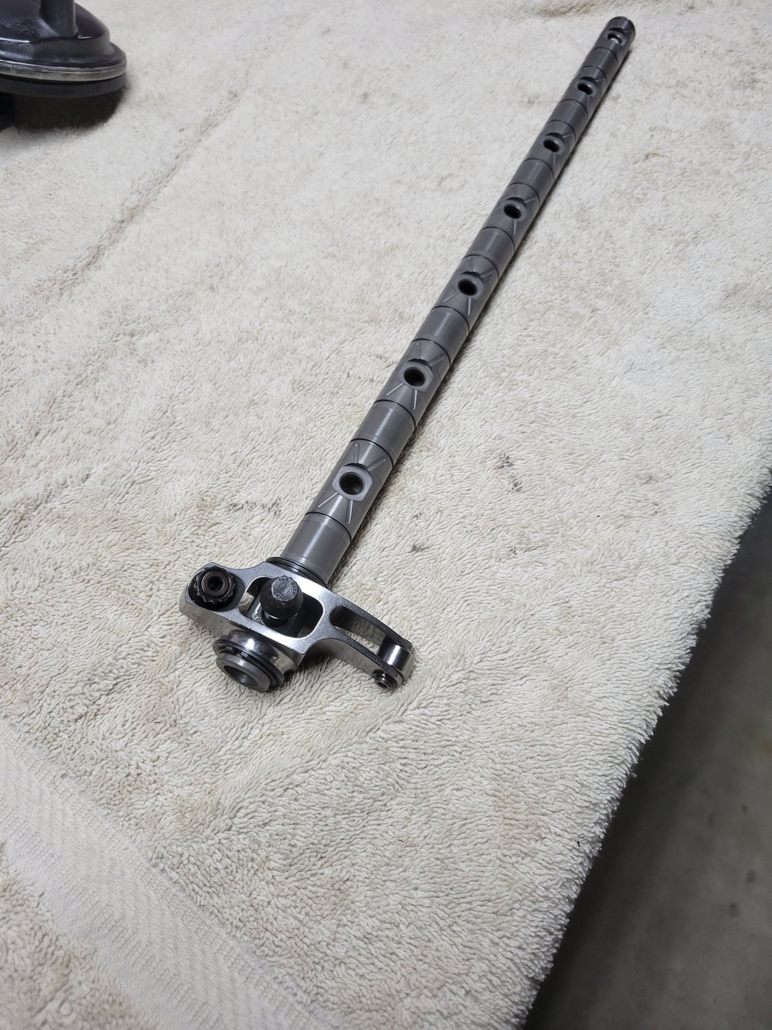

I pressed all of the Comp and T&D bushings out and got the Comp bushings pressed in the T&D's. Waiting some round machine shims to show up since the T&D's are narrower than the factory rocker. Just need to eat up some of the side to side play between the c clips.

T&D's are on the Comp BSR shaft. Time consuming with my vice but straightforward. Comp studs aren't here yet but i has ARP bolts so i didnt wait. Still felt bad for those threads tightening down the shaft with all that spring pressure..

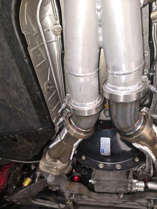

Weather not looking good for tomorrow so no track. We'll try again next weekend. Until then, fixed the x pipe. SS elbows and aluminum back. Fab guy was begging me to drop the headers so we didn't have to double up v bands but dropping the headers is a royal pain in the *** imo. It's dumped for now and ungodly obnoxious. We'll tie the mufflers back in over winter, this was a bandaid to get me to the track.
Side note, new guy is fantastic but I'm buying a welder and doing this **** myself from now on.

Is that a 3 or 3.5 inch X Pipe?
