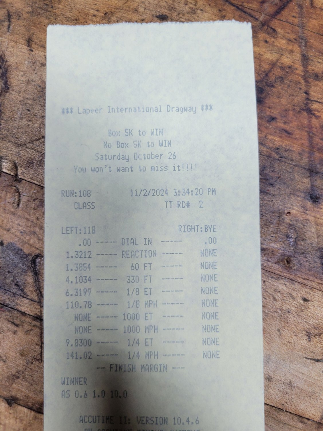

Didn't hit my goals. But we ever so slightly improved and I drove it on the trailer running. Cracking into the 1.3 60fts has me excited for next year because the switch to these mickey pro bracket radials made it WAY too easy. It did it with almost 1000 less launch rpm compared to the slicks!

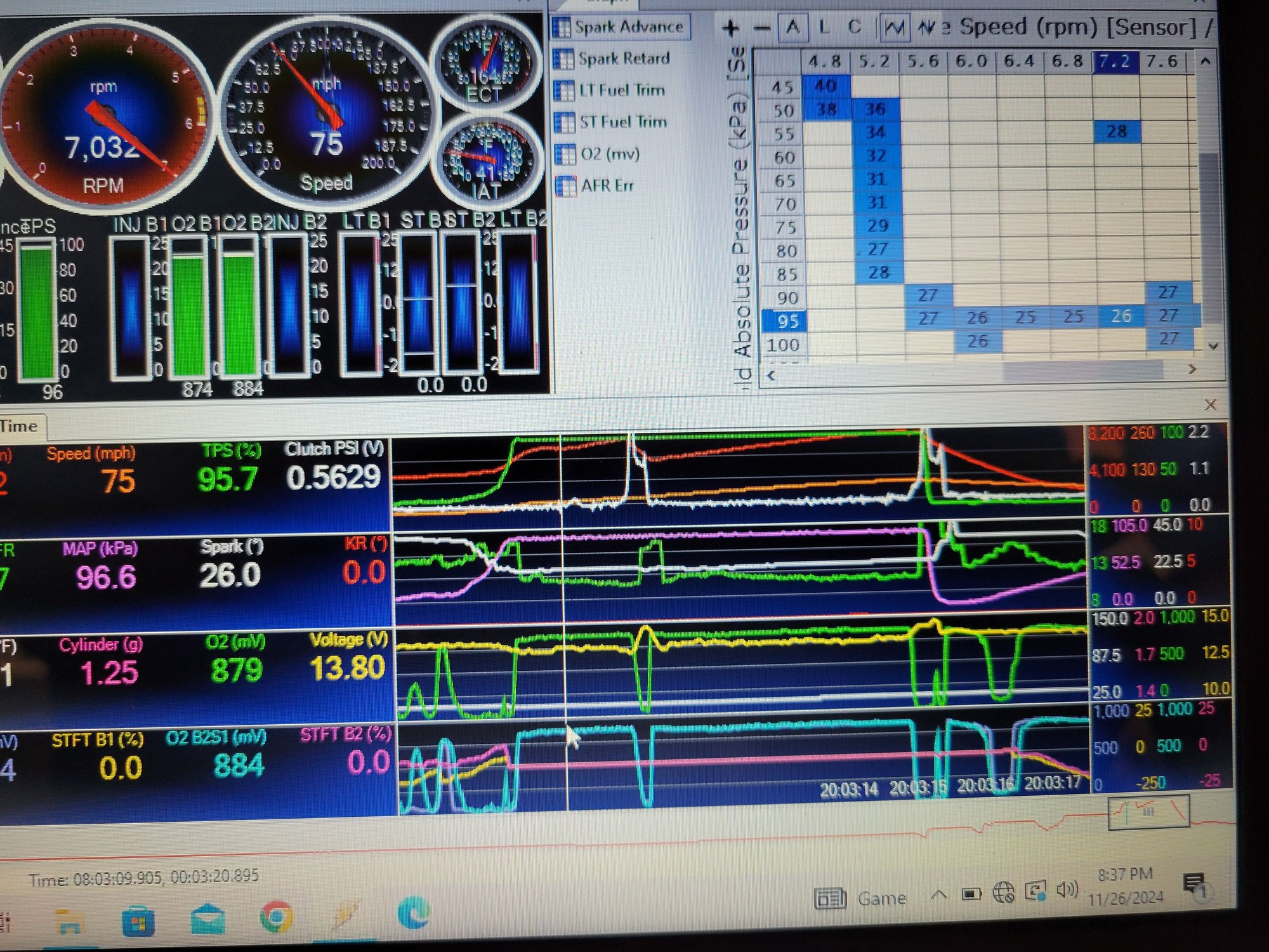

But I am completely surprised that the car didn't pick up more mph, or really any with the switch back to a radial. It consistently went 141-142 all day though and every pass was a 9sec pass. I had to baby the 1-2 shift all day too, logs were showing .5-.6 sec shift time on that one, and i've hit that at .3 pretty regularly. No biggie. I'll take care of it but couldn't take advantage of the quicker 60s.
Car was also MUCH richer on the top end compared to last outing and airflow appeared to be significantly less in the logs. The DA was nothing special at +350ish during my best. I just go back to the log from the 60-130 above.. nothing has come close to the night it made that pull when i compare logs. Car was rolling with that air. Some investigation to do but nothing obvious.
Velocity stack and some weight reduction for next year. Can't complain about a strong ending to the year!

1.38.... incredible! I am going to be that guy... what is your launch ritual or suspension settings that you think are helping? Also surprised between the air density, radial tires, etc that the mph is not up more. The shift time could be killing all of your gain but just speculating. Still awesome considering everything! Congrats!

Aside from the standard answer of seat time, treat your clutch like the most hated thing in your life. Slip the ever living **** out of it and slip it some more. Also, my secret is that I race barefoot. Can't feel **** with shoes on, always been that way since high school lol.
Suspension is totally stock other than the AMT mounts which have been a godsend in killing all the drivetrain movements.
I'm convinced i have an airflow issue going on somewhere that i haven't pinpointed. I'm going to figure it out but the fuel data varying that much is telling of airflow being pissed off or disturbed somewhere. I've got some ideas but won't know until spring, unfortunately.

Better 60ft plus the longer shifts explain most of the reason there wasn't much or any MPH gain. Assuming DA was worse too?

DA was much better but water grains were similar. I haven't really been able to pinpoint why the car varies between 110-112 to the 8th or why it goes faster et/mph wise to the 8th and slows down up top. My 2,3 shifts are very consistent. My most recent pass was the fastest 60 (1.38 vs 1.44) and 1/8 ( 6.32 vs 6.331) and it didnt translate to really anything up top (0.005). The slower 1-2 kind of explains the 8th mile part, but only gaining .005 et up top points to something else, and all i can see so far is that i was shifting later by a few hundred rpm. No timing issues.
The only thing I have found that seemed to show difference with the 142 passes was shifting earlier in every gear, especially on the 1-2. Which is kind of surprising but now that i am lashing it correctly and i moved the merge in the mid pipe closer to the header collectors, i think it picked more mid range than what i dyno'd with and is starving up top more, because i have had to re-shape that middle part of the VE table the most. It was pretty lean in the 6000-7000 range compared to original file.
It's a long winded answer, but i want to fix the intake vacuum with the velocity stack first. Gotta hold 100kpa through the entire rpm range, then i will figure out where it actually wants shifted when it's getting the amount of air it needs.

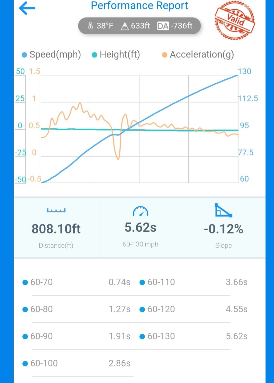

Best 60-130 I could muster this year. Couldn't get it to dead hook at the cold temps, but this was the run that spun the least. Confident it had 5.5's in it but sadly nothing official. 2nd and 3rd gear pull on the 28s pulling to 8k.
