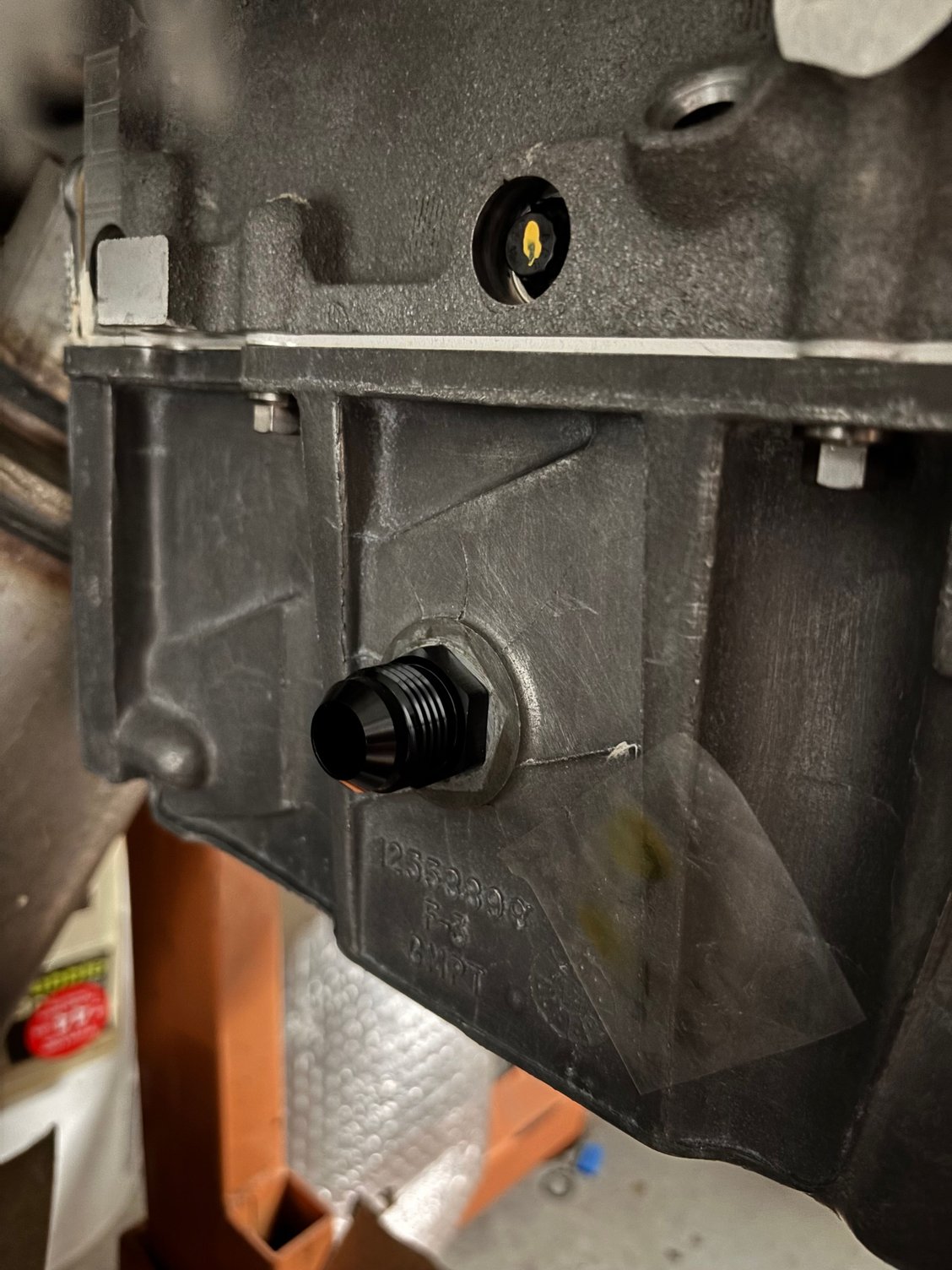

Probably just another catch can for the driver side. I still go back and forth on adding a vac pump, even if just for the track.
Hitmaster install is very straight forward. Already plumbed it in, just need to fine tune the engagement point when it's on the ground.
I wouldn't do it just for track. But then again, if you're gonna change the fuel for the track, then the tune is gonna change anyway.
Yeah I mean throwing the belt on is no biggie. I am more fighting if it's worth any hp for the money. I'd hate to spend a grand or more on it and get absolutely nothing but more work from it. Maybe i can borrow yours when you decide to pull your car apart again??

A vacuum pump has benefits, but only if you can get it to not throw up oil after every drive/hit. Ultimately, I ended up just plumbing the outlet back into the dry sump tank and then venting the tank to a catch can. I pretty much did oil changes frequently, so I wasn't really worried about anything happening to the oil/motor.
The only before and after data I got was when I put the pump on my first Z06. It lost ~6hp on the dyno (not same day) but felt WAY stronger on the street. Opposite to Mike, we had to pull fuel out of the tune for the vacuum pump. Engine was able to rev easier, so less load on the engine. Saw HUGE gains on nitrous. Same shot picked up ~60hp.
If you are trying to get every ounce of performance out of the car, a vacuum pump is a no brainer.
After seeing you and a few others saying they were prone to filling cans on the street, I figured the only way to do it reasonably was to drain back to the tank and do frequent oil changes, which i already do. but that is also what made think the header evac kit would keep things simple and still be effective.
You routed pump outlet back to the fill cap? and what i haven't spent much time on is the 2 other connections at the dry sump tank. Cap the oem valve cover connections and the rear-most tank connection on the tank? Run the forward sump tank connection to a catch can? I know we shouldn't cap the tank vent, just haven't figured out where that should go when a vac pump is involved.
( and for the other comments, the car is still SBE)
You guys are making me consider spending money again!!
Yeah, I routed it back to the fill cap. I bought a 12an oil cap. You do have to cut the hood in that area for the fitting, just be aware. I ran both connections off the top of the tank to a vented catch can. Make sure the motor is sealed up well, so yes, cap any connections that don't go to the vacuum pump.
