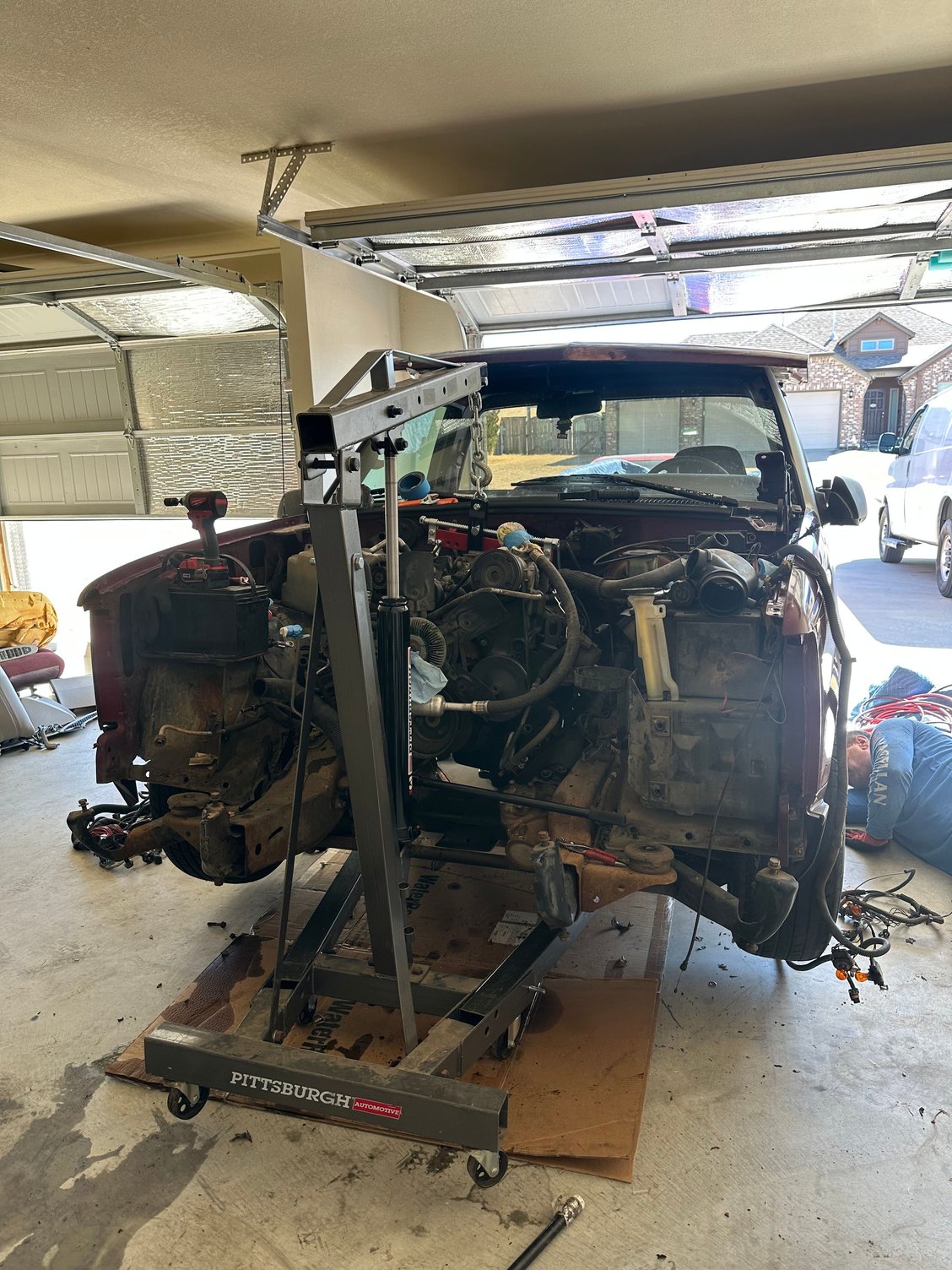

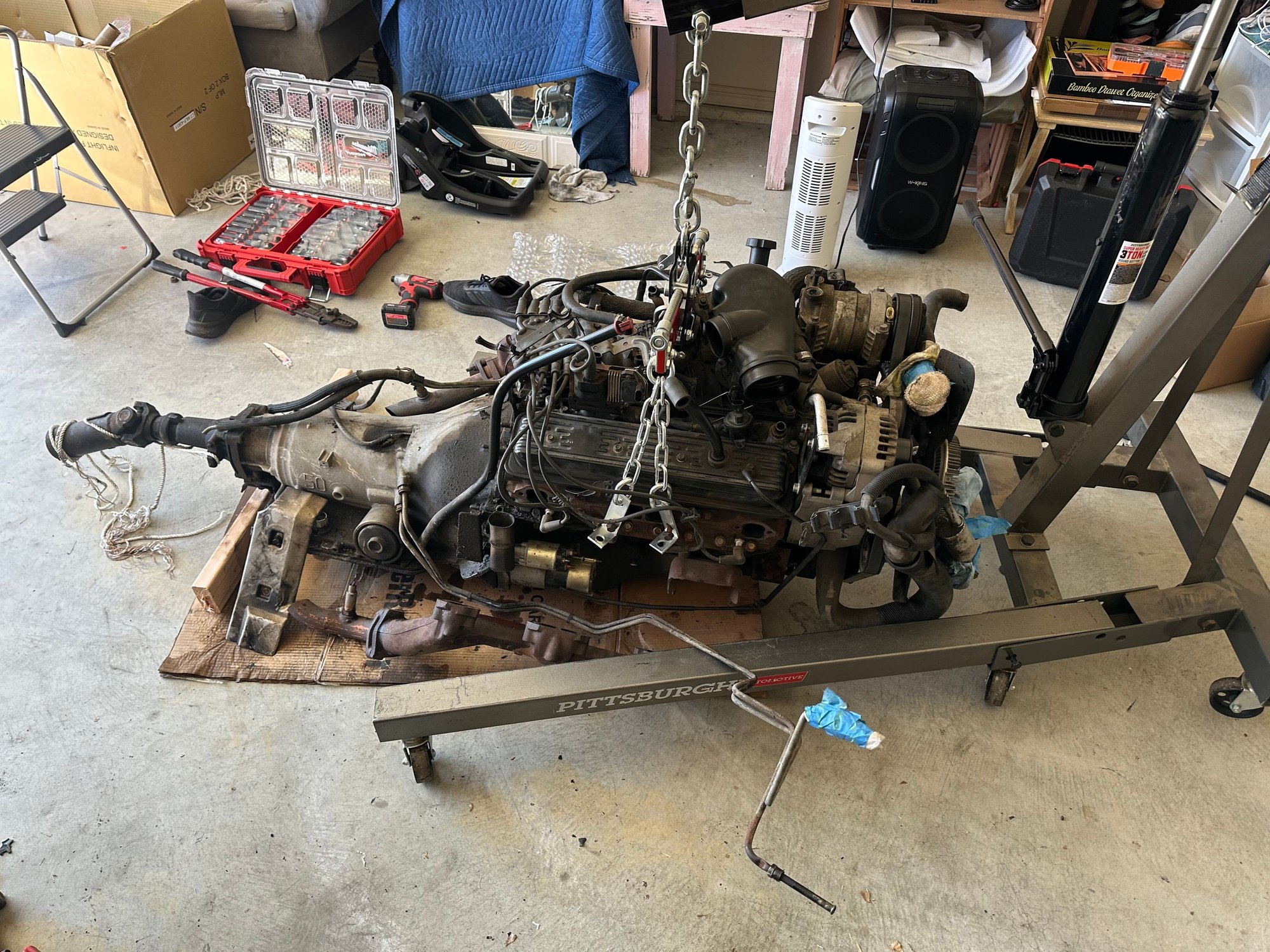

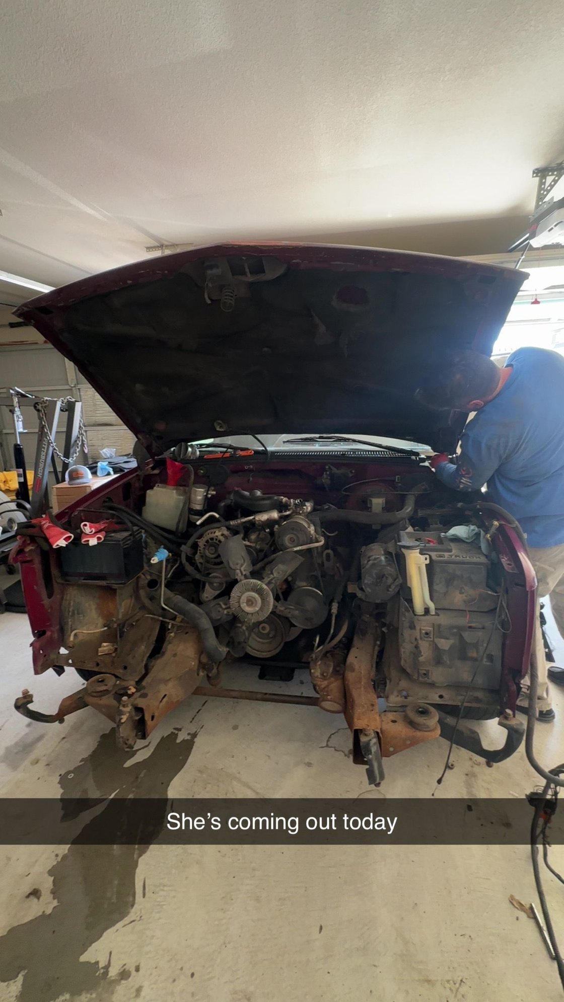

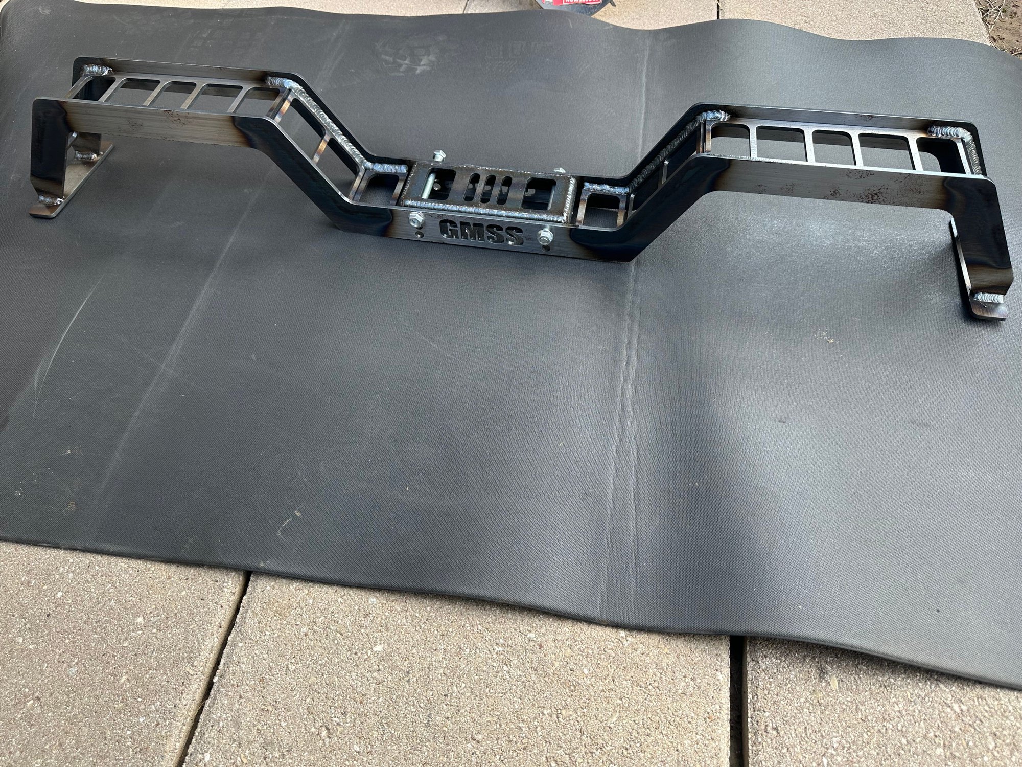

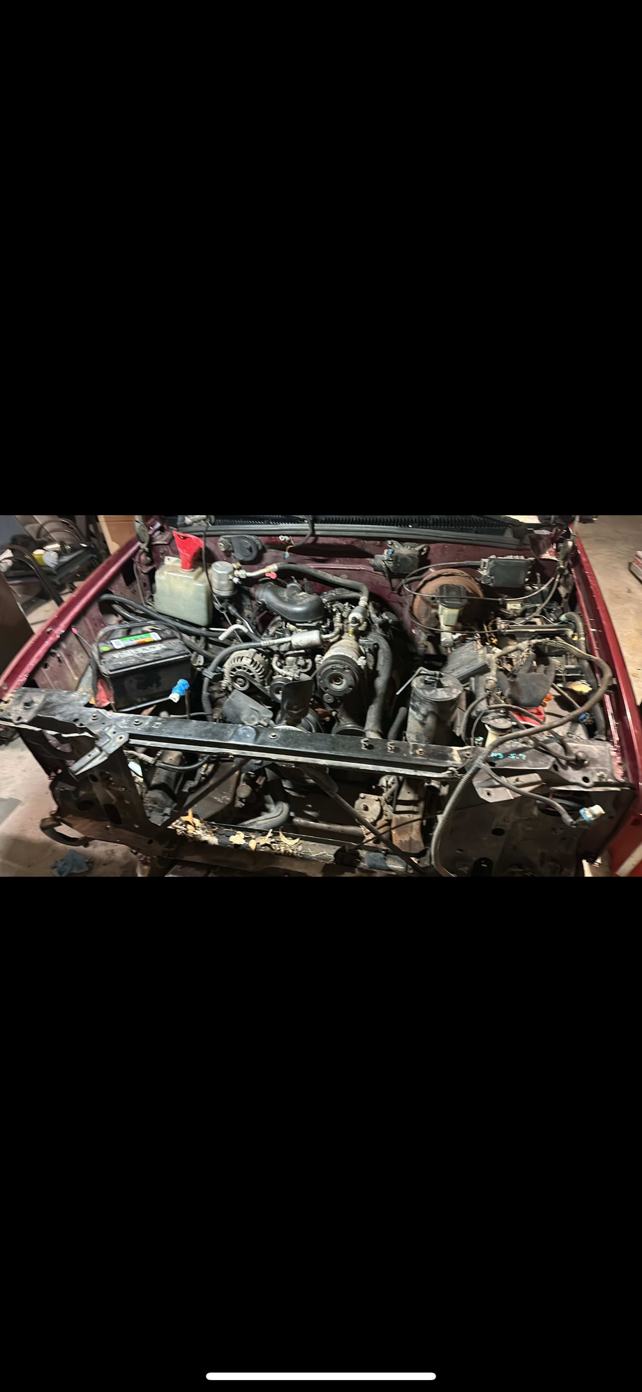

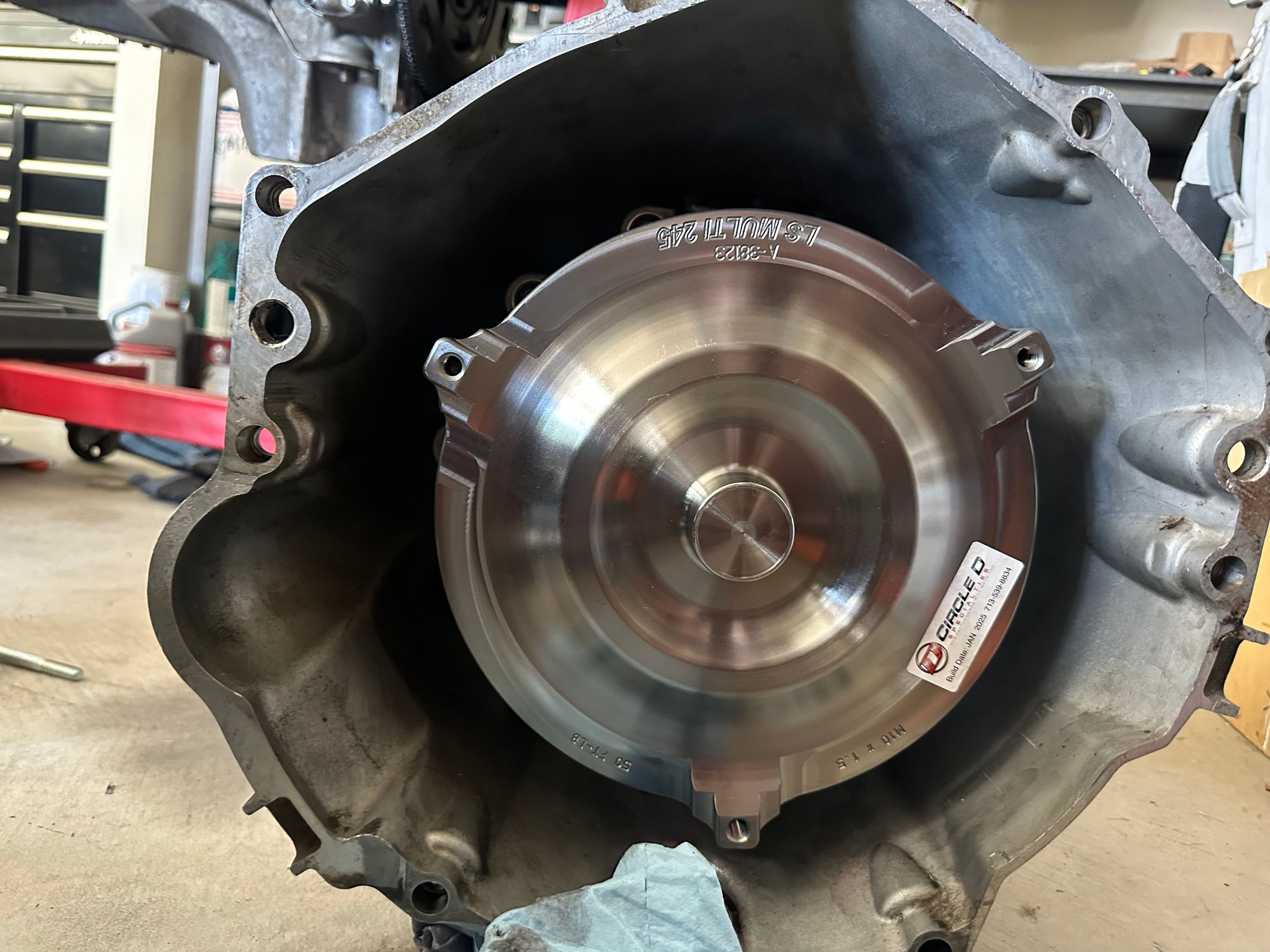

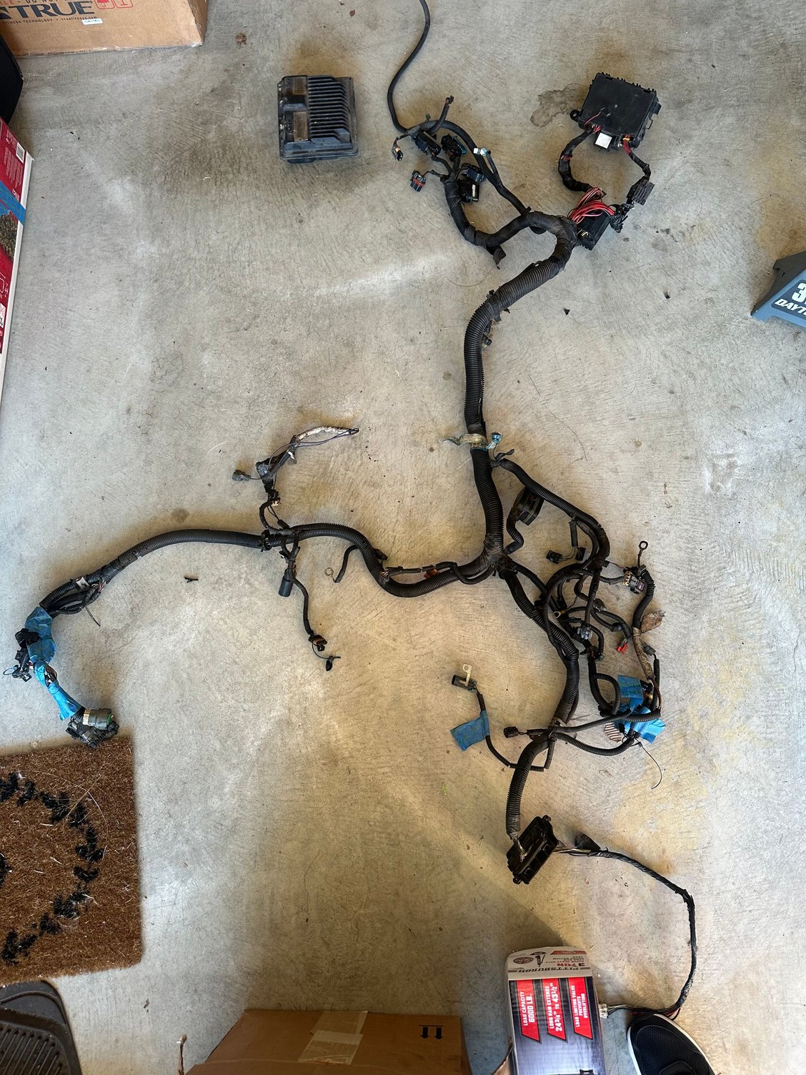

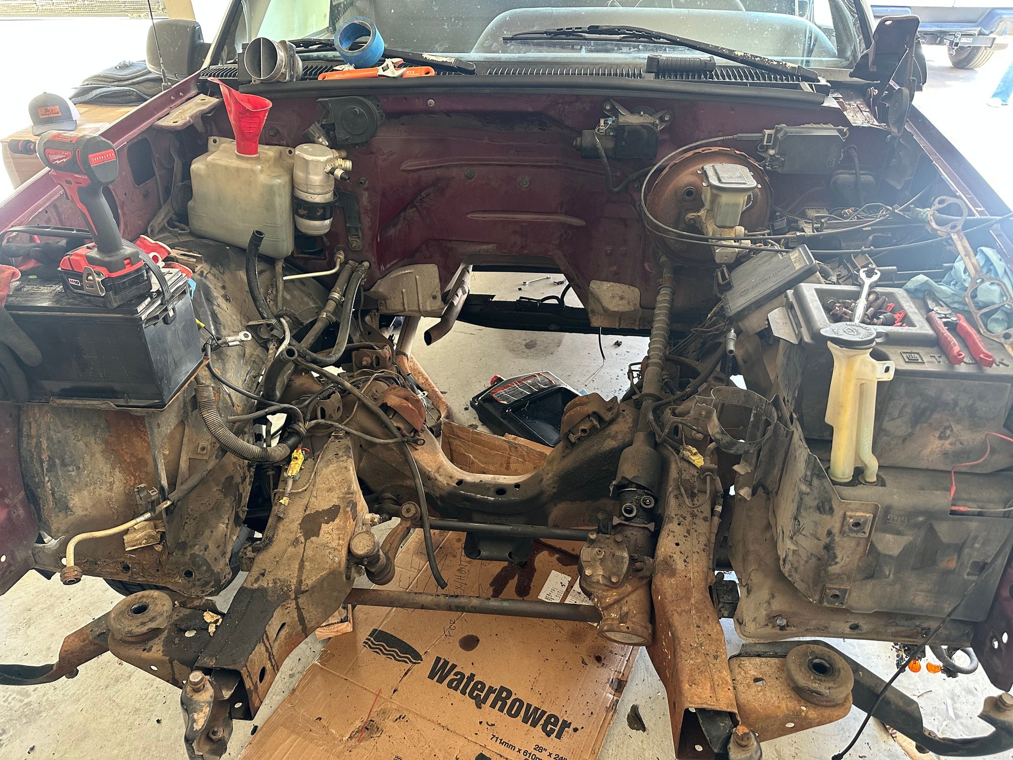

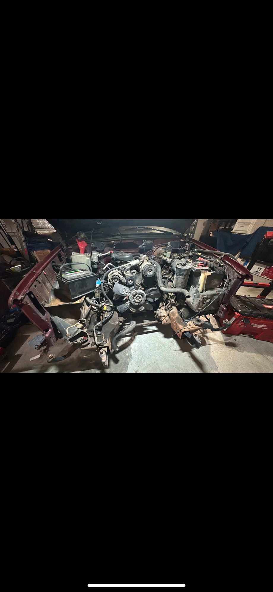

I went ahead and dropped off ATI from machine shop and waiting to get a phone call back. In the meantime, progress has been steady!
Engine harness is now completely out of the truck. After that, I tackled removing the front end. Not only for ease of access but I have an entire new front clip to go on the truck that is in way nicer condition that mine currently.
Tonight I finished with removal of core support and now I’m working on minuscule items. Draining fluids is on the list now. Power steering, engine, transmission. From there, its pretty much go time on hooking up the cherry picker and removing this 5.7/60e combo!
Planning ahead here but engine bay and frame needs a good bath. I’m going to look at getting truck to car wash for a very extensive power wash. I plan to paint the firewall black also. I am leaning towards white on exterior color so I don’t want to regret leaving the firewall maroon when I had everything out of it.
As I was grunting to remove the core support I heard the UPS man drop off some goodies. Hello 6FPX!
I’m posting this here for motivation and a timeline over my head. But, I believe at this rate I will pull motor/trans within the next week or so. I’m only tinkering on it for 1-3 hrs at a time. Probably won’t be able to wrench on it again until this weekend.
Anyways. Here’s some boring pictures!

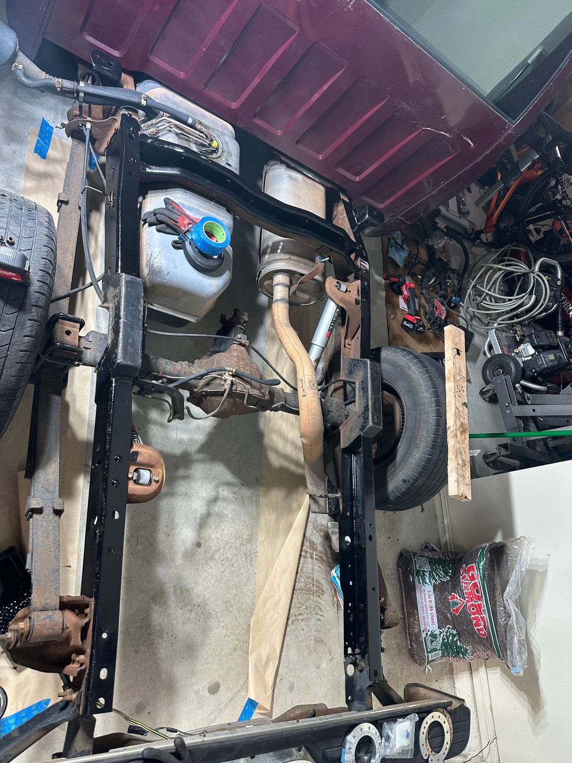

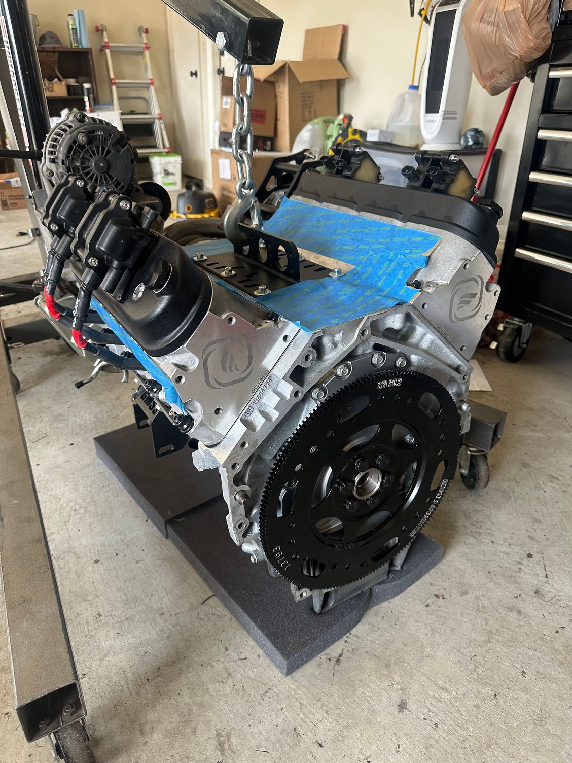

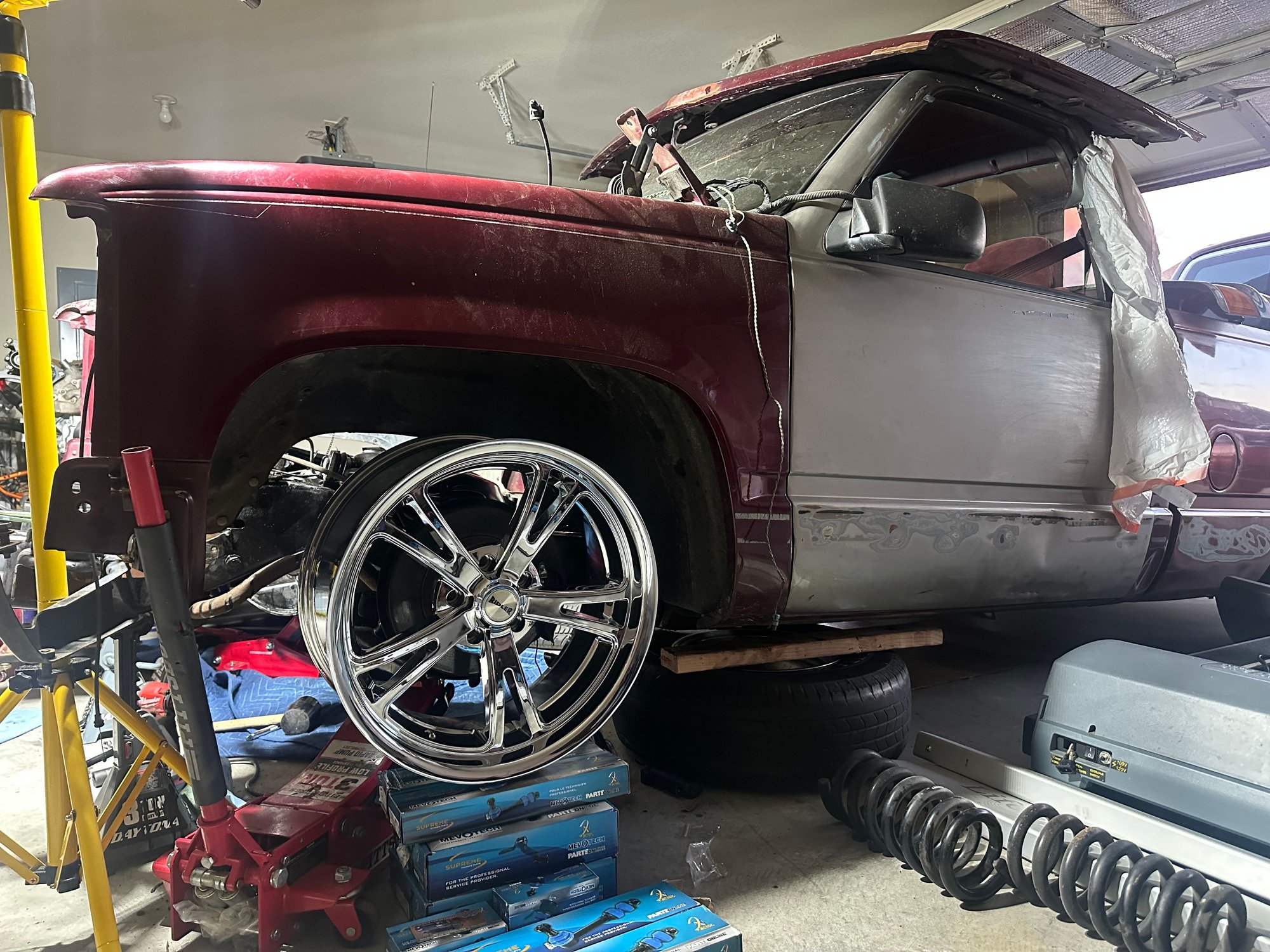

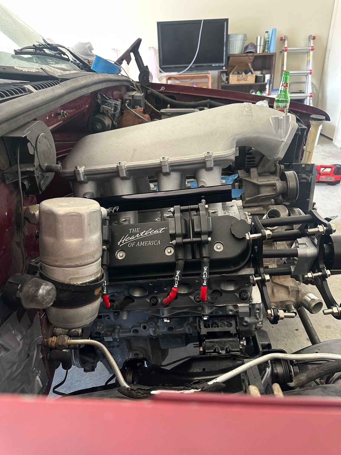

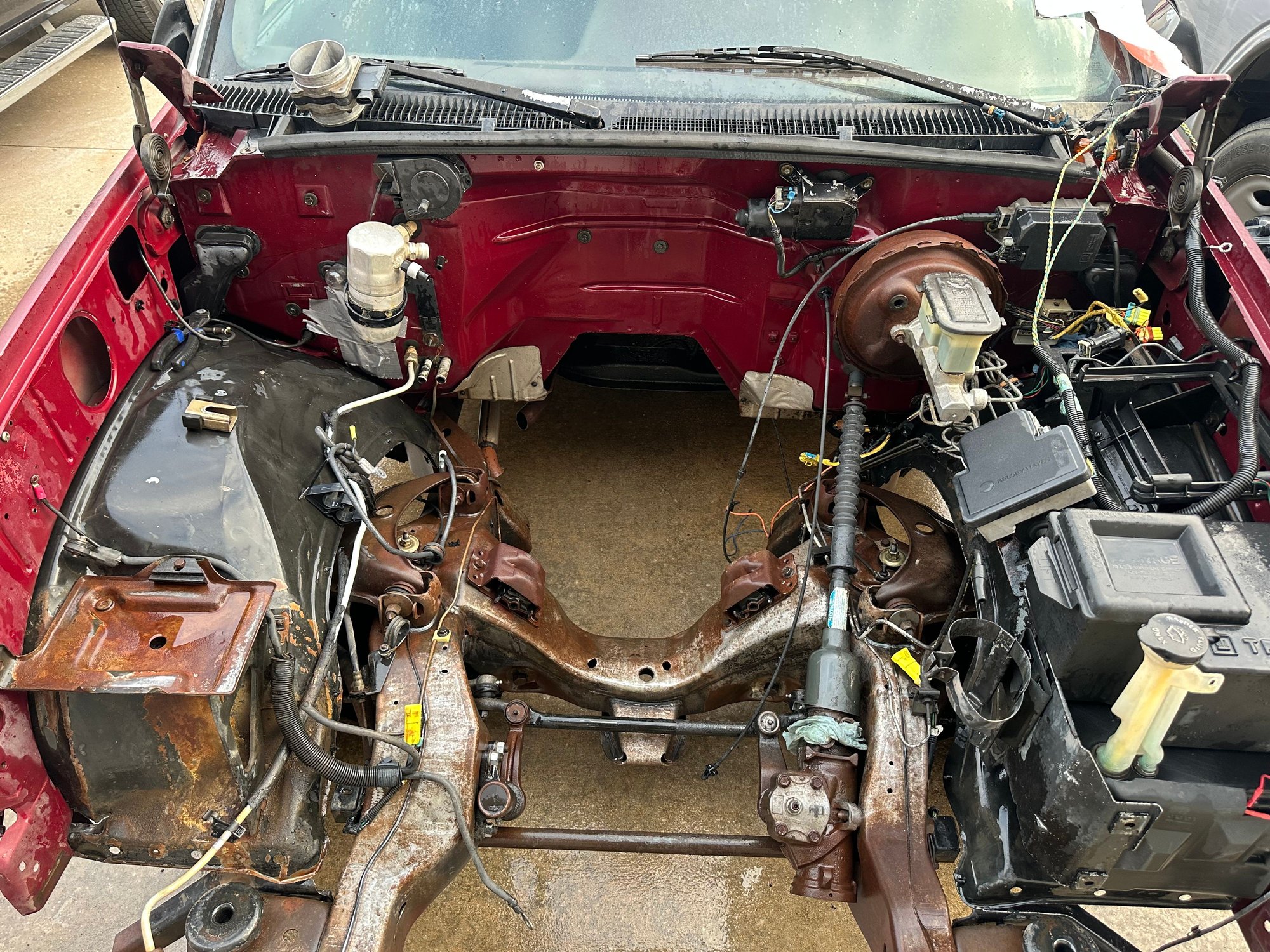

Update:

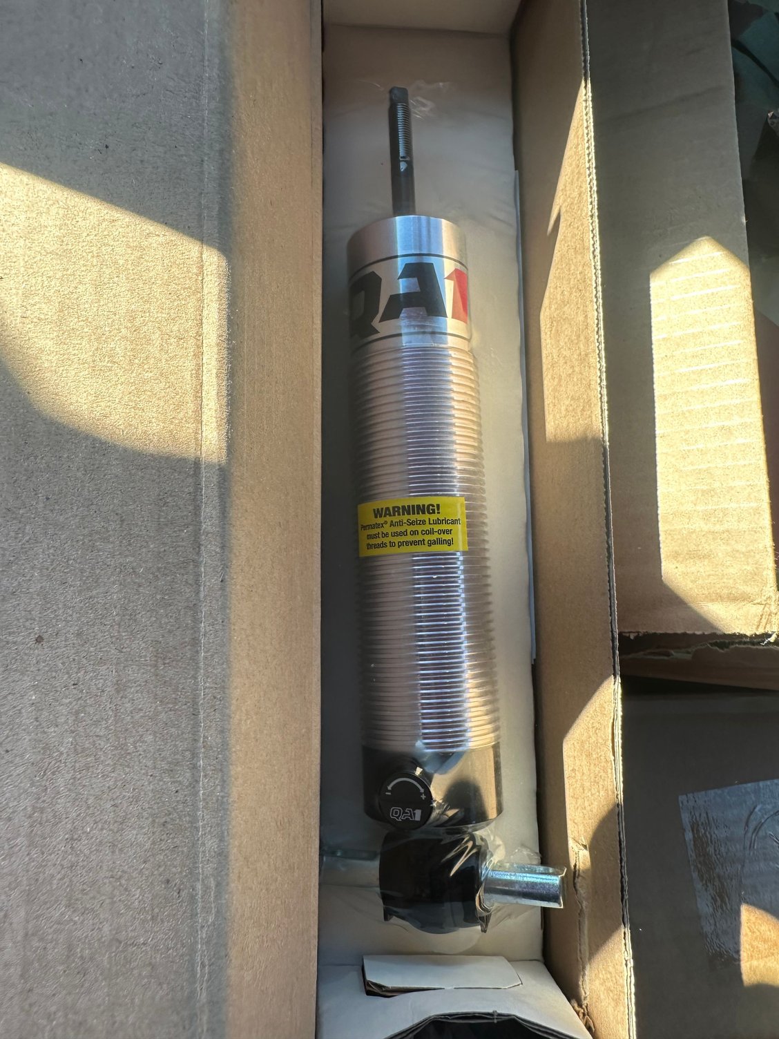

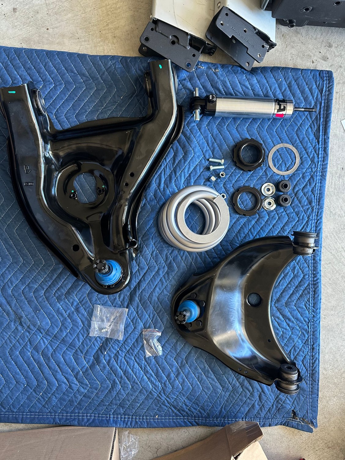

I’m still chipping away at the build. Work has kicked my butt lately so my weekend time of working on the truck has been slim. BUT, I finally rolled it out of garage and deep cleaned the engine bay/frame. Cleaned up really well! (Don’t worry about the passenger side inner fender, it’s getting replaced)
Now that I have the front end cleaned up, it’s time to start ripping apart the front end suspension. I have new Mevotech Supreme upper and lower controls arms in and they will be my go-to with these QA1’s up front. New motor mounts with Poly bushings. While it is all ripped apart I will lay down some Eastwood Chassis Extreme paint to clean her up.

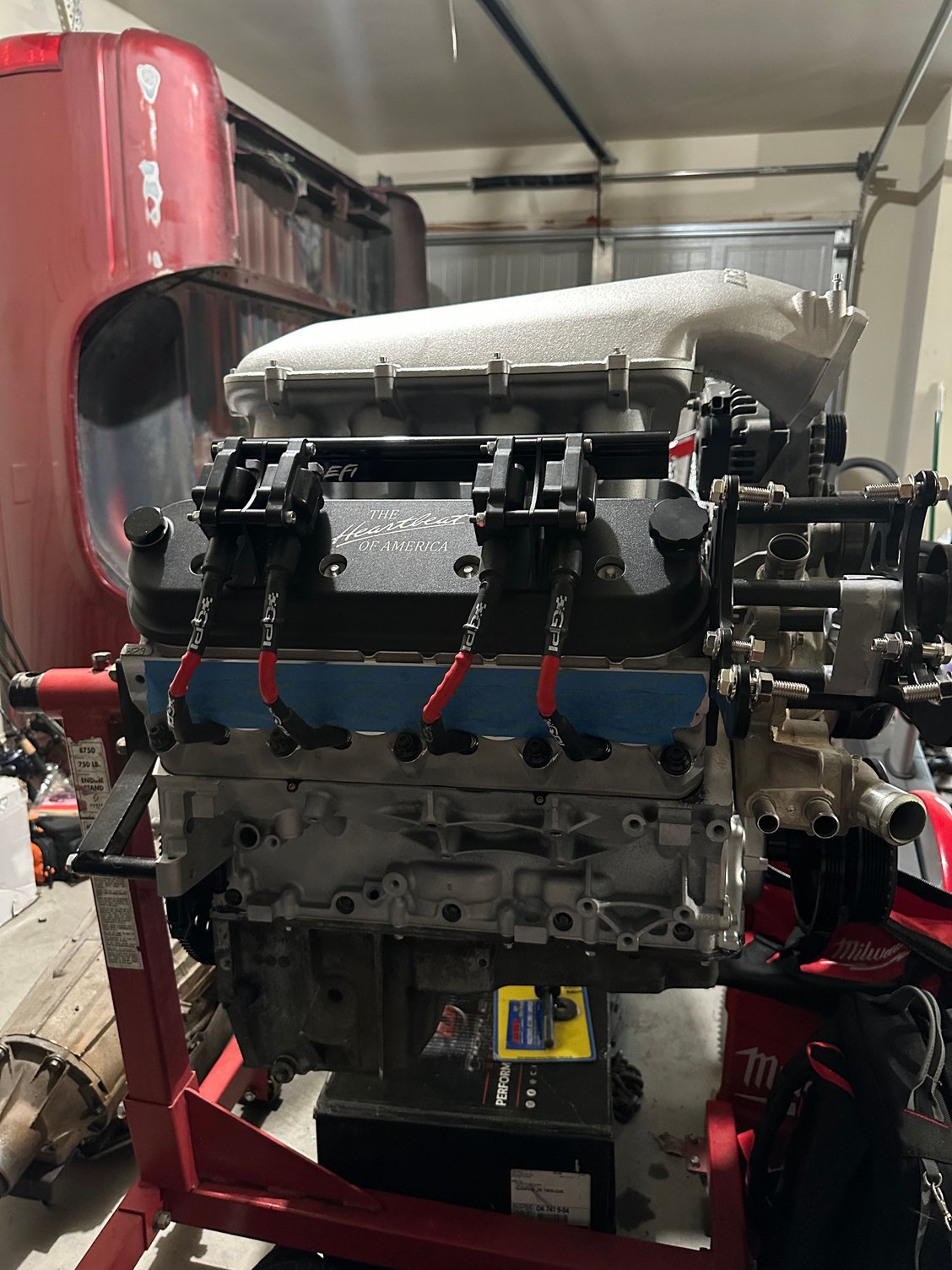

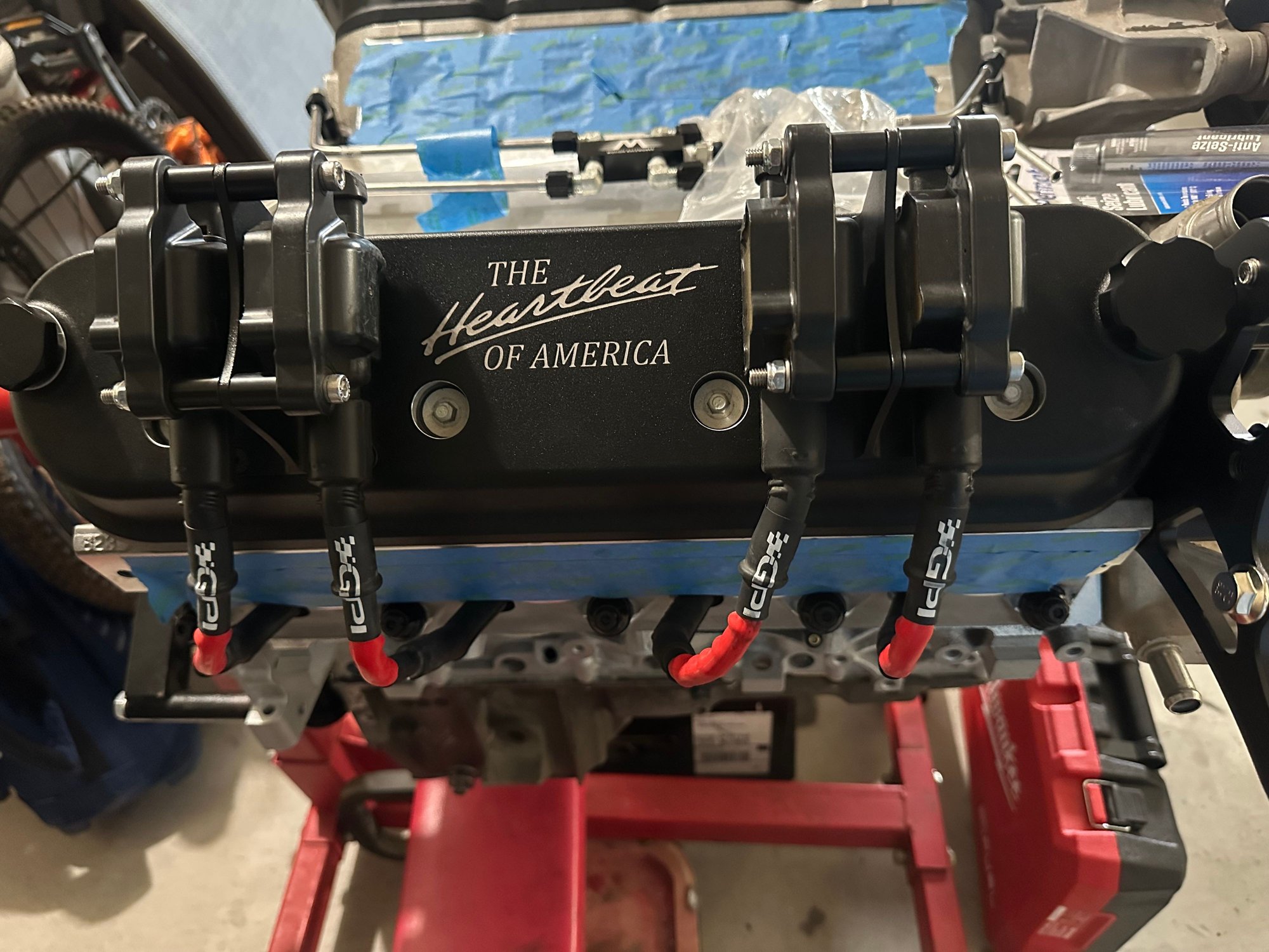

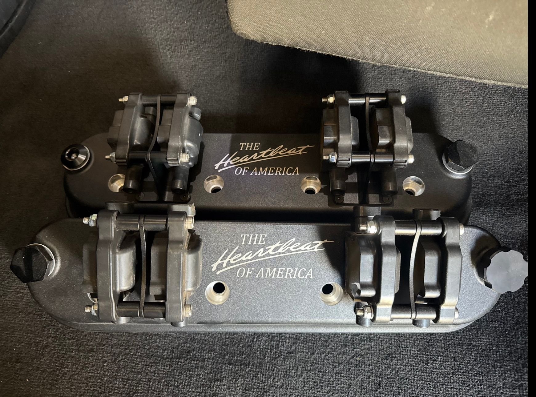

While I waited to find time to work on the chassis, I found someone local to CNC engrave a custom little touch up on my BTR valve covers. I found an old school set of SBC/BBC valve covers with “Heartbeat of America” and I had to replicate that. I think it turned out amazing!
Pictures to follow

That engine is a work of art!!! Its gonna have that OBS scooting along nicely when you get it in there!!!……good luck on your build, slow and steady wins every time!!!

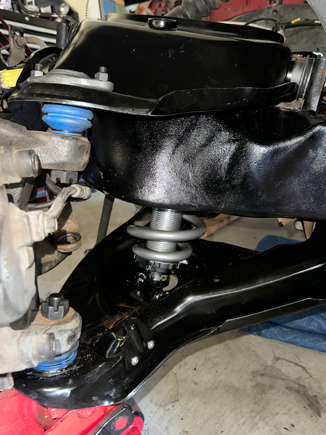

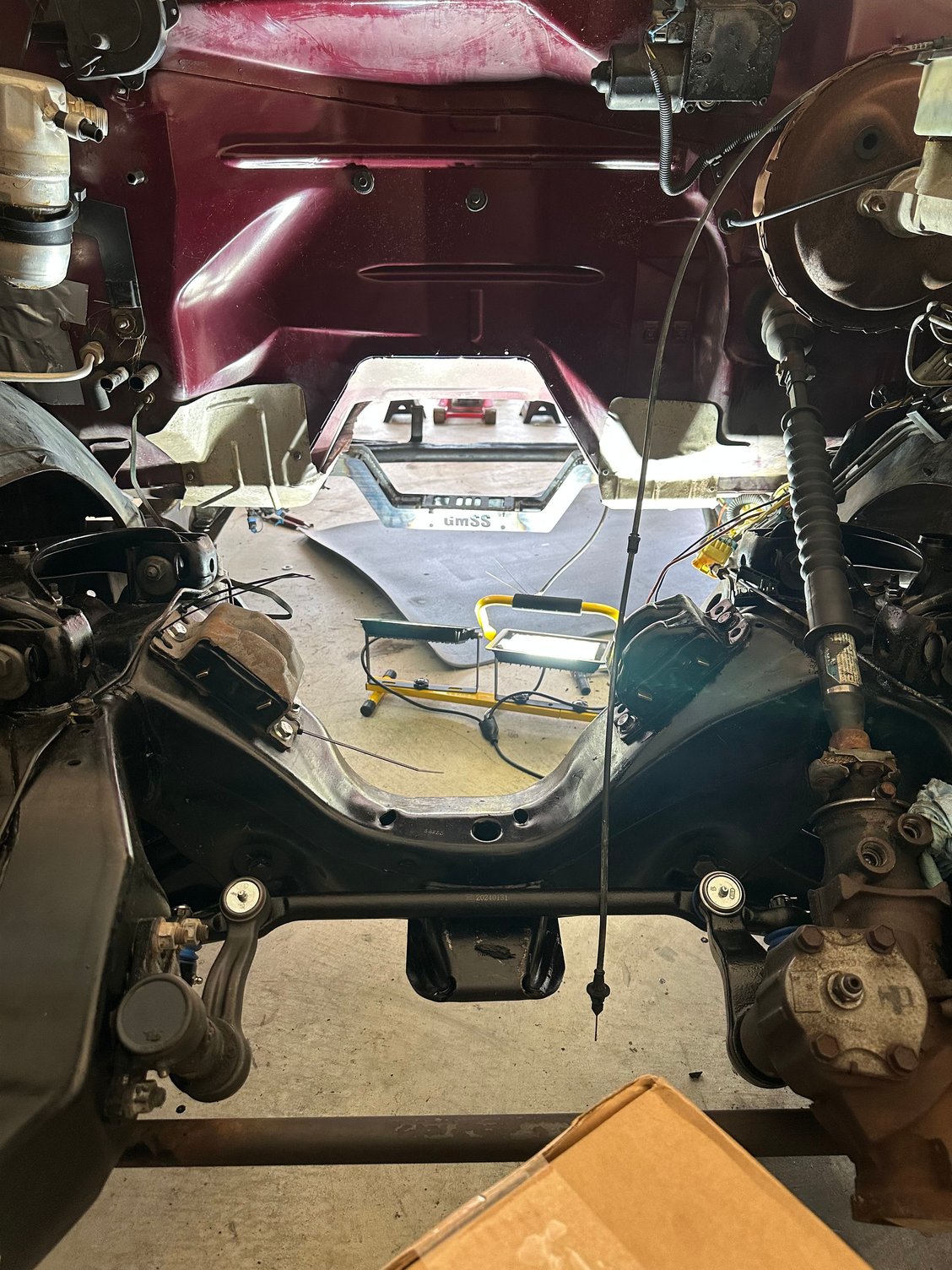

Progress is rollin!!
Front end is now complete (with the exception of pitman arm that needed to be warrantied out due to shipping damage and a new steering shaft to delete rag joint). All new suspension is installed with QA1 coilovers. Need to raise the coils a good bit to get me around a 3.5” front drop. Not an issue though.

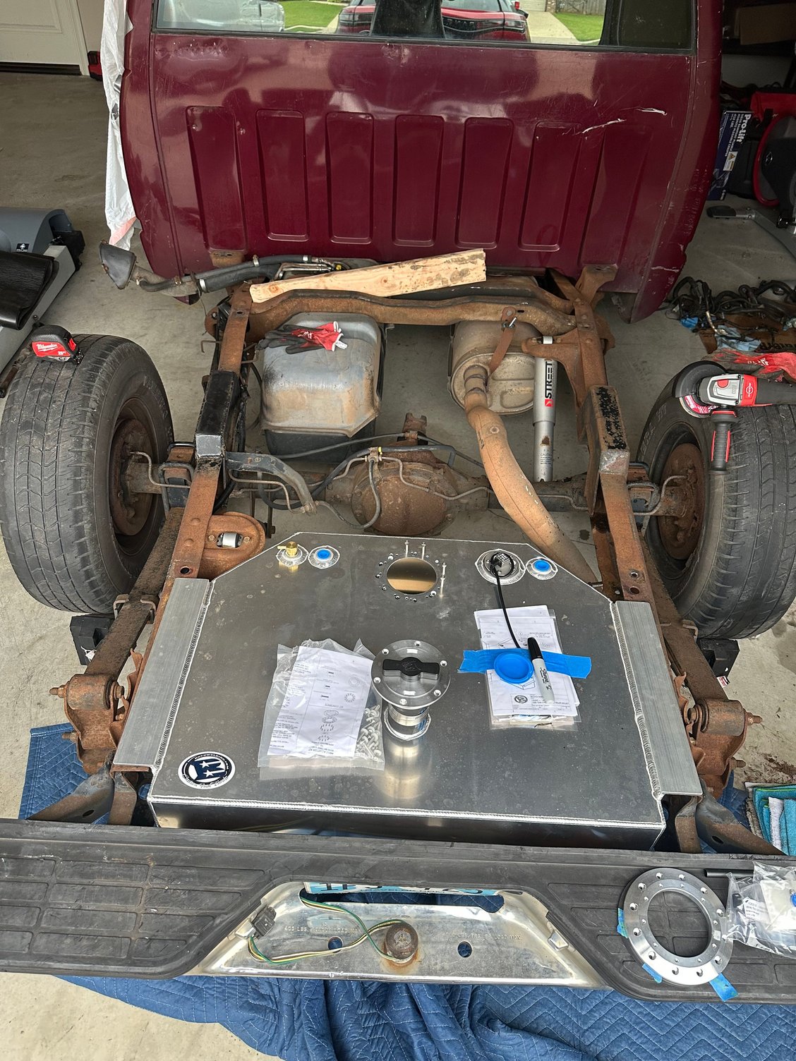

Bed removed and X frame brace removed to allow fitment for Boyd tank. Majority of frame coated also with more Eastwood product. I will wait to relocate shocks and add frame stiffeners once I get a 9” under it. I will slowly start to buy that stuff over the next month or so.
in the meantime, I managed to snag a brand new Holley Hi Ram 105 for $750 on marketplace! Awesome deal. Had a buddy grab it for me since it was 2 hours away and everyone was in line to snag it.
following up with next plans. Mock up and drill mounting holes for the Boyd tank. Drop the old gas tank and remove the fuel lines. And run front drive accessory parts to powder coat in wrinkle black to match the valve covers and AC compressor. More updates to come shortly! Longblock and transmission will be stabbed in next weekend 😎

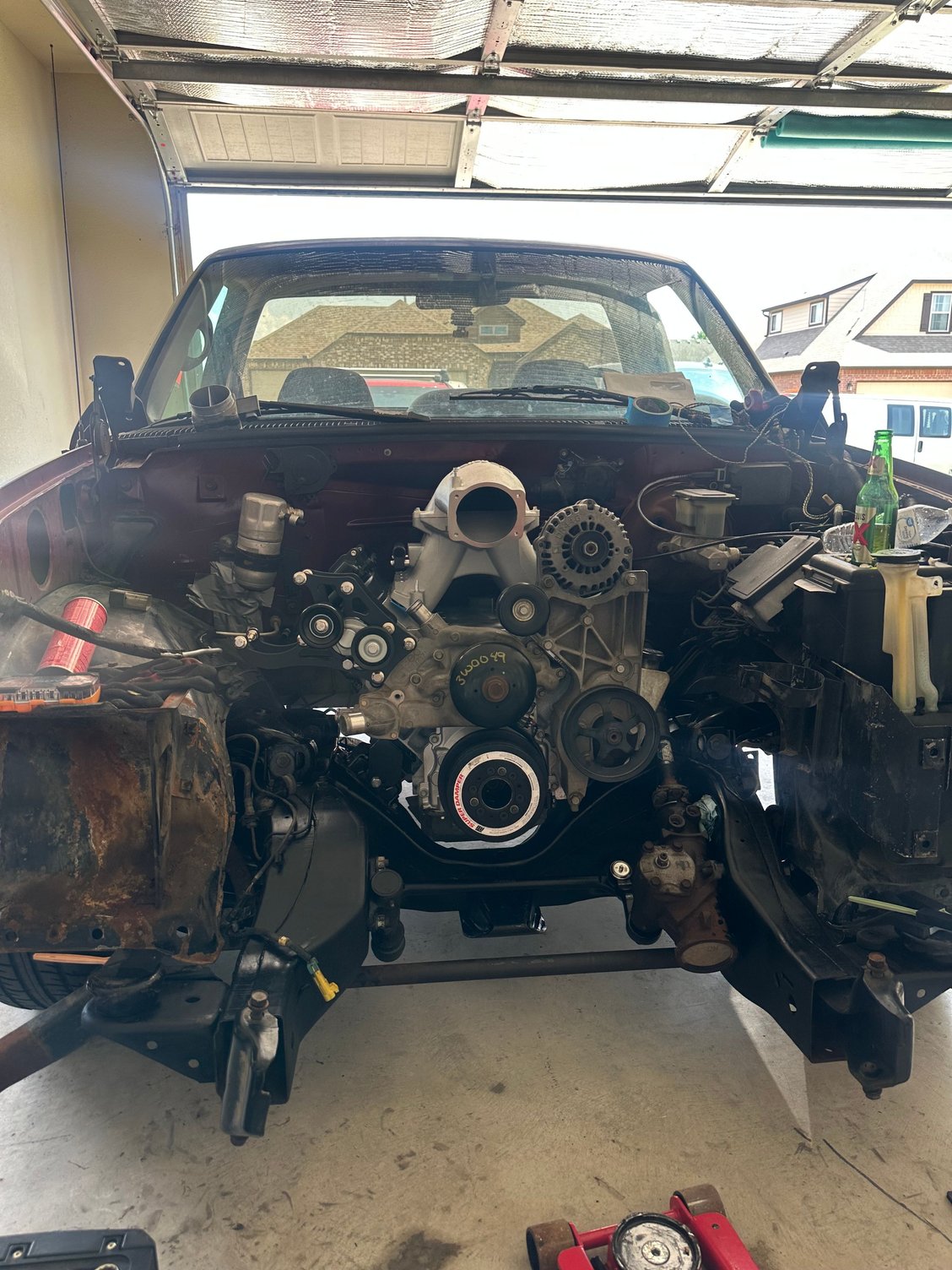

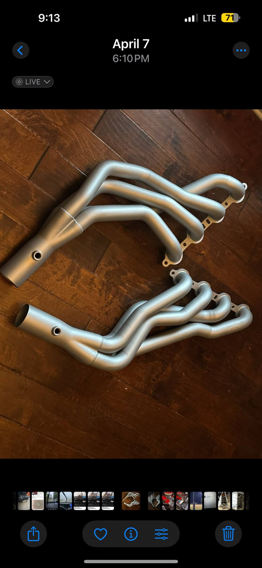

Tomorrow is a big day. Drivetrain is getting stabbed in! this week I also managed to find another great deal. SE 1 7/8” headers already cerakoted. These are specifc to 88-98 2WD also so they should fit like a glove!
I will upload some more pictures tomorrow once this beautiful combo is sitting at home!

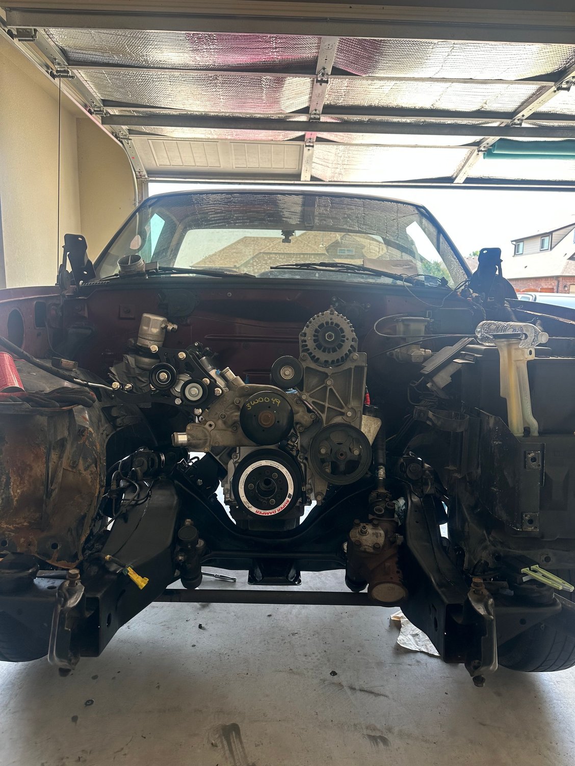

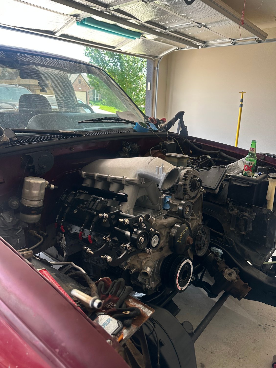

And just like that, engine and transmission is installed! Great day with my dad that I will remember forever! Now that we have that installed I need to get Boyd gas tank mounted and fuel system knocked out! Should be done this week and then the fun part of installing my plug and play harness!
