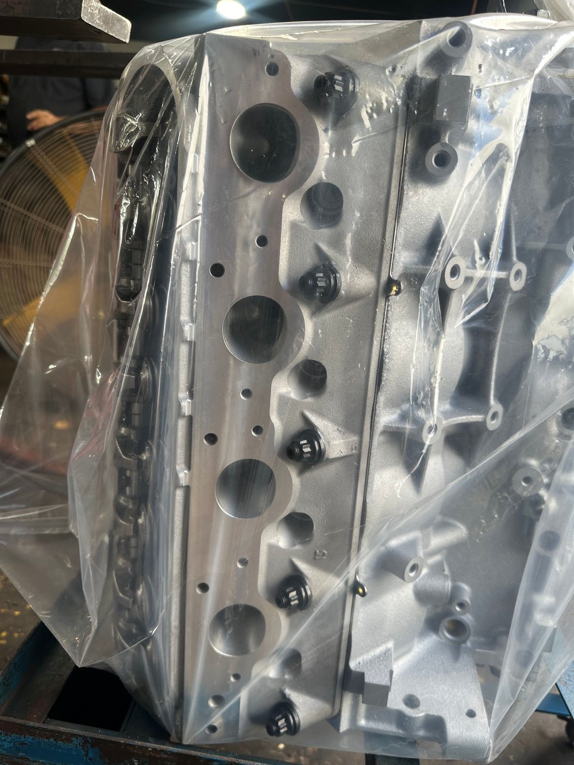

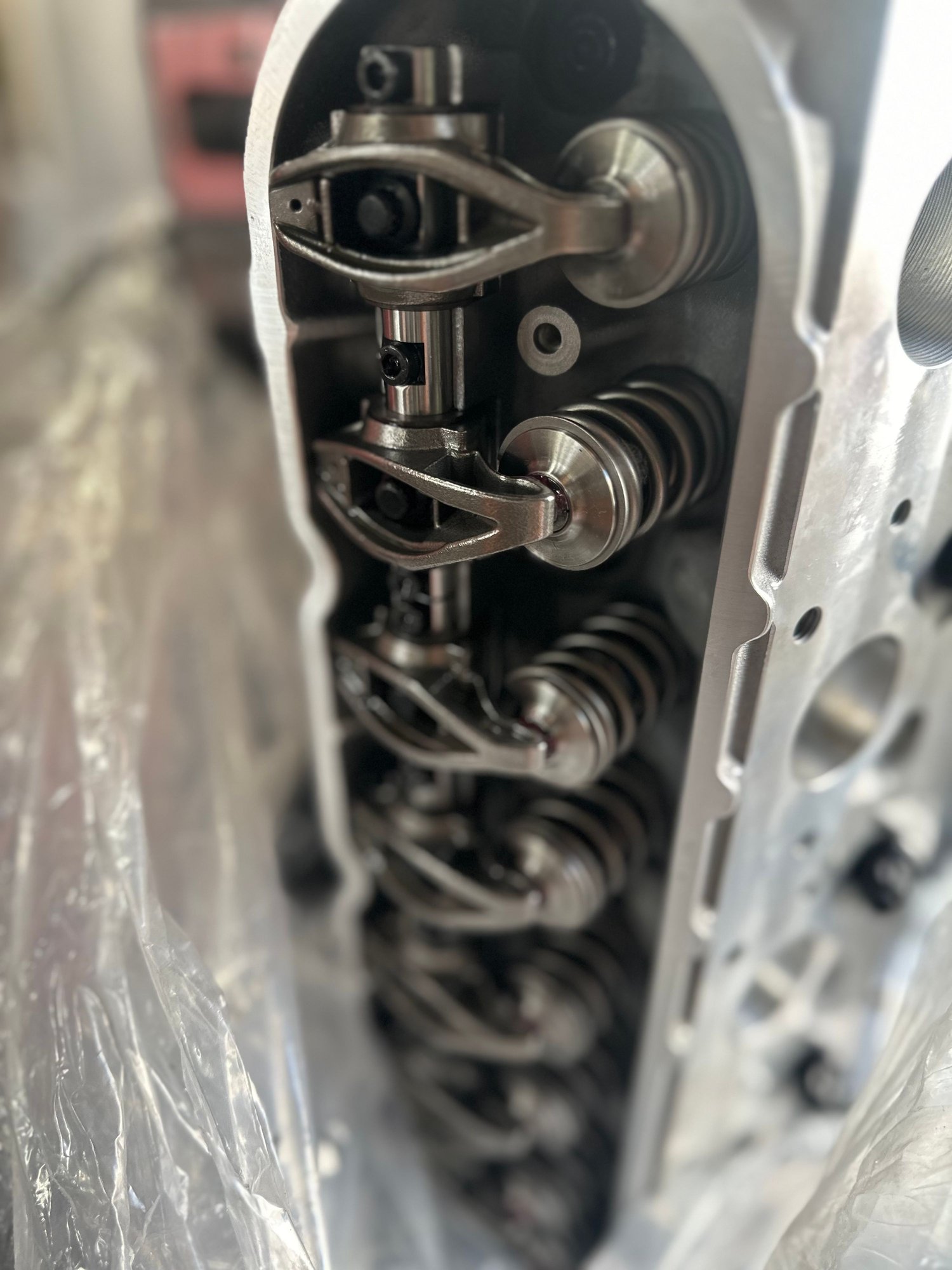

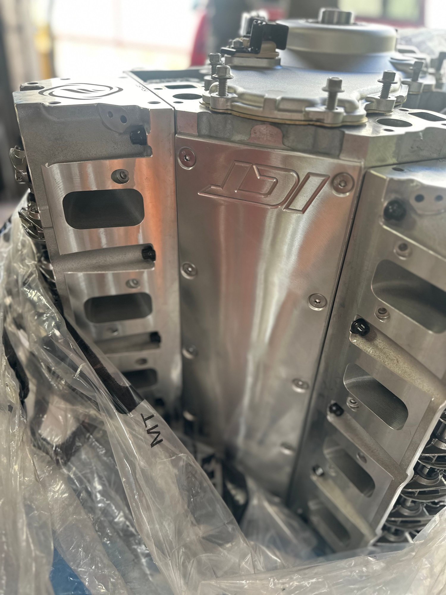

Welp. Machine shop called. The supplied “.660” springs supplied by Frankenstein won’t work with my combo. Not enough clearance at coil bind between the coils. He did have a spare set of BTR Max RPM .660’s he mocked up and they were sufficient. He has a set on order for me so hopefully this week or next is when I can pick up this longblock!
I’m ready to pull the trigger on a 6L90e so once I get longblock I will get that ordered up. Then giving Circle D a call for a 6F-PX converter!

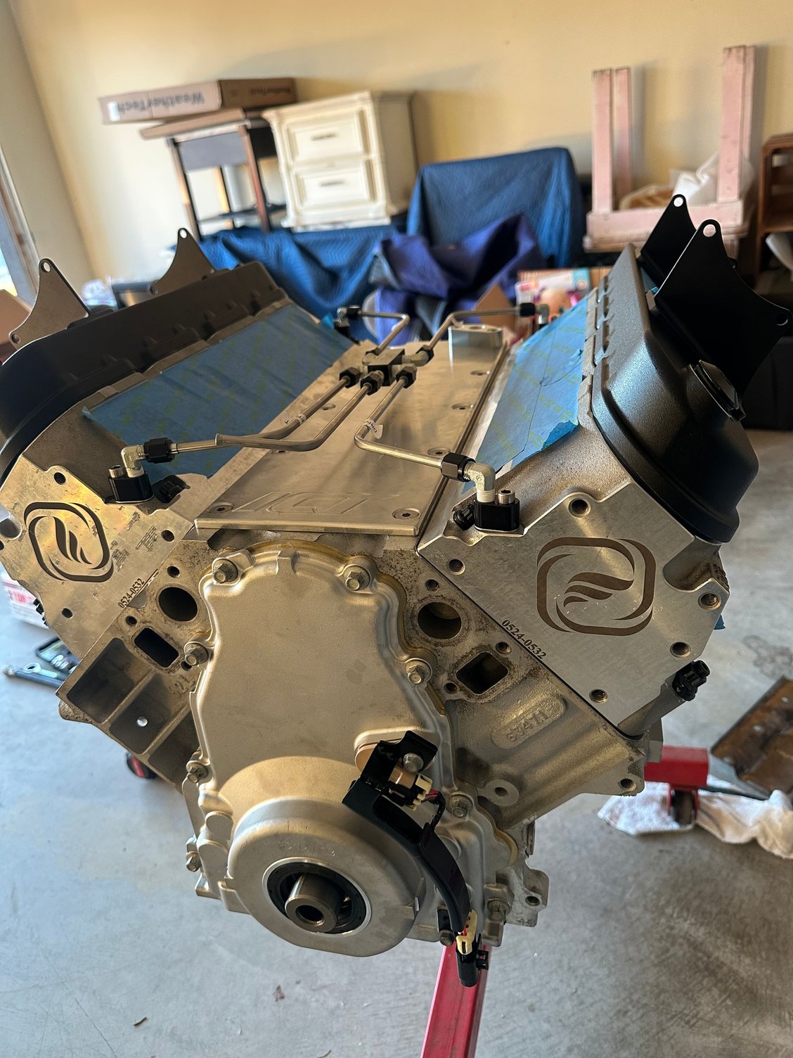

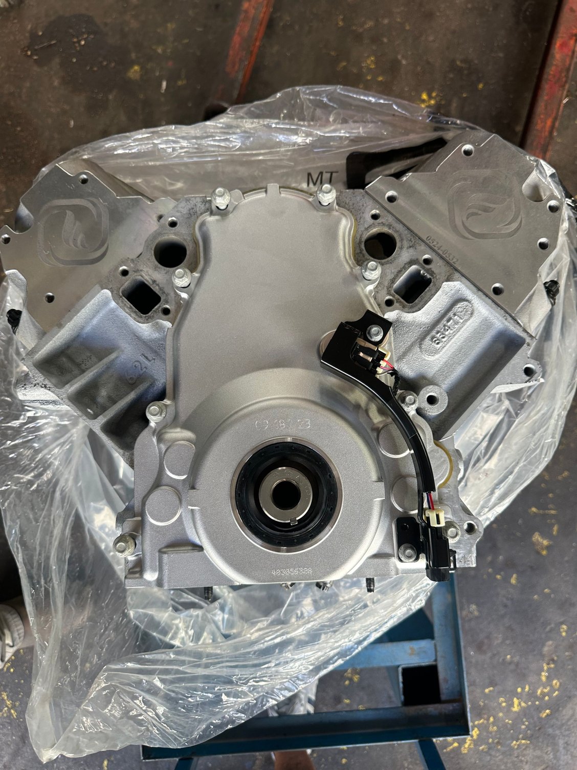

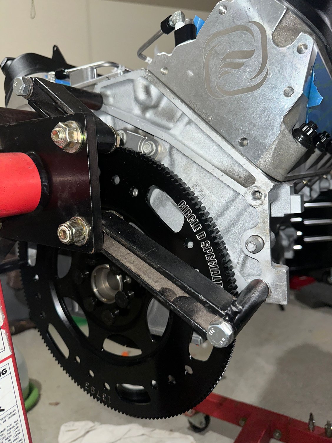

Christmas in October.. She is complete and home. Hardest part of the game is done. Now working on getting a 6l90e along with 6FPX converter.
If anyone happens to want to sell a 6FPX (normal pattern, not vette), let me know!
in the meantime, here is some engine goodies

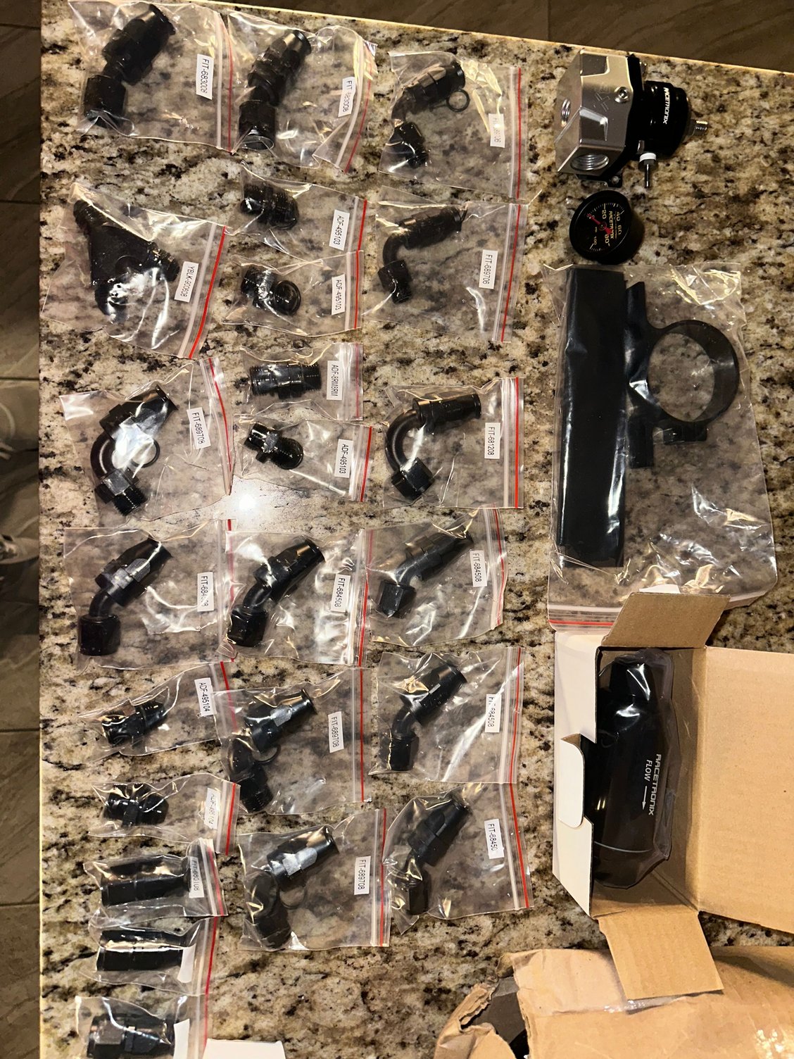

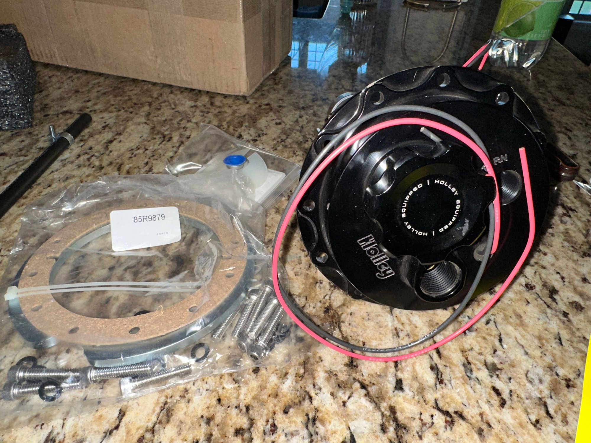

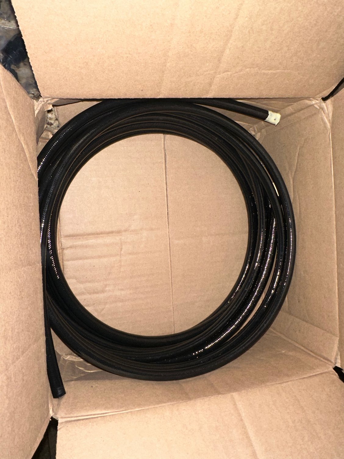

Fuel system has arrived! Doing -8 feed, and -6 return for future upgrades as well.
Also, Holley 12 bolt flange assembly arrived also. Currently has a 450 pump. May leave it in and see how it holds up. I will have to redrill holes for the Holley assembly on the tank, but won’t be hard to do!

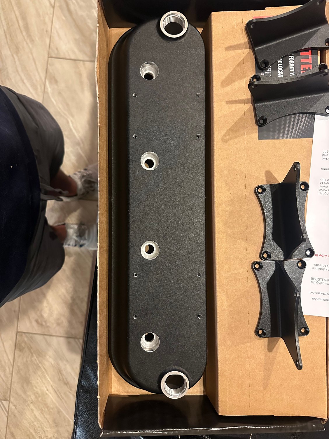

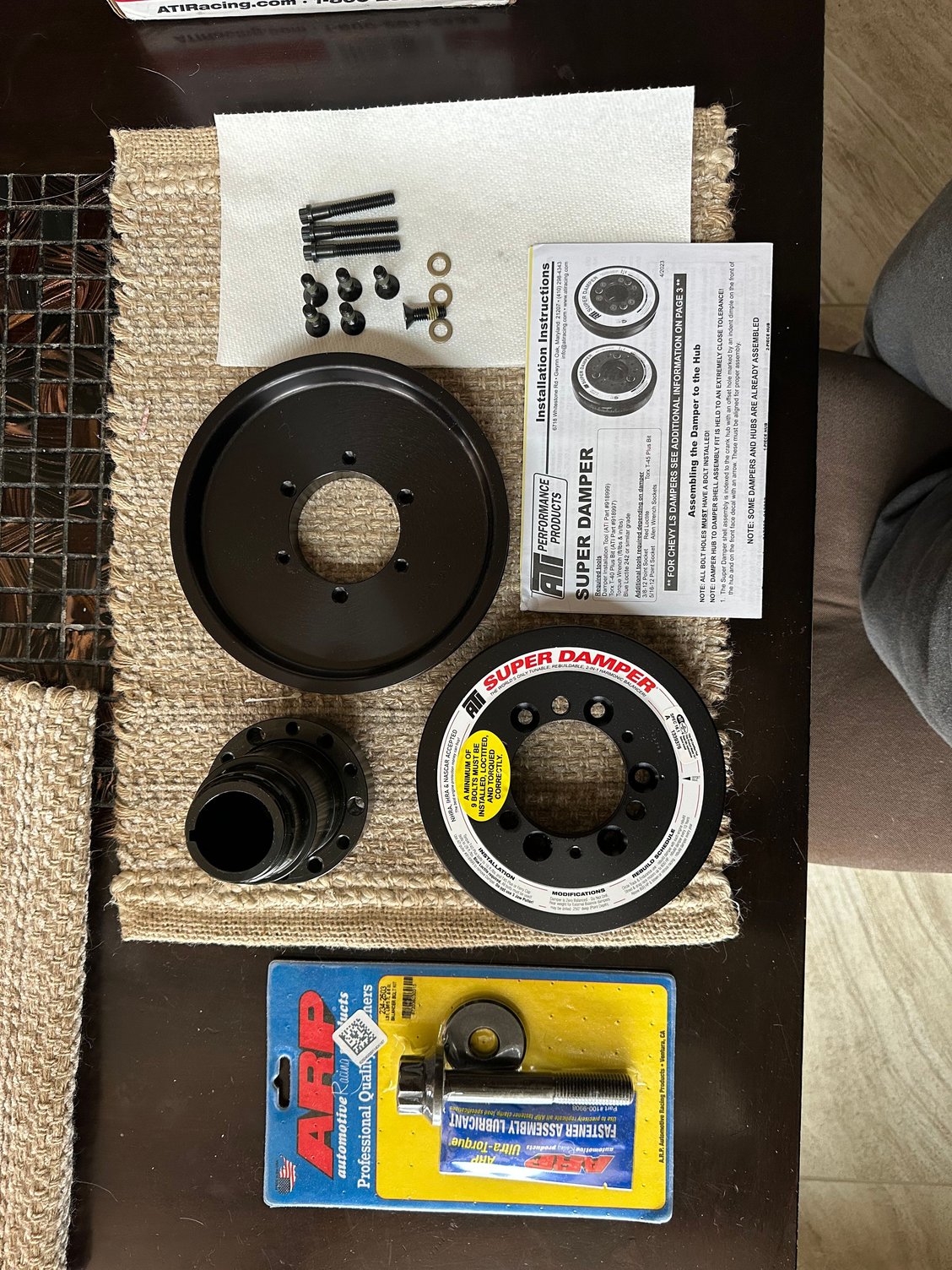

Few more goodies rolled in this week. BTR valve covers and ATI super damper.
BTR valve cover will make it easy to route catch can setup BUT also because I have a pretty cool design in my head to have laser engraved onto them.. working with a local shop to make it happen!
10% UD on the ATI. Anyone know why they don’t offer a 20-25% UD on the truck/camaro spacing? The only vehicles I saw for 20-25% UD was 14-16 SS, and 04-06 GTO?

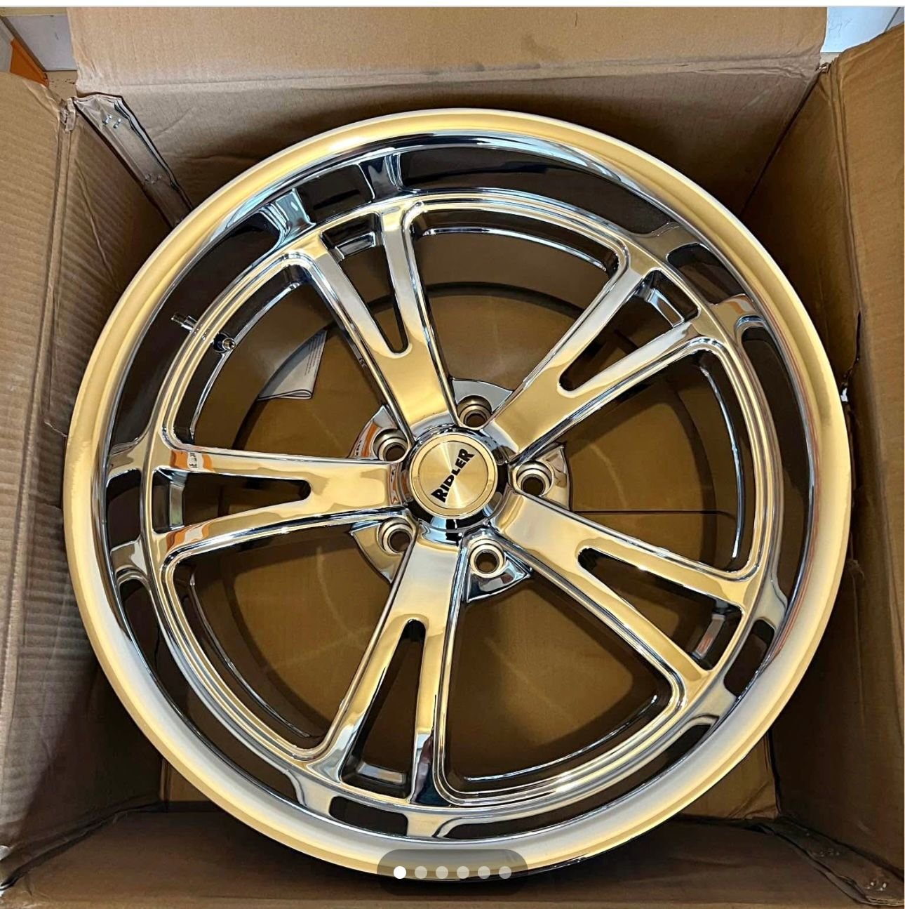

Few marketplace finds this week.

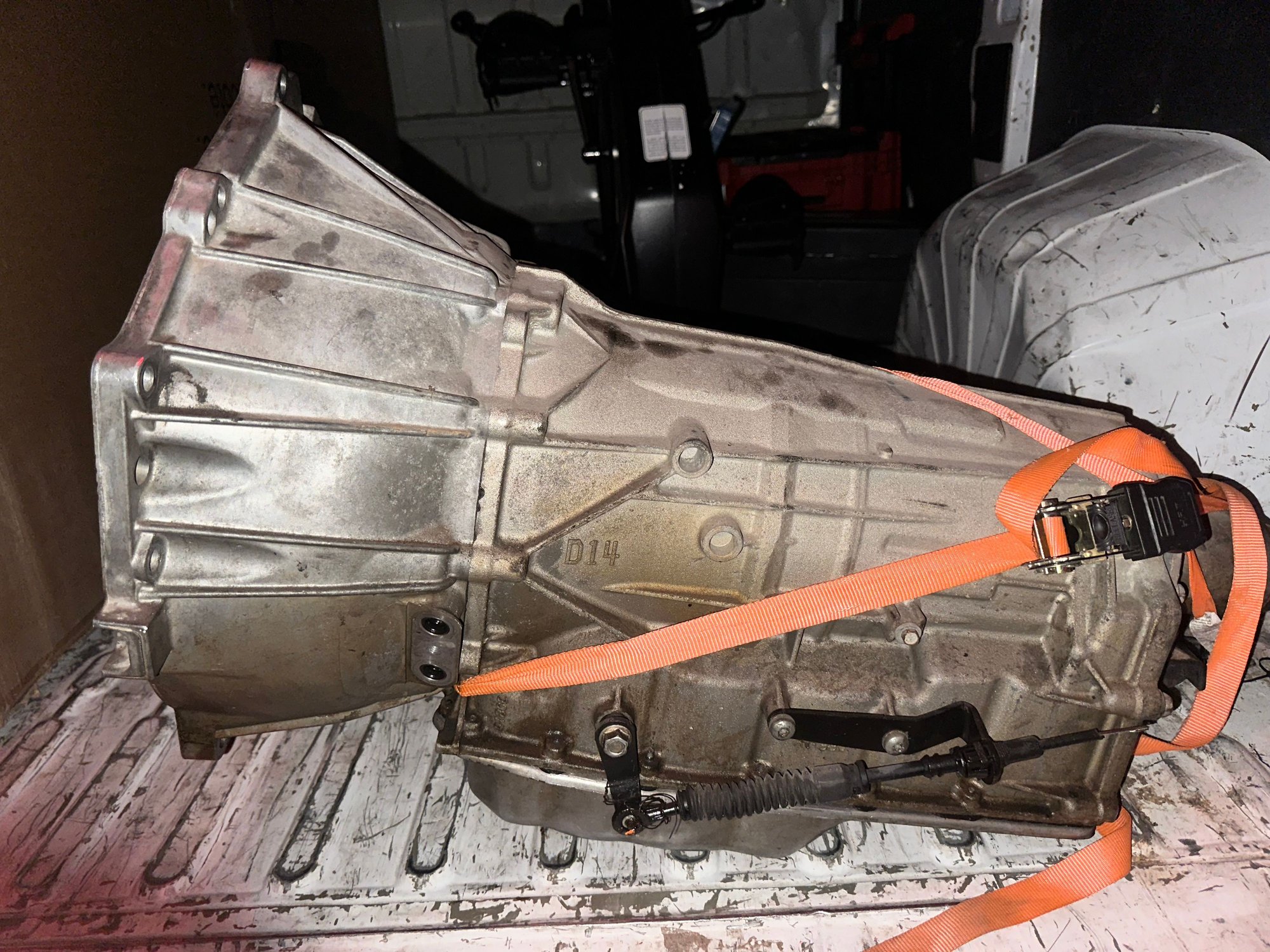

Ridler 606’s. 20x8.5 front and 20x10 rear. Didn’t anticipate to get wheels yet, buf saved $700 compared to a new set. These will be my street combo to run
6l90e 2WD finally found for a decent price. Good running trans. It has been rebuild but low mileage unit. Only reason they were rebuilt was normal maintenance when torque converter needed replaced.
Project will officially start on Christmas!

Still unfortunately waiting on my Circle D converter. On week 8/9 and was told 4-6. Not a big deal. Can I ask how many of you had to hone the ATI hub before installing onto your crankshaft?
Anyways, here is some more pictures!
