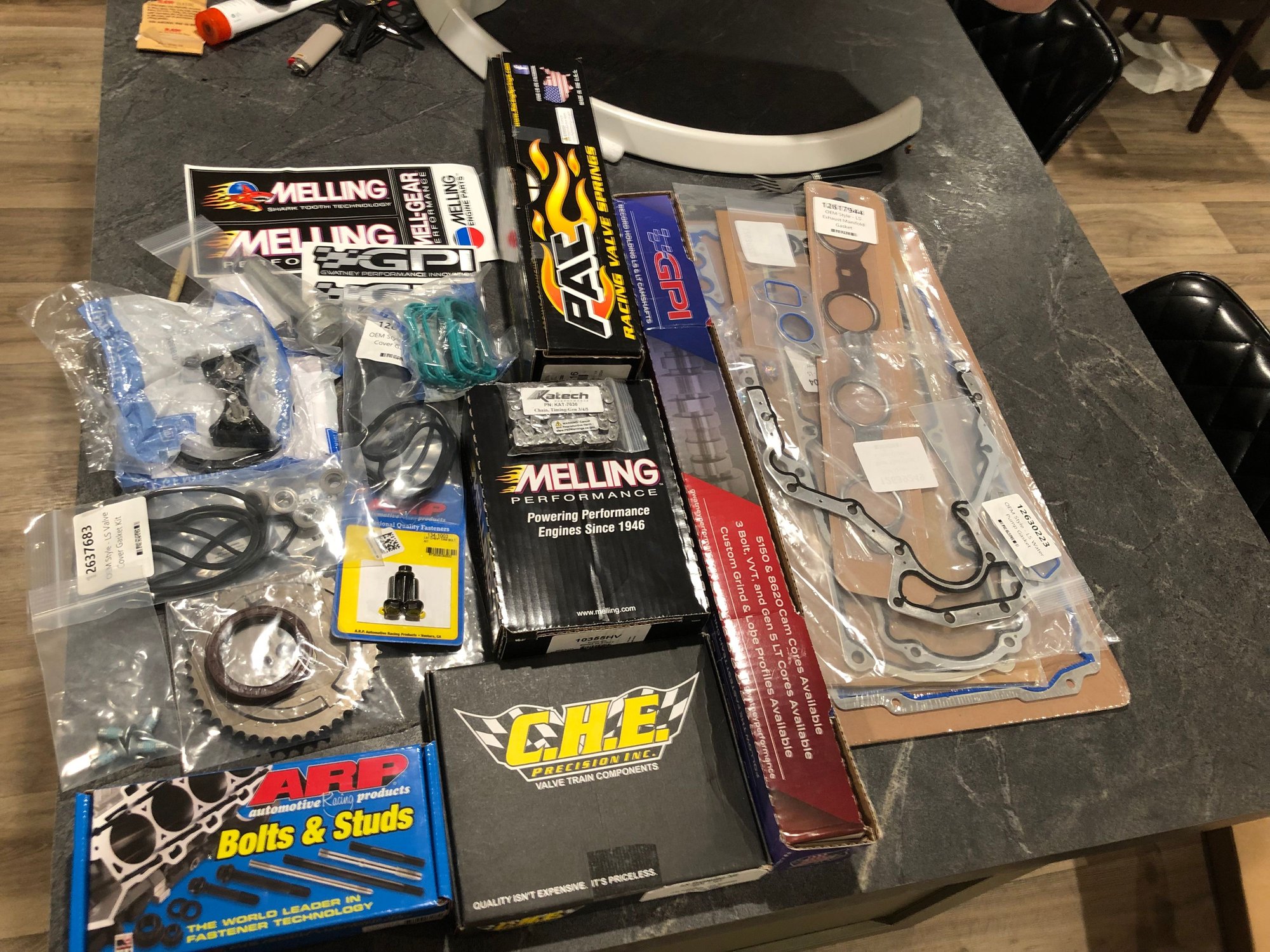

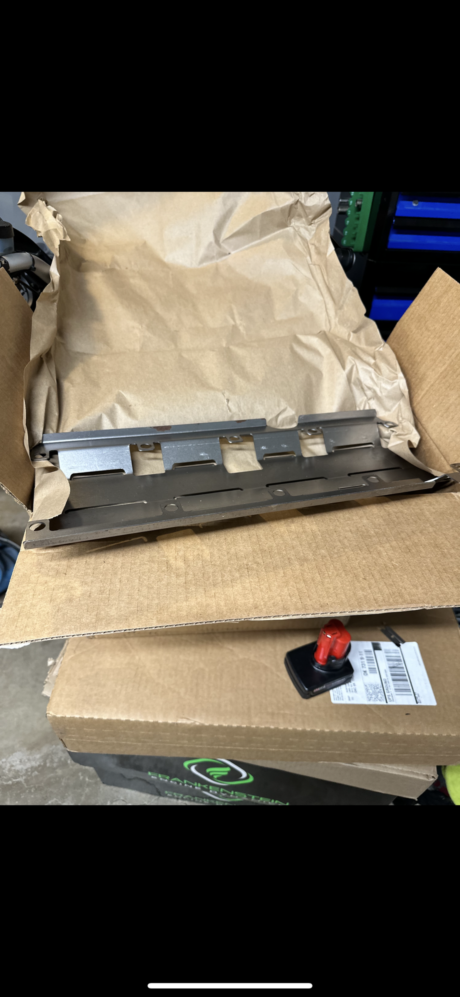

More parts arrived! Holley drop in with 525 pump showed up yesterday. I also decided to go with the Mast windage tray for 4.00-4.125” cranks. I know you can use washers to space the factory tray enough to clear, but personally didn’t want to go that route.And I also got a few videos from my engine builder this morning! Block preparation has begun. I believe I have all the little tidbits to complete this long block now.

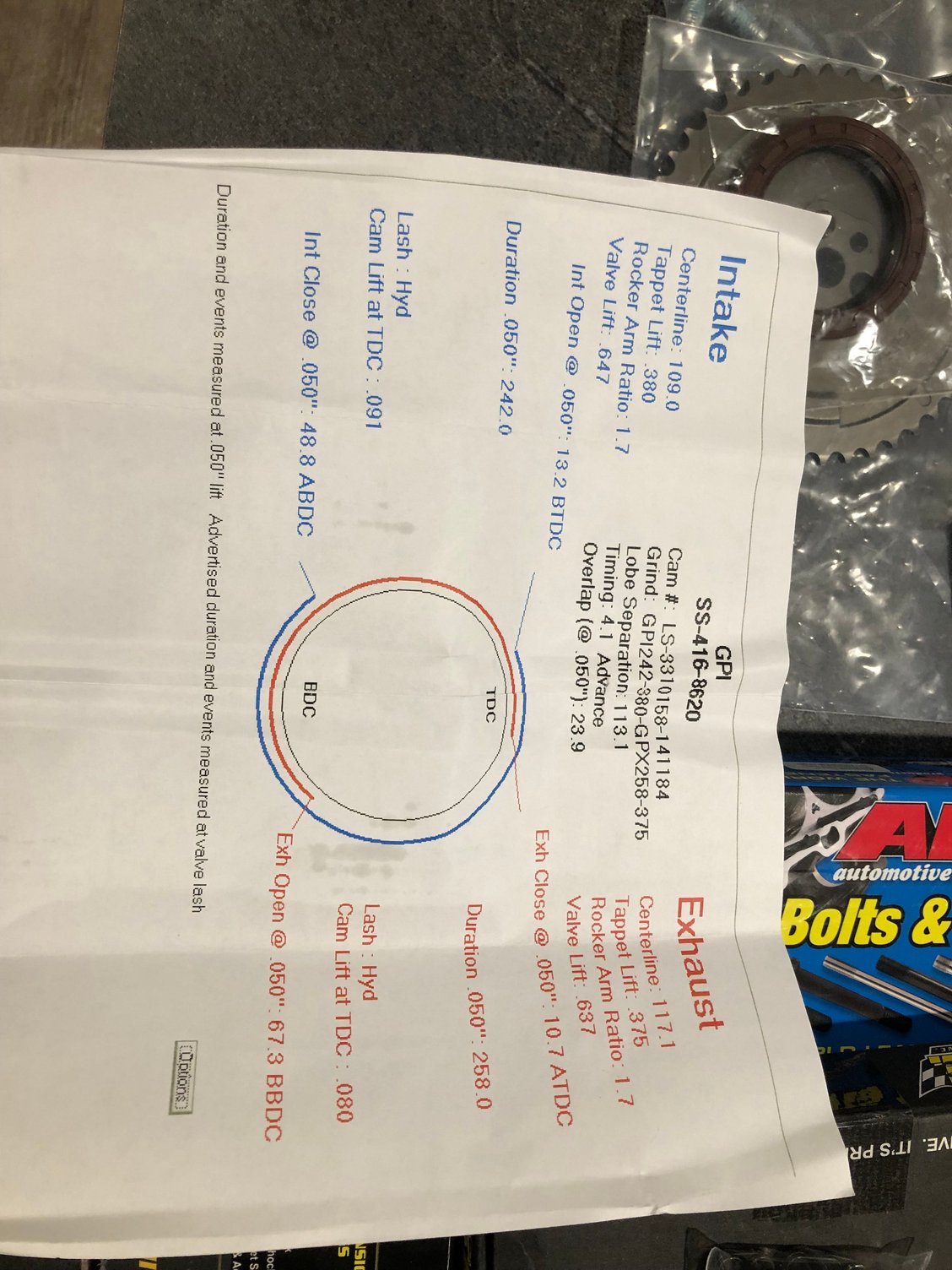

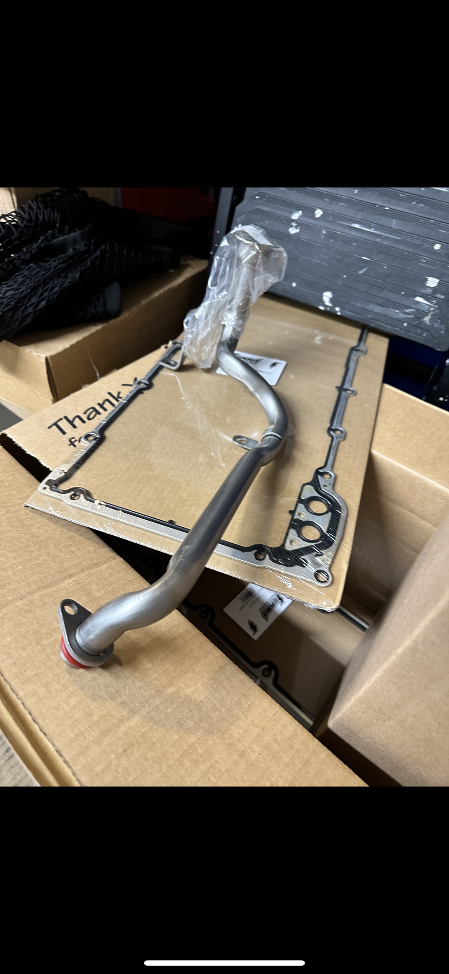

Hopefully the last round of parts I need ordered for longblock. Now I sit back and waiting on machine shop to assemble. I found a truck pan on marketplace for $40, and for peace of mind picked up a new pick up tube. Oil pump is 10295
Circle D spec’d me at a 6F-PX which is a 245mm and flash around 5000. Figured I would pair that with the 6L80/90e trans and probably a 3.42 rear gear.

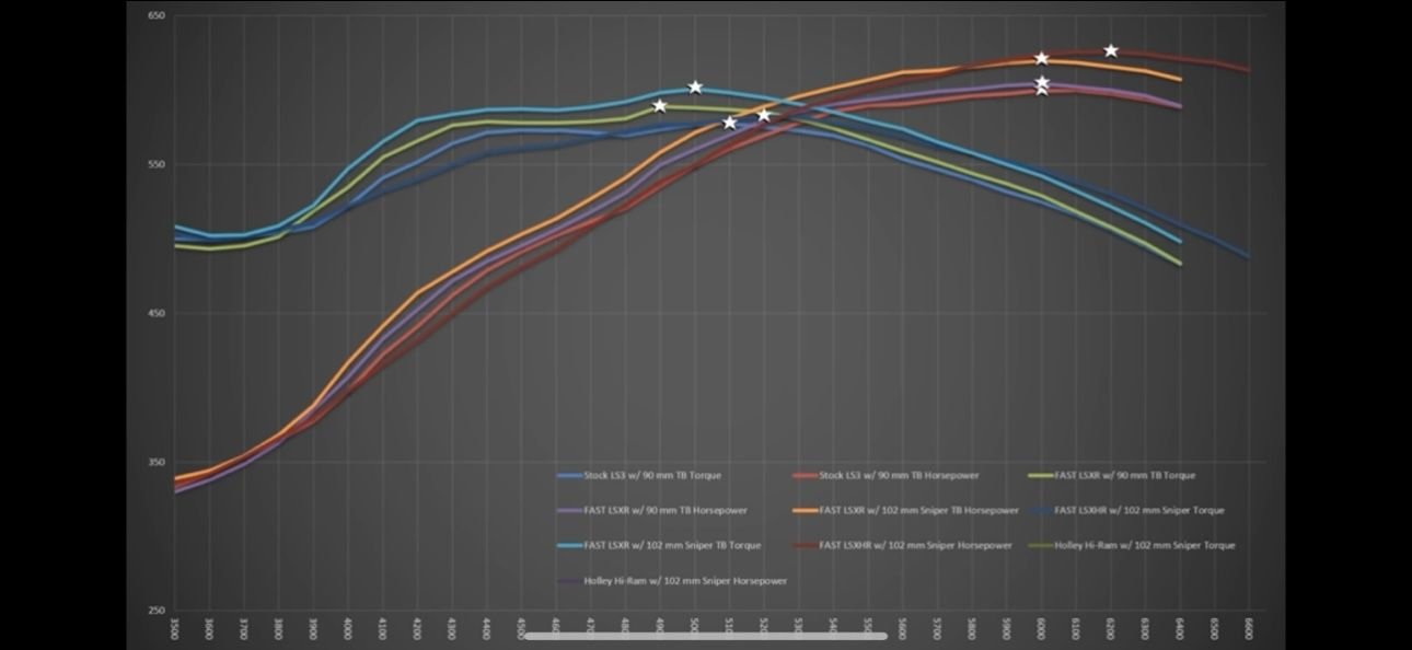

Scratching my head on intake manifold choice. Originally, I planned on the FAST LSXHR. Pulling 7000-7500 range. But after this test (only able to find 1 using 400+ cubes) it appears the LSXR can be a solid candidate. What do yall think?
I have seen every test on stock cubes, BUT, it appears the LS3 manifold is out gunned by the LSXR (which usually isn’t the case on a LS3)
I think I may be leaning towards the LSXR now. A lot better midrange and only sacrificing a little up top
I will ask this, using a 5K converter, is there even a need to worry about mid range power here? Again, truck will be a street strip combo. Primarily street. 90/10
*edit* I guess this isn’t really a great test for my setup either. Seeing they only rev to 6600 I’m sure the HR will making that much more power up top. But it is interesting to see mid range gains
LSXHR, all the way. It needs porting out of the box, but it works

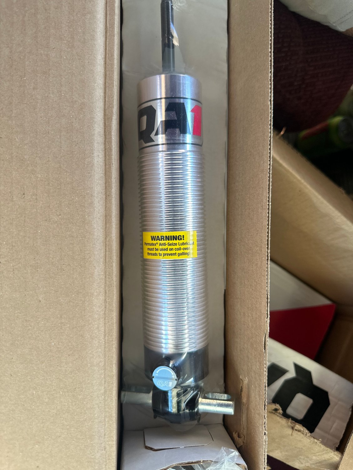

Dropped off remainder of parts at engine shop to complete assembly! Bill is paid. Just waiting on the phone call to pick it up!
Also managed to find a front and rear QA1 shock setup for my truck with relocation kit. Talked guy down to $850. All brand new in packaging. Saved ~$400 there!
Installing everything this winter. Hoping for early spring for the first joy ride

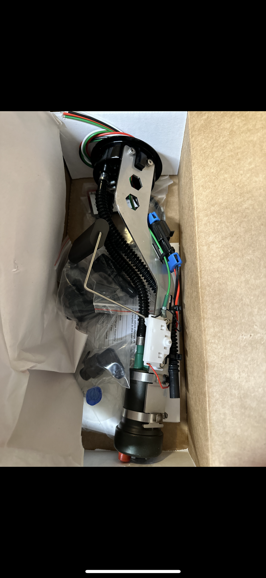

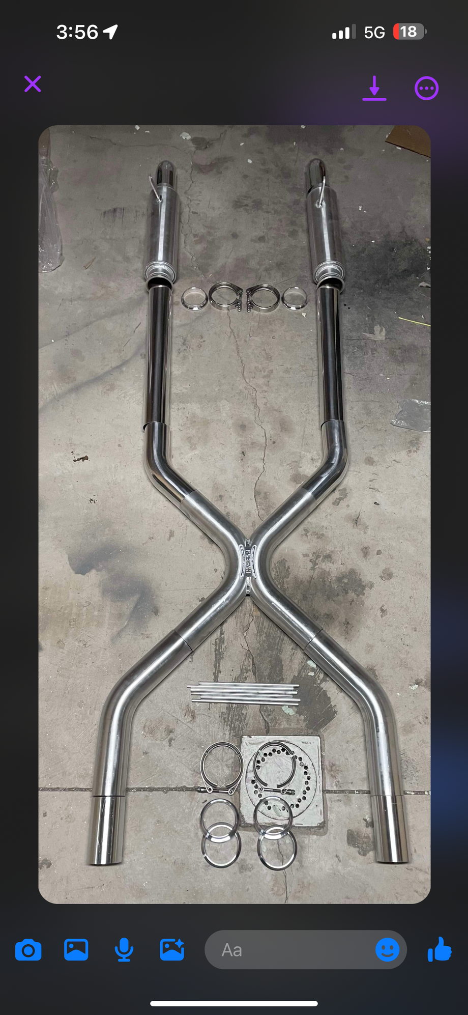

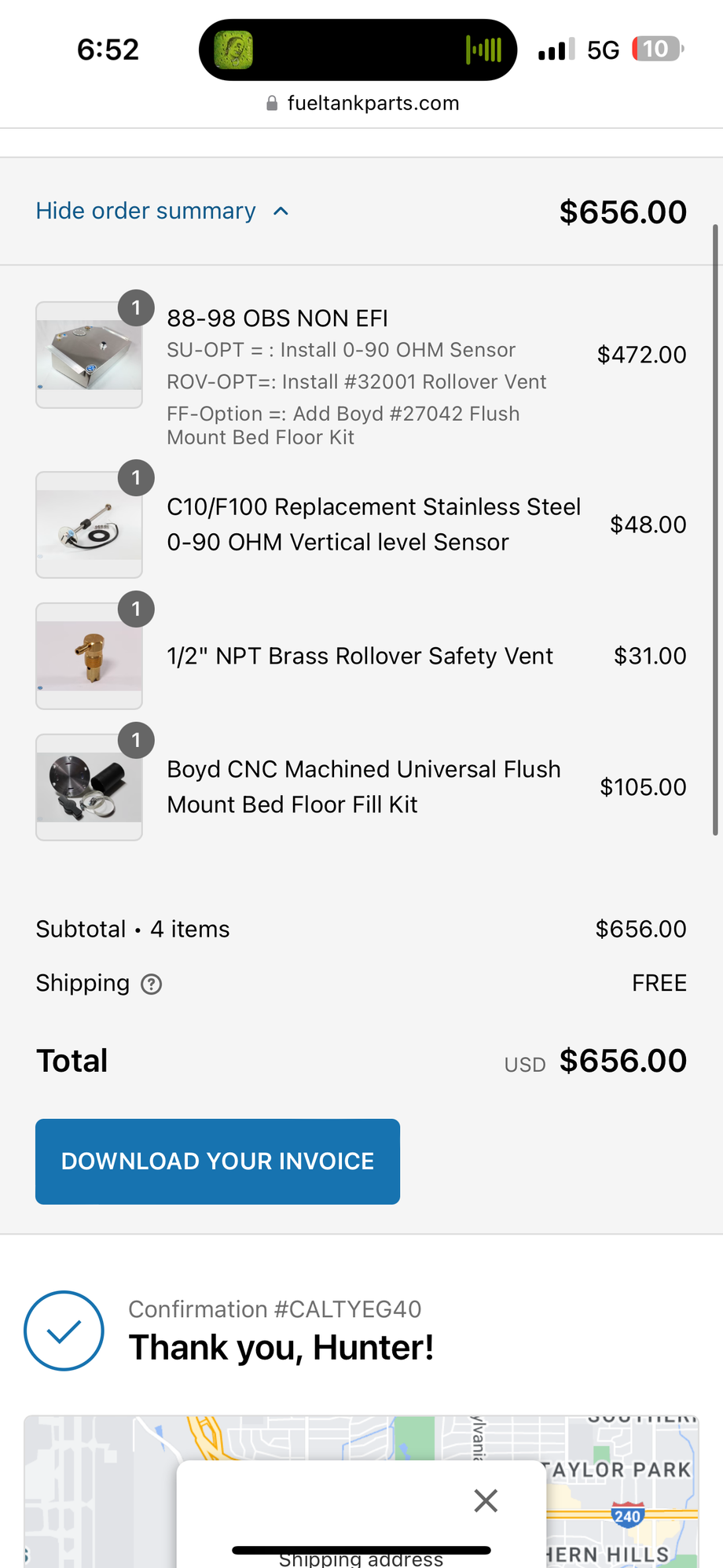

More puzzles ordered. With how I want to run exhaust, stock gas tank needed to go. I will run the Herfurth exhaust system with equal length. I’m still a little ways away from ordering, but should I do 3” or 3.5”?
Also ordered a Boyd’s fuel tank to make exhaust fitment easy. Hopefully hurricane didn’t effect them. They seemed to be right along the edge of path being located in Ocala, FL.
