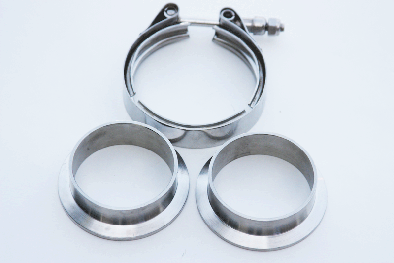

Making me wanna freeze my *** off and do it in the driveway a little. Going to get the vband clamp ends welded on after doing some measuring once that arrives next week so I can run a straight pipe when off road or a catted one.
