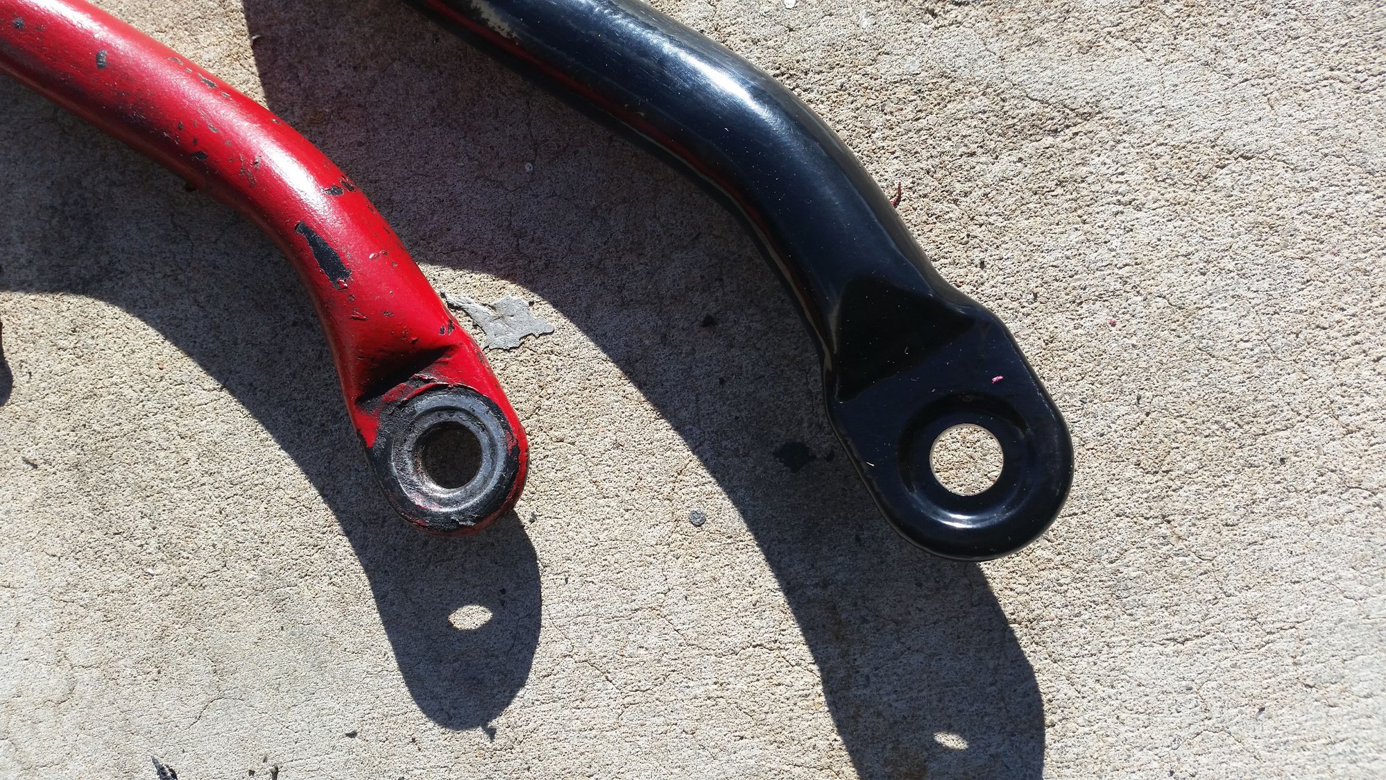

You will love the sway bar upgrade, BTW black is the Dorman solid34MM

****, thats big. Is that red bar the stock GXP or is that the one that broke? Looks much smaller.
