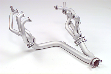

I disagree. Here is a picture of a true shorty header (these are the SLPs):
Here are the MACs:
The MACs have a noticeably longer tube design than the shorties.

Just to add, the slp shorty pic you posted was the 96-97 dual cat style. They were a TERRIBLE design, but if someone needed a dual cat emmissions legal header I'm sure it's still a decent improvement over stock.
I couldn't find any pics online of the 93-95 style (surprisingly) for comparison, so here are some of mine. Dont have any of the y but it looks very similar to the mac y:
They are 1 3/4" primaries, stainless steel. Had them Jet Hot coated a few years ago to shine them up
