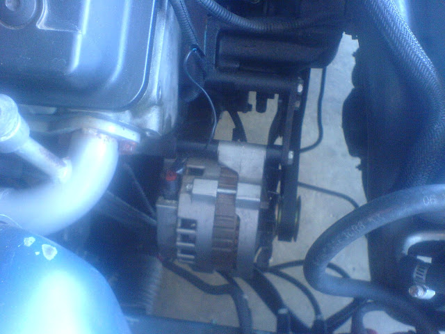

I know all about relocating the battery. I did it too the car way back when I built the first motor for the car. I always had starting issues and finally got fed up enough with it to just put the battery back where it is now. Now that I think about it I will probably leave it where it is. As for the alternator relocation, The one MattSapp95_T/A did is really nice, he cut an modified the top of the bracket and added a piece of angle iron on the side where the alternator can bolt. The alternator bolts in the location of the A/C compressor and you keep the powersteering and the tensioner in the stock location. He has about 60.00 in it buying the new pulley, belt, and having it powdercoated and it is one real nice piece. "Tireburnin" do you have a picture of your relocation you could post?

Cell phone picture, but you get the idea.

Nice and simple. I think I'm still going to modify my stock bracket to keep the power steering. I'm still running 17's until I get the money to buy a drag setup. I'm in the process of saving for a rear at the moment.
