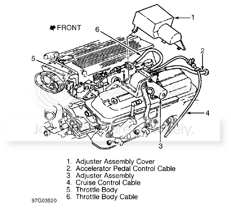

Can someone without TCS just look under the hood an tell me how the throttle cable is routed?? Any cruise? Pics would be cool. Just need something!

I cant take pictures as I don't have the car anymore, but I can try and explain how the cable are routed.
The cables from the accelerator pedal, and cruse control go to the ASR module. Then a cable goes from the ASR to the throttle body. There is a different cruise control cable for with and without ASR. I don't know how you change the cruise control cable but I know it can be done.
IIRC you might also need a different throttle body if you want cruise after removing the ASR. I think the throttle body that was used with out ASR has a different piece for the cables to connect to.

Could not post this earlier, but here is the only diagram I have.

Thanks Chris.
So from what it looks like. I can just get a throttle cable. And then adding cruise is a totally optional choice.

Yes, just get a throttle cable to go from the pedal to the throttle body.
