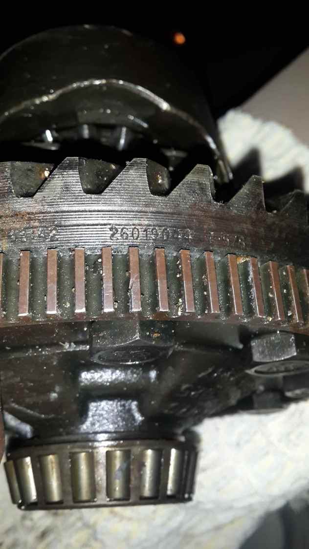

Hi guys,

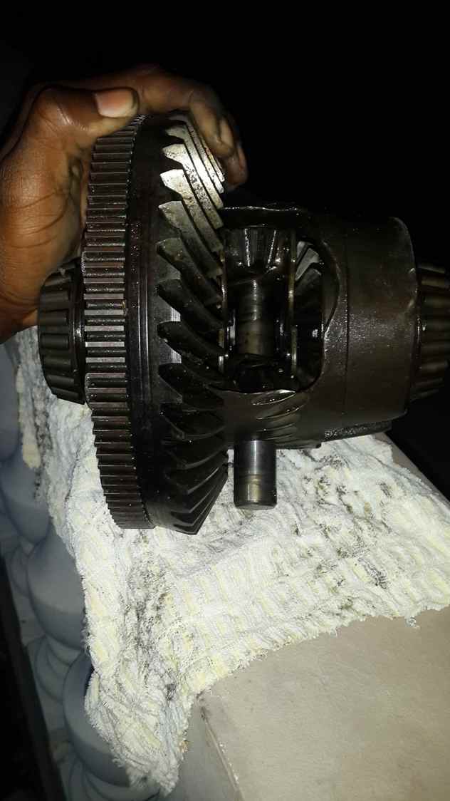

just got a donnor rear end, found a diff inside with the numbers 26019044. Looking into the parts manual i dont see that numver on anything. Second in between the small gears there is like a ig clip with some springs but looks like one is missing. How many springs go in there, what is the part number because it also doesnot apoear in the manual.

Is that number on the gear or the carrier ?
Picture !

From the gear looks like it is a 3.23 but i would like to know if it is a POSI (g80)

13:42 stamp = 3.23

Those numbers are only for the ring and pinion.
The springs are what provides the limited slip (LSD)

Okk great, so its a LSD . Where can i get those spring i think there are some missing, how much should there be??

Should be 4 springs
Drivetrain shop or Dealership

The carrier is an Auburn cone-clutch carrier,vintage 1998 and earlier.
The 3.23 gearset indicates it was from an automatic transmissioned car.
The carrier is a 3 series,28 spline.

Only reference I found for a 26019044 is on the Motive site and a number 26019043 is a 3.23 gear set.

okk i will look into that. In the servive kit i see 5 spring..... i will see if i can find a video or article on how those springs go

Once that center pin is out,which you show partially out in the 2nd picture,the spring loaded plates pull out. Each plate has 5 'dimples' to show/indicate where the springs sit.
You might not be able to pull the plates out with the ring gear still on the carrier(gear teeth might be in the way).
In case you do have to remove the ring gear,the 10 bolts holding the ring gear on ARE LEFT HAND THREAD.
