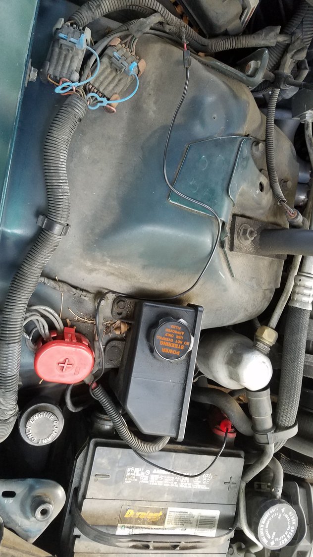

To test the fuel pump directly with 12 volts, bypassing the relay, connect 12 volts to the fuel pump prime connector, near the computer.
Then try to start it.

alright so im not gonna be able to remove the core as of now, i dont have a core puller and im not breakin the thing by accident.
i have a jumper wire clamped on the pos side of battery and plugging into the red bypass wire does nothing.

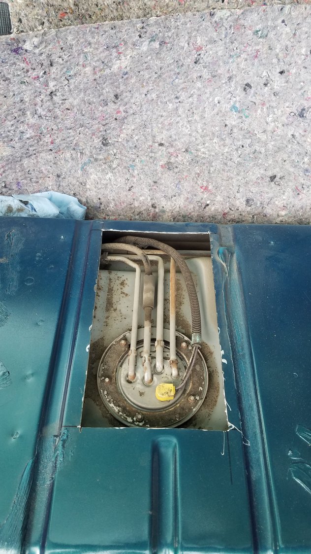

have cut the trap door in the trunk. 6 hrs crawlin on the car, its 107 outside, im done for the day gentlemen. i will update with any progress.

Dude thats where im at currently. i appreciate the help but as for troubleshooting the problems im having troubleshooting, the damn pump is on its way, the whole octopus, pump, in tank filter, sending unit, ill pick up a filter if i can tomorrow, 21 years old equipment, lets just call installin all that preventative maintenance. and if that dont produce a change ill go from there.
