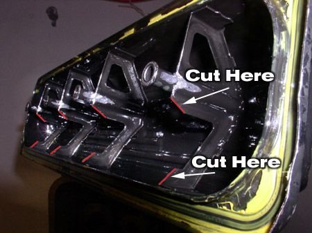

Crane Gold "narrow body (3/8"), same as GMPP, are plug & play for center bold VC. Comp Pro Mags and others require minimal cutting of the drip baffles (pic) or "bend" them out of the way. Very simple mod. Cut on intake side

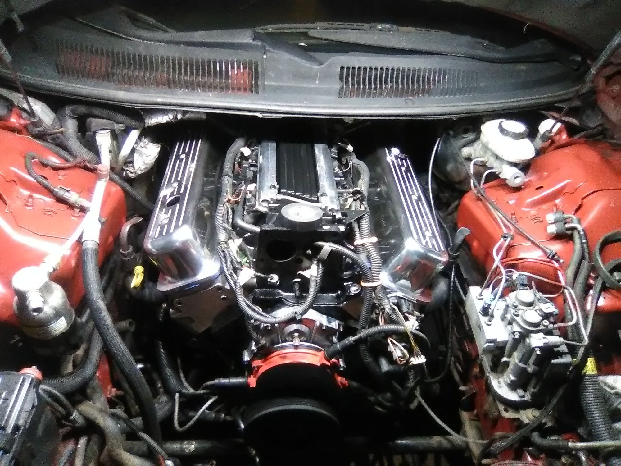

update i removed the cheap ebay rockers which were the procomp 1.5 roller rockers and replaced them with a set of Comp Cams Roller Rockers Extreme Energy in 1.6 ratio and i used comp cams lash caps on top of the stems, i replaced the cheap 7.200 hardened procomp push rods with trickflow hardened 7.300 push rods, with everything in place my lifter is rolling on the exhaust valve just across the centerline of the stem, the intake side is rolling just off the centerline of the stem towards the exhaust side, the rockers are finally setting high enough they are not contacting the rocker stud to which they are sitting on, new problem, the billet specialties ball milled valve covers i had were too short, ordered a set of billet specialties TALL ball milled valve covers and everthing looks great now.
