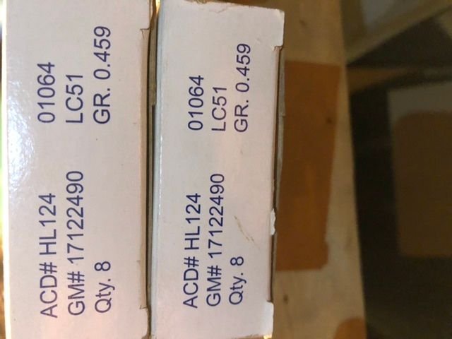

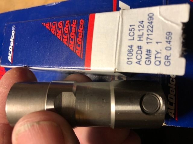

So, before you flame me, I have read quite a bit and am more confused then ever. I’m rebuilding a 96 LT1, and bought these lifters.... CHEAP. Are these the correct ones for my application? I was pretty sure they are, but, I would like some other opinions. Thanks🤙

Don’t know but 92-95 list a ACD# HL112 and 96-97 list ACD# HL123.

Seems to be a cheaper "LS7" lifter
https://ls1tech.com/forums/generatio...7122490-a.html
I would stay away.

I do not think their the "LS7" lifters people refer to, they are the cheaper knock off equivalaents to LS7s.
Either way. cheap lifters are not a good plan.

My understanding is that the LS7 lifter supercedes it's predecessors? His are AC Delco so not seeing how there would be an issue unless that's a known crap PN.

That was my thought, they are an AC Delco part, I wouldn’t think they would be “ cheap”

I had a set of LS7 lifters trash my engine. Some of the roller surfaces delaminated and wiped out the cam, which wiped out a lot of other things. I posted pictures on here a while ago. These were GM lifters. Loads of people say that the LS lifters are fine for an LT and maybe they are. It has been my own personal experience that they are not. Looking at them, you can also see that they are structurally different from the LTs. Most notably is the lifter cup itself is lower in the lifter body.
The correct LT lifter is GM part # 17120735 or AC Delco HL123

1. These are NOT LS7 lifters.
2. These are a 'universal' replacement GM lifter for mid-1980's small blocks all the way to the LS engine family.
3. They will work in the LT1.
