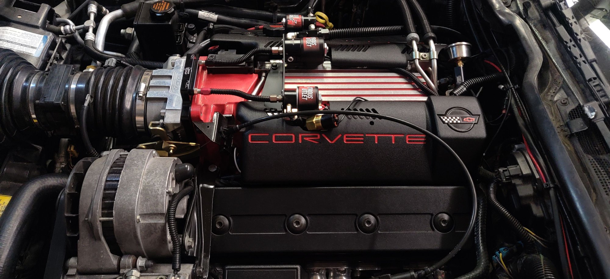

Where in the world am I going to mount the Coils? My nitrous kit is in the way. Open to suggestions!

First, you won't regret doing it. Best thing I did to mine. I went with valve cover mounted coils, but with your valve covers I think that might be an issue with not sealing correctly because of the how the bolts recess. Torqhead has a very nice valve cover bracket for the coils. My stock LT1 valve cover bolts don't recess like yours do, so the coil brackets sit flush on the valve cover. Just something to consider.

Paul at torqhead recommended running the LT1 bolts maybe using a washer to mount on valve covers. so we will see. I'll just have to get creative I guess.

A thin washer is a good idea. The install is very simple. I paid extra for the initial start up tune just so I could get it started. Mine fired right up, but was extremely rich. I didn't plan on driving it with that tune but wanted to at least have a starting point for my tuner.
