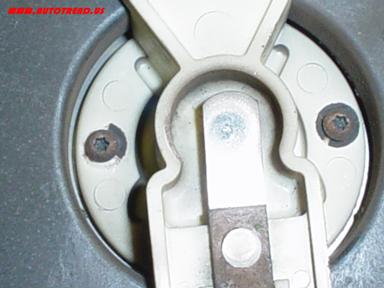

Another very popular reason is due to the rotor screws backing out causing any cylinder to pretty much fire at will. It's very easy and cheap to fix, but most mistake this for a defective opti and throw it out.
I've had excellent luck w/ mine. I've had two since the car was new, still have the original and it still works. Only problem w/ the original is what was stated above.
Really it is the small washer that breaks, that falls into the optical path. The bolt naturally would back out by then however its not as normal as the washer breaking and causing the problem.
Here is a hint for you SS RRR, since you are a little slow and you will prolly try telling me I am wrong and making up stories.
I'm not sure if you're wrong or not. My washers did not break. The bolts simply backed out. I don't recall very many others reporting washer breakage w/in the last several years either. Good show you point that out. Keep your rage to one thread, mkay?

Make sure the vent harness is working and replace the cap and rotor before outright failure. I believe the majority of optis replaced were not actually dead but rather just wet or in need of a cap and rotor. ALL distributor caps and rotors are wear items just given expense and relative hassle to get too they are neglected on this engine.
