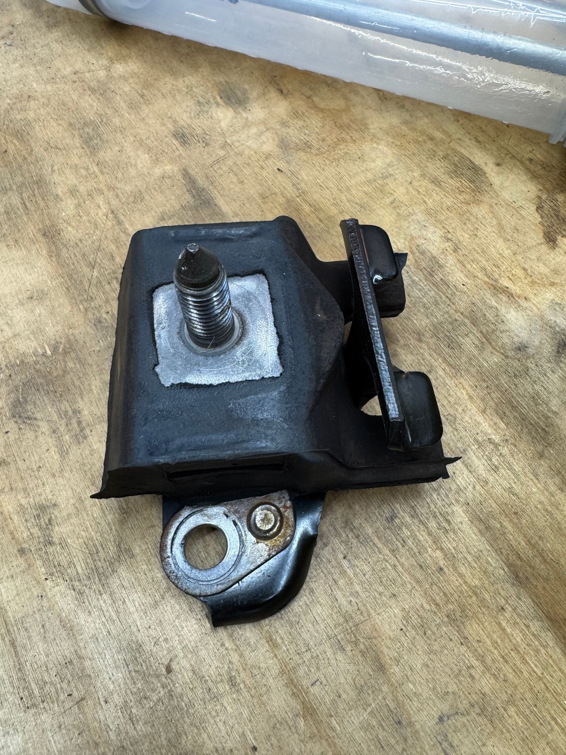

Replaced the trans mount, the old one seemed the same as the new one. Haven’t driven it with the new one so will see if it made any difference in the next few days. Pics of the old one I took off.
That is NOT the Transmission Mount, that is the one for the Torque Arm.
The Transmission Mount is under the Tailshaft Housing with two bolts that hold it and one bolt that comes through the Transmission Crossmember.
Might want to do some simple reading on what the components of these cars are.
Hate to break it to you sir but that is 100% the stock transmission mount. The threaded portion is a through bolt that goes through the transmission cross-member and is secured by a nut.

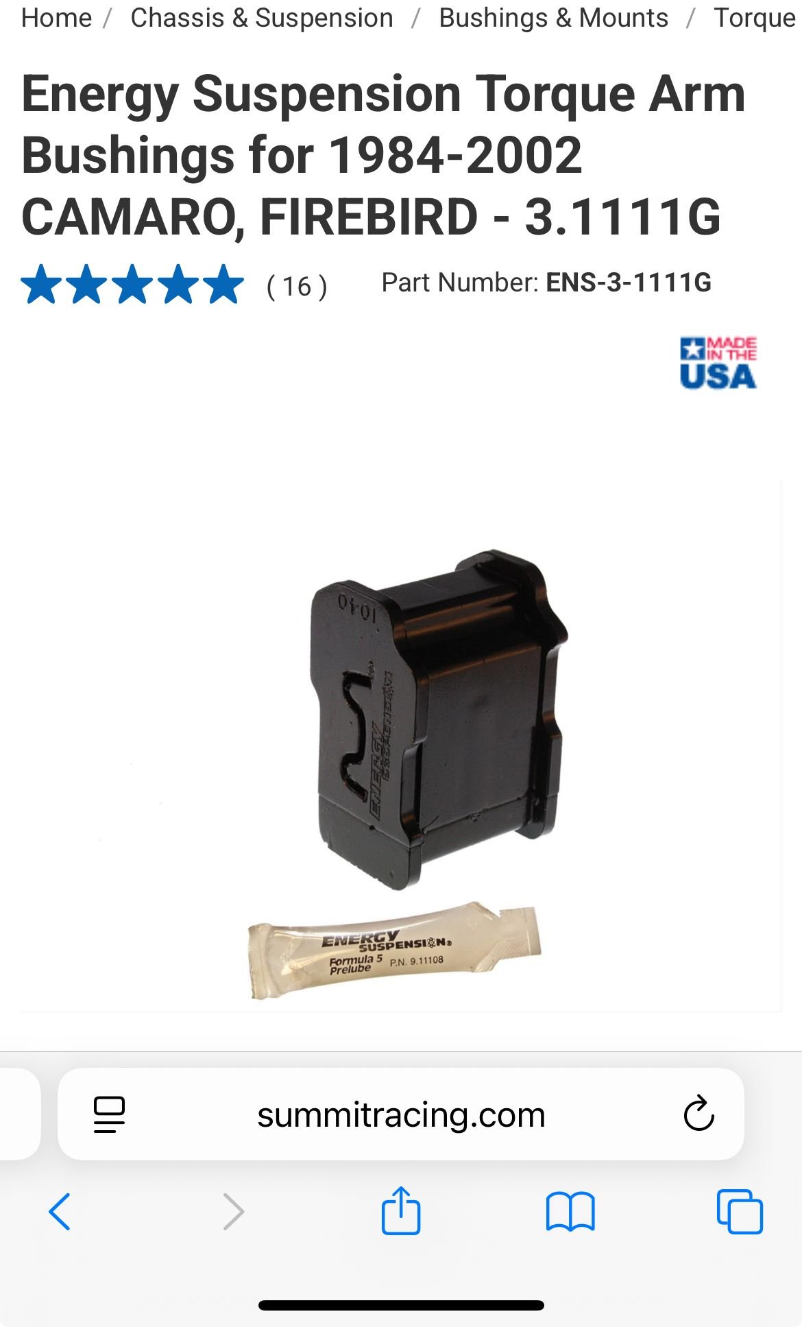

https://www.summitracing.com/parts/a...BoCW98QAvD_BwE
You stand corrected!
