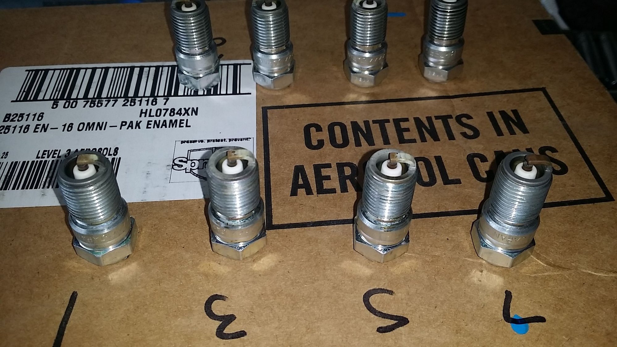

I have a Ls1 with a Super Victor intake and a 4150 plate kit .062n .046f. 91 pump gas in the main tank and have c16 in the stand alone system. The plugs are NGK BR7EF. The air fuel is rich wide band reads 11.0- 11.2, next night out I'm going to switch to a .043f jet. Total timing is 30 degrees I'm pulling 5 right now on the bottle.
I'd like some opinion on the spark plugs, The plugs aren't 100% clean, they only have 1 full pass on them, but I did brain fart and idled the car as I loaded and unloaded it off the trailer before pulling the plugs.
Here is a closer picture of #7 it look a bit different from the rest.

Is there any way that you can cut the threads off the plugs and expose the base of the porcelain. Do you know if you have a 1st gen Stinger or 2nd Gen?

Can you tell me a little bit more about the motor? Is that a 7 heat range plug? I'd like to see the porcelain on #7.

Don't like the specs on 2,3,4,5,6,7, and maybe 8 ?
7 looks to be hotter than the rest (gap the same ?)
Magnified to 450%...looks a little lean (but pic isn't that great at that %)
Can you take pics in the macro setting ?

I have too much idling and driving around time on these plugs, to be very useful now. I'm going back out to the track Sat. night, I'll make a run and pull them right away.

All spark plug gaps are the same .032, I checked them all before I put them in the engine.
I have no idea what macro setting is.

I went back to the track last night, Everything remained the same except I pull 1 more degree of timing. Stand alone fuel psi was 6.5, .062n .046f. 91 pump gas and c16 in the stand alone system. The plugs are NGK BR7EF. Total timing was 30 degrees I pulled 6. No idle this time, shut it down and pulled the plugs
Cyl #8 was the hot one
Fuel ring is light on a couple plugs

I think the tune up looks good. It's on the verge of needing a #8 plug. Cylinder 5 looks to actually be a little leaner than 8 even though 8 has a more defined timing mark.
It was a little low on fuel pressure for the .046 jet. I thought it was set at 7psi but turned out to be 6.5psi. So I adjusted it up to 7.5.
