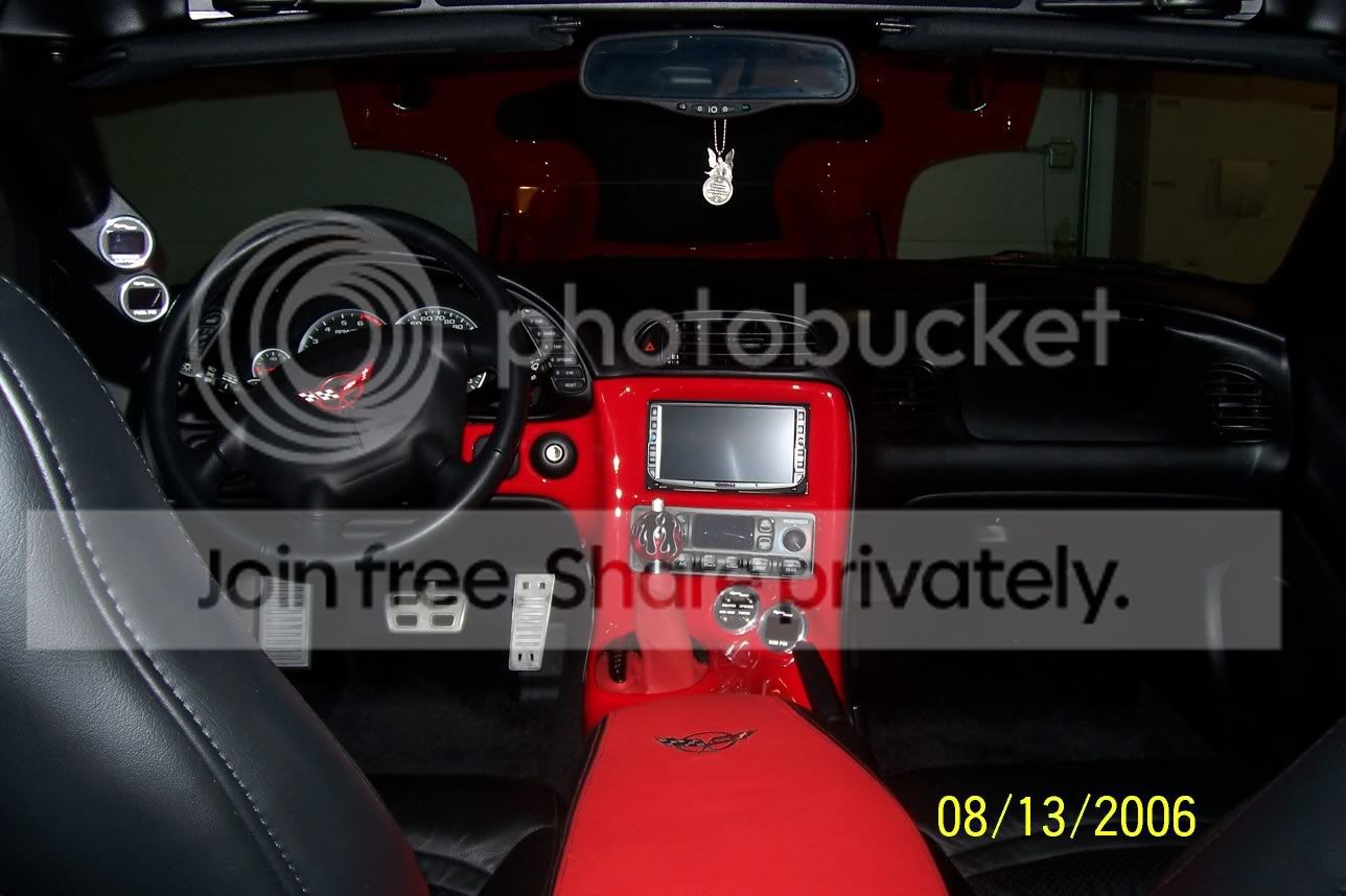

I am using the kit that dyno tune sells. I switched over to all there guages. In the process of adding the second wideband to monitor the left bank. If you want a peace of mind while usinf the spray I would suggest getting 1 or 2. Here's a pic of the interior so far.

That is exactly what I want to do with my piller. That way I can monitor the A/F and fuel pressure.
What do those gauges monitor? Obviously the A/F, but what else?

On the pillar right now is A/F (right bank) on top and fuel pressure below that. On the console in the swicth center and nitrous pressure to the right. The pod is autometer. I could not get a triple pod for my year so the new set up will be, A/F (left bank) on top and A/F (right bank) on bottom of the pillar. Then I will relocate the fuel pressure and switch it from a round gauge to a rectangular one and have it recessed in to the console to the left of the switches, in front of the shifter.
