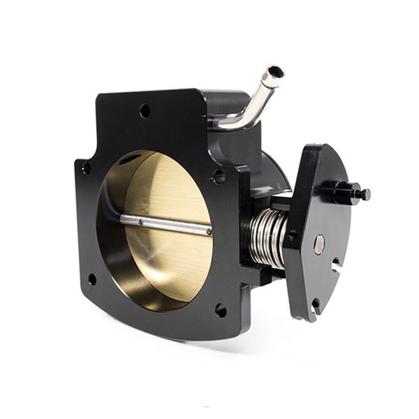

Most street TBs have a sort of "snail-shaped" place that the cable runs in, such that at small openings, a large amount of cable is required to move the TB very much, but at larger throttle openings, the diameter is smaller, so that progressively more throttle movement occurs for a given amount of cable movement as the throttles are opened. Is your TB set up this way?

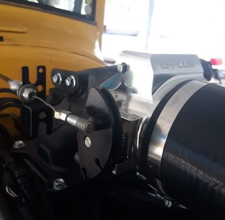

It has the typical "D" shape, like so. But I am using the trans kick down kick out on teh RH side of the TB. I'd assume I'd be better off using the barrel/cable style mounting point. But the old cable literally mounted directly up using the kick down to the RH side of the TB. I'll get a pic of mine up soon.

That cable mount point is right next to the central pivot shaft. If you move that cable out to the edge of that circle, the same amount of pull will result in less throttle opening.

You have very low resolution of throttle control with the cable in that location. That 100% is the issue without even the slightest doubt. Need to redo the throttle cable and run it in the groove as intended.

Absolutely redo that cable mount. A piece of gravel could have you smacking full throttle with that setup. I was going to recommend a more eccentric cam sort of setup until I saw that you already have one that is not being used.

I just slid a barrel style cable in the existing cable sheath. Using the lowest hole now. Worked really slick and its 100x better. Thanks all.
