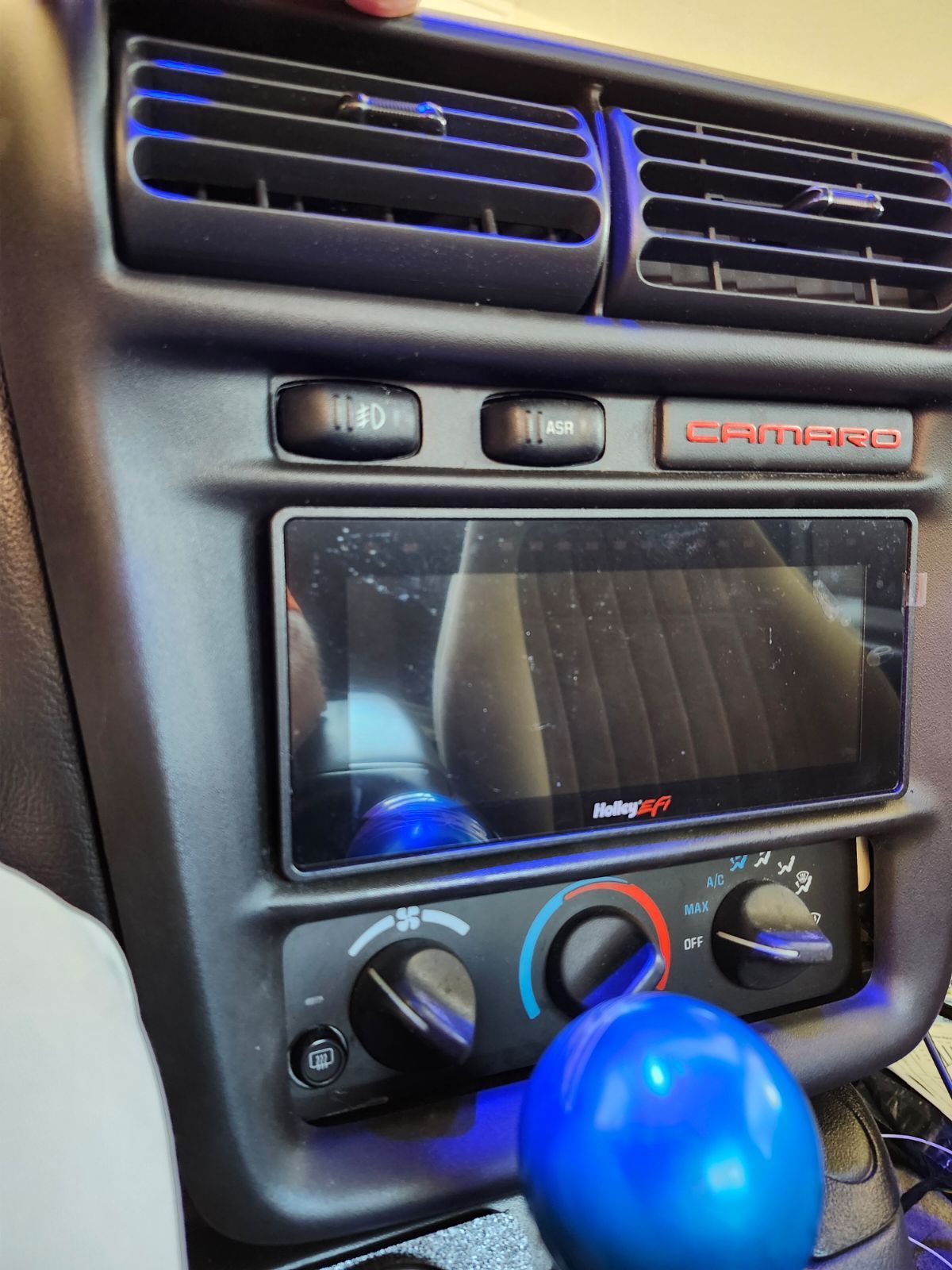

I have the Jolt system harness installed in my 2000 Z28. Install was time consuming but not really complicated. You will need to clear the codes on the stock ecu to get the stock gauges to work. I’m running the stock gauges and I have the 6.86” digital dash mounted where the radio was.
