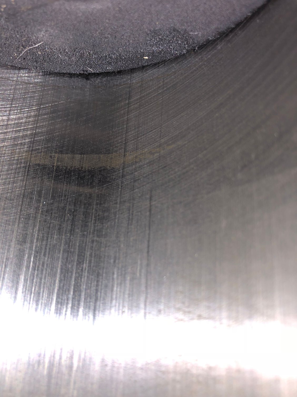

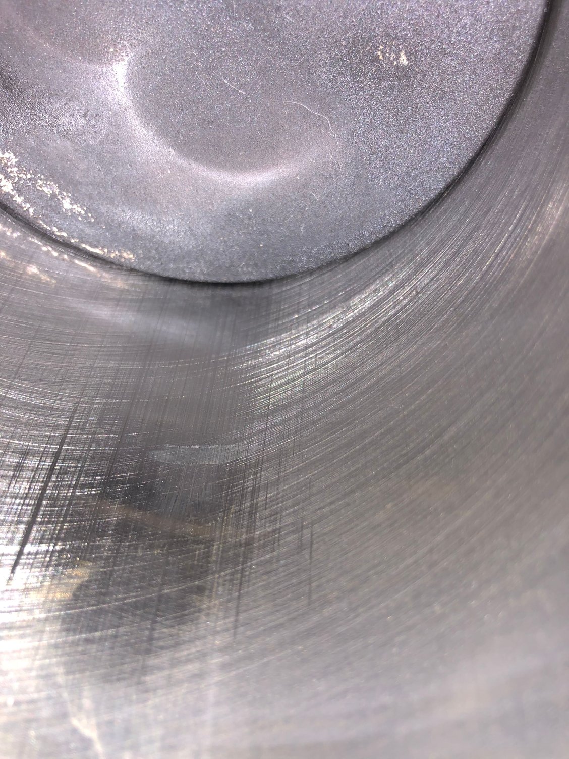

I dont know how else you explain the cylinder walls looking like this with less than 200 miles on the engine. It fouled out plugs and ran like crap. I ended up finding a tuner in Australia that is going to help me out with the start up tune when I get the 416 back in it. So ill repost in here with the results.

Why do the tops of your pistons look like they've been shot peened? Are you sure that it was fuel wash that screwed it up, not detonation?

that was all the carbon on the top. Theyre the normal wiseco piston finish not shot peened. Id be on the road a long time ago and it might not have cost me an engine if i had gone with a holley so support means alot especially if you plan to push it. If it ends up running poorly and im not satisfied ill take it out and sell it all, im done playing around and want to enjoy my car
