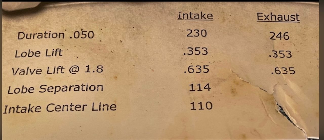

When does it do it? Idle, driving?
Just about every cammed vehicle needs the misfire tables adjusted at idle/low speed depending on how big of a donkey dick cam you have. The "chopity chop" from the cam makes the PCM thinks its missing.
However, IMO, it's a bad idea to max out those tables and turn the DTC's off becacuse if you ever have an actual misfire, it's not going to throw a DTC.
Something else you can do, even if the DTC's are turned off, you can log each cylinder misfire counter in the HPT scanner and see which cylinders are showing misfires.
You mentioned that you tuned it to a 14.7. Is that at idle or cruise or both? With something with a big cam, they run better if they are a little richer than stoich at idle. The other thing with a big cam, you can't really trust the WB at idle because if the cam has a lot of overlap, the WB is going to "show" rich.
Thanks for the reply LilJv10
So it does it when just normal driving really not even getting on it or anything. Never seen it come on at idle at all that i noticed.
AFR is 14.7 All around for 90% or better of the time minus when i get in it of course And yes when cam is Choppy at idle AFR will dip rich some not to bad though corrects quickly..
CAM Specs - attached
I have logged each cylinder for misfire in hp tuners and all seem to be about the same. But I need to do some more data logging tbh and note when it comes on the CEL so i can review that part of the log.
Thanks again for thoughts and suggestions!
Chris
