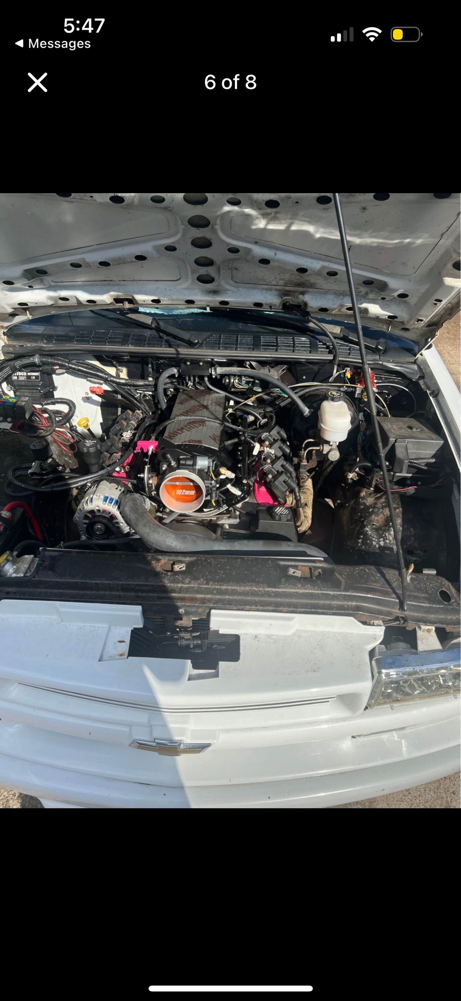

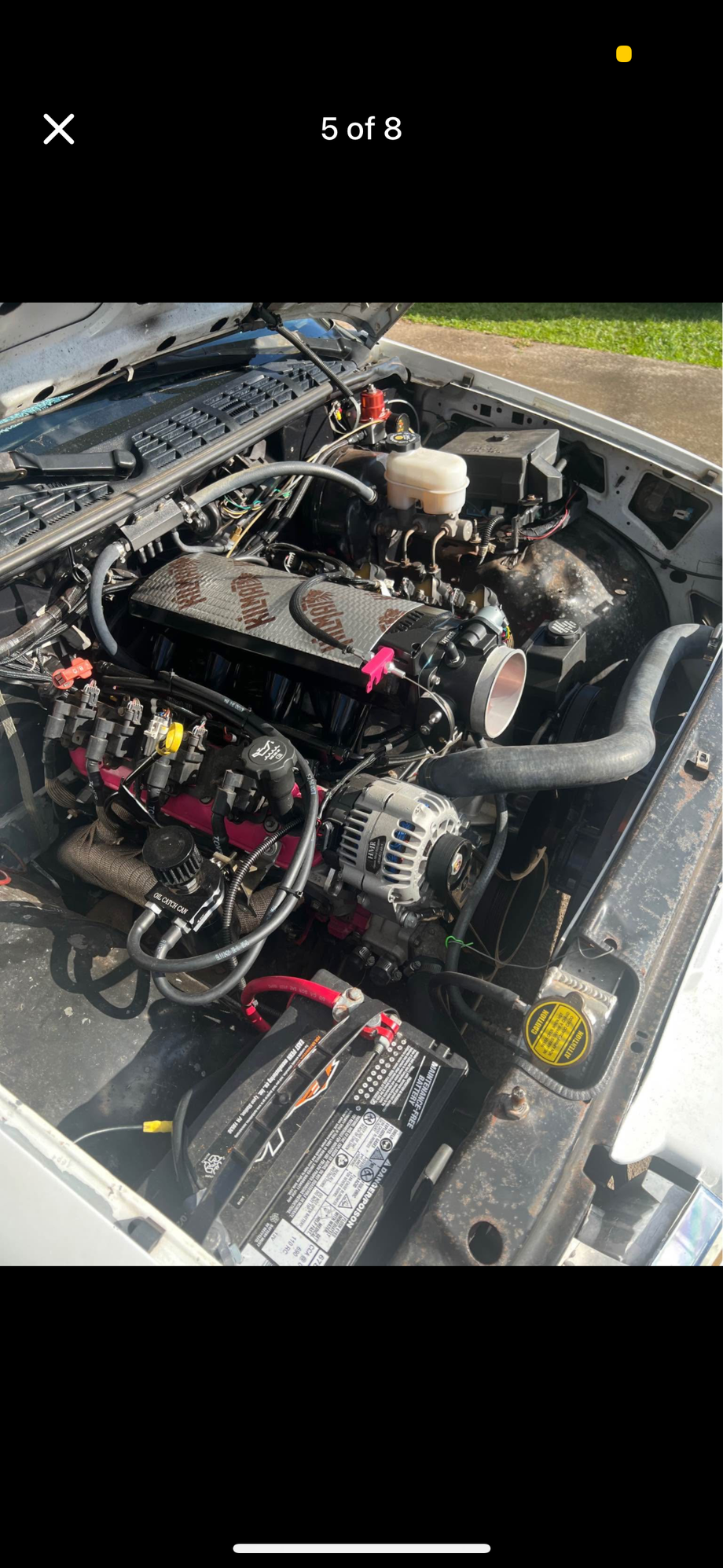

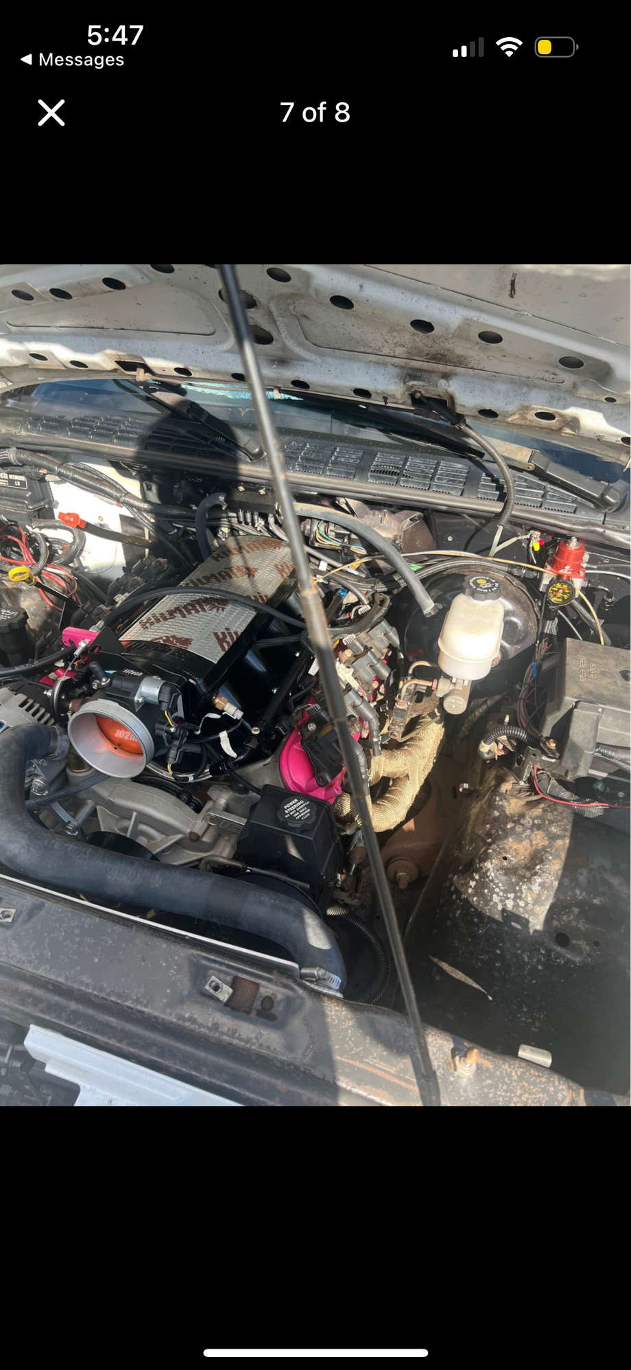

What's the model number on the Fitech?
Some good pics of the set up would/could help.
You have the Fitech software on a LT?

it’s the 79009 750hp kit
