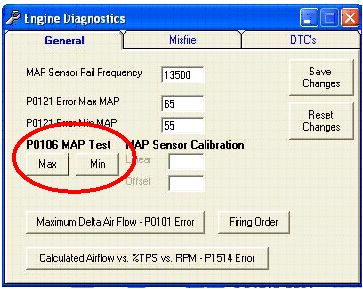

It is a P0106 code. Same MAP immature or something code he has had since the cam (MS3) went in. It stop setting after a while, but came back after I used HPT. He has swapped the MAP sensor and everything, nothing fixed it. I assume the MAP Fail would go to SD and I can say, his SD has never been messed with. What you think Mike?

I used to have a MAP code when I swapped in the TSP 231/237 cam, I had to adjust the Min.Max MAP values (raised them to 75/85) and no issues since. He has had this error since the cam, btw the MS3 is huge, checked all electrical, swapped new sensor in etc. It did eventually stop throwing the SES light, but the code was still stored in the PCM when I scanned it. I was running fine. Then I threw the HPT tune in, only adjust the min/max values, and timing for high octane (more nitrous friendly), cleared the code during the idle and it stumbled, caught back on and then runs like ****. Stumped.

you need to get rid of the P0106 code if the MAP is actually working. The PCM checks the MAP duruing part throttle/idle. It expects to see a value within the range shown in the editor if it outside of that P0106 will be set and the PCM will disable the dynamic airflow calculations completely and use the MAF only. If your are already MAFless then it will switch to Alpha-N (MAP estimation based on TPS and RPM). If you have a large cam then either of these problems will most certainly cause the car to run terrible.

Is there a way to keep the MAP P0106 enabled, by adjusting a value or something, like the MIN/MAX MAP values in engine diagnostics? Making Min lower than logged readings and MAX higher than logged? The car in question is still using MAF and I am sure the airflow tables are off since they havent been touched from stock and this cam is big.
yes it is likely you will have to increase the maximum MAP values so that the MAP is never higher than these values for the given TPS and RPM point. To effectively disable the check you can set the whole Max table to 105 kpa.

Are you talking about the MAP under Engine Diagnostics, showing the MIN and MAX, stock I believe is 45/65 or something, or you talking about something else?
