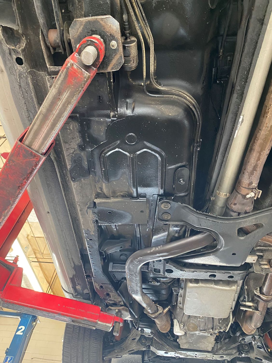

The red SFC under the doors also amp up the perception of luxury as you have no rattles or funky noises

Default Convertible only K frame brace
For the ignorant who insist there is no difference between the hardtop/T-Top car and the Vert. 2001 SS convertible, which also has a multi-points tunnel brace, unlike the other cars, both OEM. NO 3-point SFC can fit because the chassis also has an OEM connection from the tunnel to the outside edge. A welded in box on both sides that makes it impossible to fit most aftermarket SFC/s.
Old Aug 22, 2023 | 02:08 PM
LSX Thunder's Avatar
Joined: May 2023
Posts: 393
Likes: 55
Please look at the oem tunnel brace rear attachment points. NOTHING like that is on any 4th gen HT or T top. Which is why almost all the after market SFC makers say NOT for convertibles.
Unique to 4th gen vert
OEM extensions block both sides
vert only
