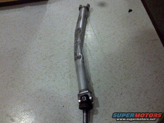

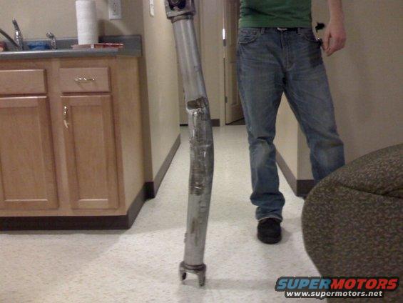

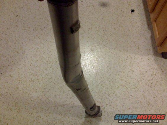

So for everyone out there thinking about lowering your car. Heres a little something to think about. I made the mistake of lowering my car with eibachs pro kit and not installing an adjustable pan hard bar to recenter the rear end back up.
So this is what happened to me at about 110mph on my way home for lunch today. So definately buying an adjustable panhard bar now. This is just a warning not sure if this will happen to everyone but it def. happened to me and i ve only had my car lowered for about 6 months. Pretty much the U joint just exploded because of the slight angle that was put on it from the rear end being off centered.
Oh yeah PS= driveshaft loop is def. next on the list also!

his driveshaft is trash haha. we were just looking at the rear end the other day for making a noise and we figured it was the u-joint, guess we were right. o ya the rear floorboard got smashed up as well, time to pull out the big hammer...

All that from the rear end being over 1/8"?

polish that thing up and mount it on the wall as a trophy!

yes that driveshaft is definately gettin mounted on my wall of shame. I do think that my u-joint did have something to do with it, i bought them from advance auto about 6 months ago. Im not really that pissed off that i broke my driveshaft, im more pissed off that my drive shaft came up and hit the underside of my rear passenger seat and left a dent the size of a watermelon so now i need to get that pounded back out.
