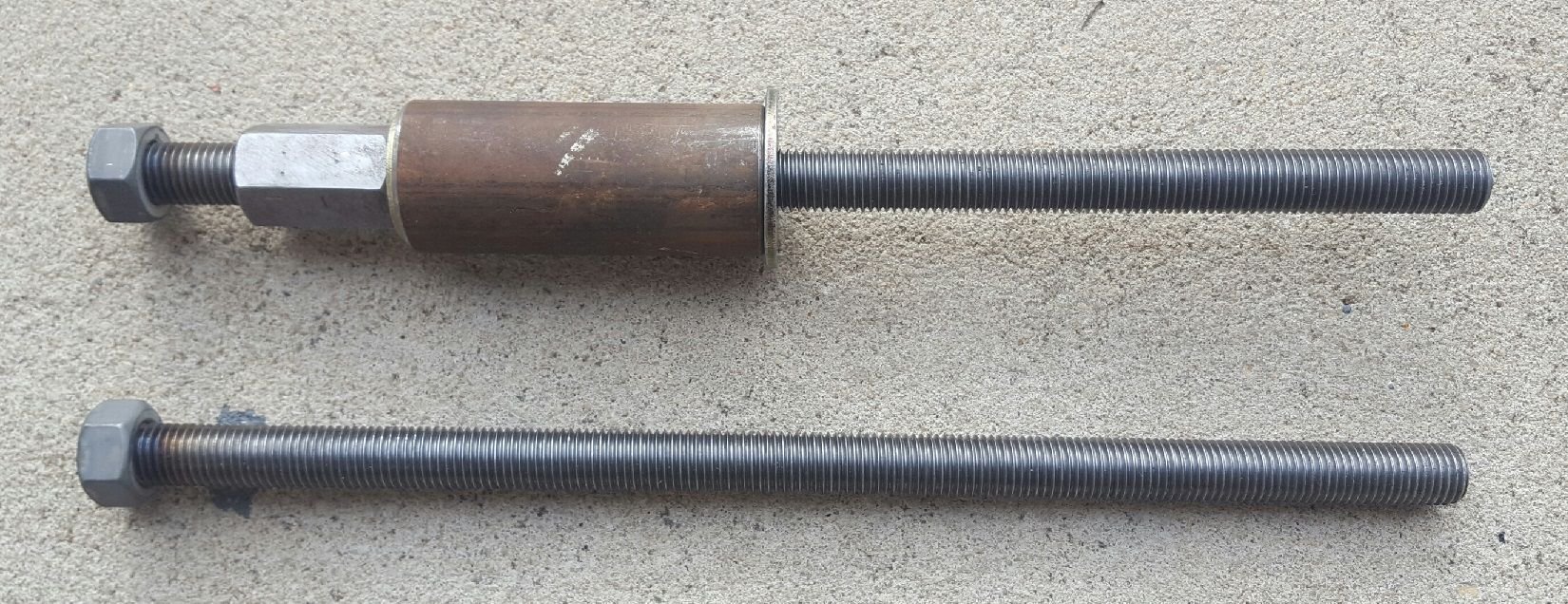

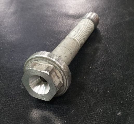

I've made some and bought some. Never needed the alignment tool, there's a way to do it without it.
Made these here for Balancer removal and install. Old Crank Bolt as a piece to push against with the puller..
Made the Balancer Install Tool, and a spare..

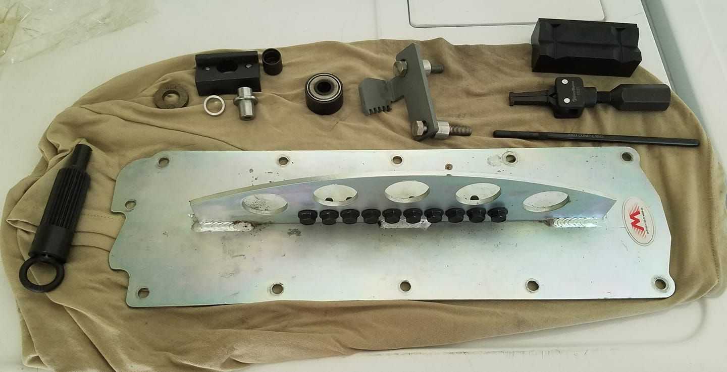

Bought all this local from a guy for $100. LS Engine stuff.
Engine Lift Plate, Crank Holder Tool that bolts inplace of the Starter, Pilot Bearing removal Tool, Wheel Stud Install Tool, Pushrod Measuring Tool, Vise Blocks and a Rocker Trunnion Install Tool. Clutch Algnment tool was in it, those are cheap I use a junk T56 Input Shaft for that.
