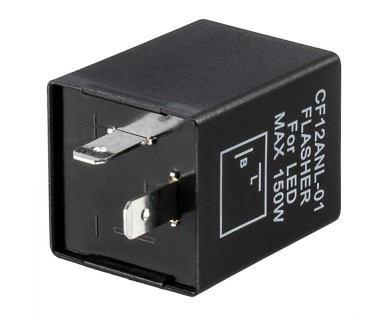

Old Feb 11, 2019 | 08:44 AM
insidethreat07's Avatar
Joined: May 2011
Posts: 253
From: Ohio
This is the flasher I bought, No issues you wont have the clicking sound when the turn signal is on though
CF12ANL-01 LED Bulb Electronic Flasher
Last edited by WhiteBird00; Feb 11, 2019 at 08:51 AM. Reason: Replace non-sponsor link
