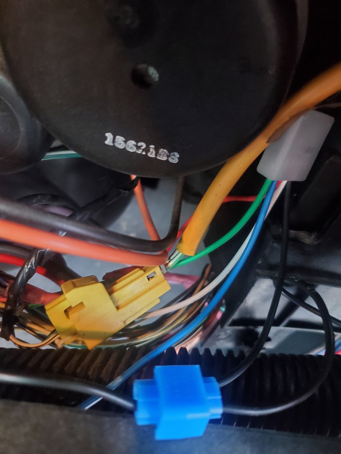

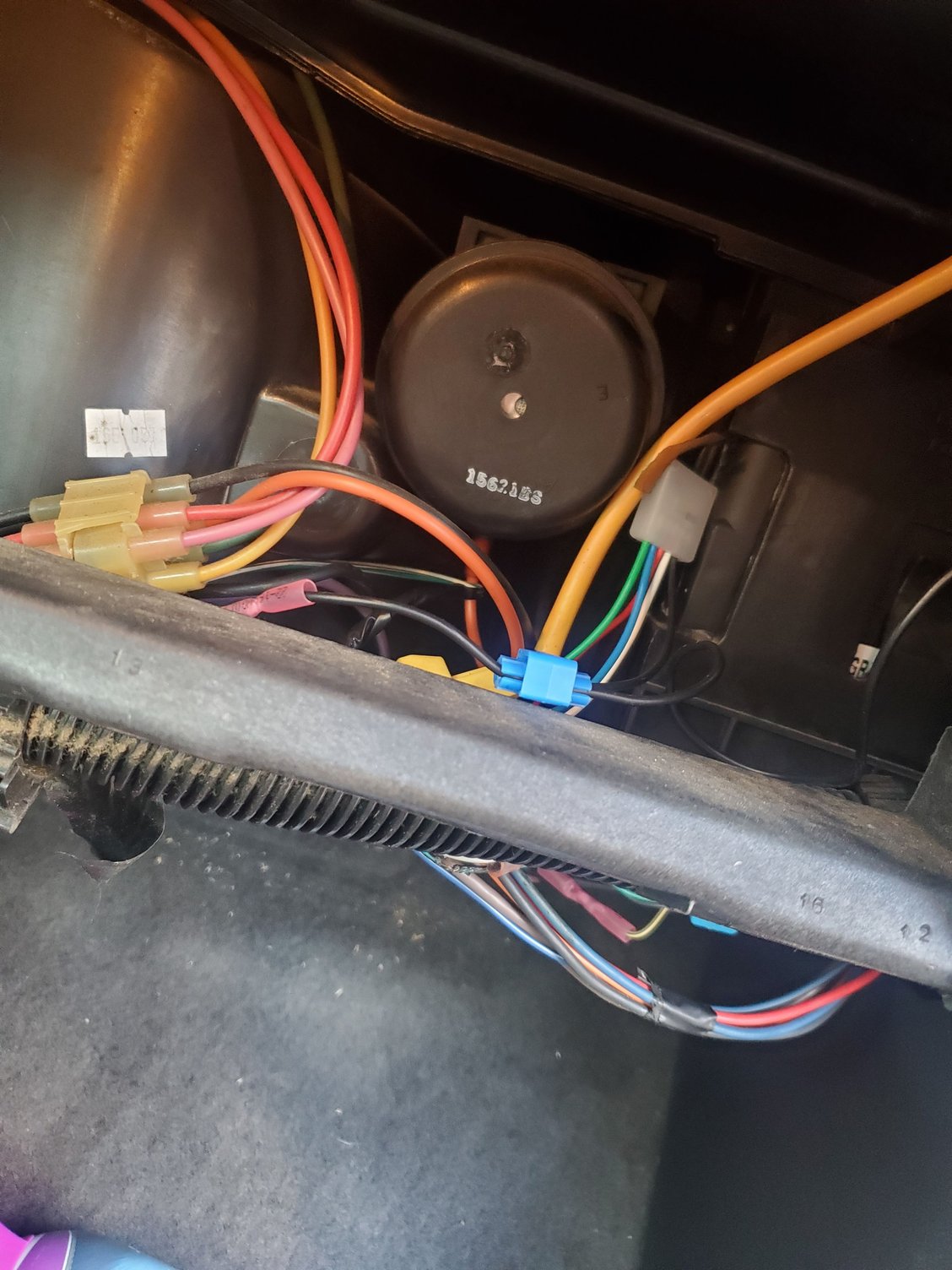

This is the bypass module thats wiring into the BCM
This is the bypass module thats wired into the BCM

As far as I know that bypass module is the only aftermarket thing in the interior, I've looked under the steering column and obviously behind the glove box. The only thing that was suspect under the steering column was the VATS wires being cut off. Everything else seemed to check out to me.
