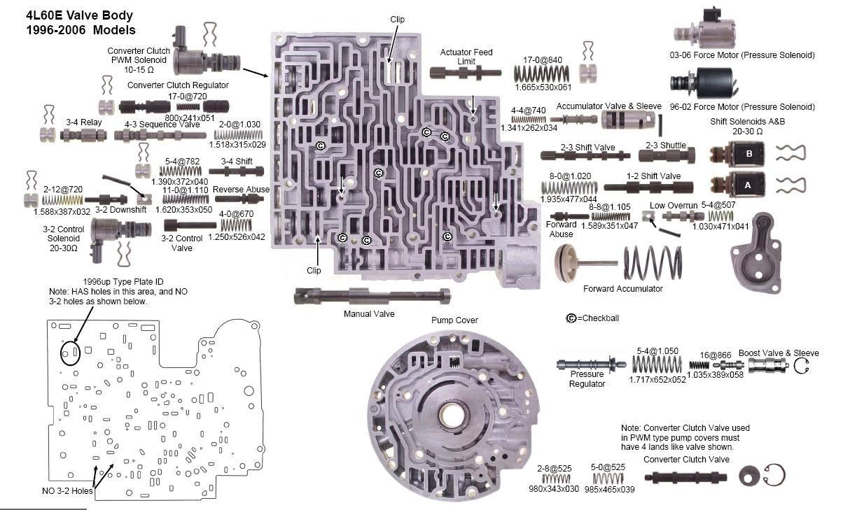

I can weld some tools like the link provided if needed.
Seems most issues are from reading
1) Checkballs in VB and 2nd gear band
2) OEM sunshell
3) 3/4 clutch packs
4) bearings in pump
If I have to rebuild it I will ........ just didnt plan for it in terms of project. I think I could do it with video just replacing everything AS IS
where it gets hard (I think) is when you make adjustments to improve it - use different clutches/seals/components oustide of stock kit. Gets confusing and requires knowledge.
Obviously this is all with 10 mins of trans knowledge
