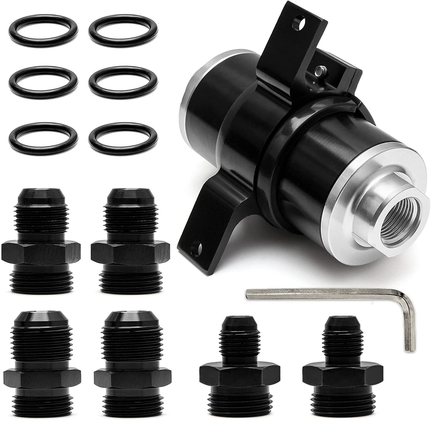

Can this filter be used as an external filter?
Old May 13, 2022 | 08:11 PM
matermark's Avatar
Joined: Jun 2021
Posts: 314
Likes: 17
From: The Niagara Frontier
Default Can this filter be used as an external filter?
It comes with o-ring boss fittings in 6AN, 8AN, and 10AN, and machined ends and it's body is about 4.5" (plus ends) and about 2.3" diameter...
Amazon Amazon
I don't know how 100 microns would work or if there are flow restrictions with something like this...
Any help is appreciated.

Originally Posted by bbond105
Why would you?
To catch any metal particles I, or a trans installer, couldn't get out of the radiator before they got to a new cooler/new trans... wouldn't that also help if I have to do a temporary line or bypass to get it movable just with the burnt trans using 1st-2nd but have the cooler installed & plumbed taking a 3rd party out of the equation? It's washable & reusable, and it's like buying the fittings and getting the filter/billet housing/2-day delivery/mtg bracket for free...

Did you see the filtration surface of the main filter?
if that little sh*t you posted here gets clogged, the tranny youre building here for about 2 years and 400+ threads will starve and die within a month of use by the clutch material if you use it on some high quality connections, if no, some hose is gonna blow up on you. And all of the golden tips and directions of Maroon, bbond, vortec and others will be a waste... 😤
Just get yourself a high quality main filter.
Or, you can use it to filter the brown color out of the original pink color of your ATF 🤭
That's good to know if you think it'll get clogged too easily. Is it because the filter part is only 4.5" or because of the 100 micron? I thought 4.5" is pretty large (for a fuel filter.) They also make one in 30 micron...
I thought some people here used remote/inline filters too... no? I can't just get a "high quality main filter" because I'm talking about the existing trans--there's no way I'm dropping the pan. But I'll use a quality filter in the new one if I don't have one in the kit.
Thanks Ed.

I have seen remote trans fitters before, but I don't have 1st hand experience using one. If I understand correctly, you are using the filter to move the vehicle around for a short time to keep debris from the old trans out of your new lines and cooler, then I don't see any harm unless the filter is too small. You will have to do your research on that. After you get your rebuilt trans installed do you plan on leaving the remote filter installed If not after all the trans line and cooler post are you going to redo the cooler lines again with no inline filter?
I haven't decided yet but if beneficial I would keep it. I may have found someone to install the transmission but I would want to be there. I'd like to eliminate any additional work for them by having everything in place or proper lengths etc. I still would need to DRIVE it to them somehow. It's in the early stages of ironing out a deal and may have them install the AC-Delco steel lines at the same time as the transmission, maybe the cooler too if I didn't install it yet, depending on the price. I may be able to get everything done for around 400...
