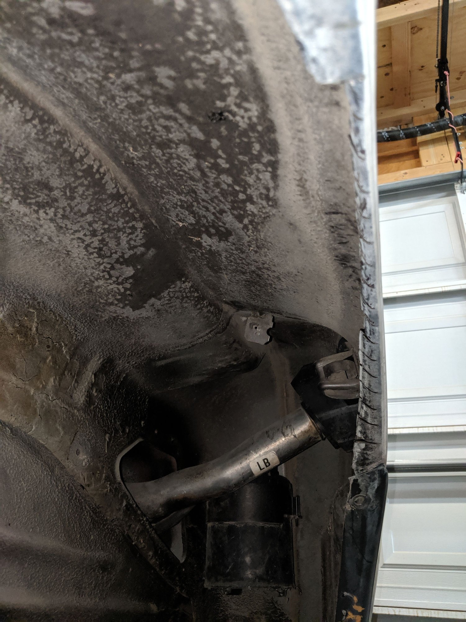

Working on the rear of the car for a bit now, I installed the urethane bump stops, sway bar endlinks, removed the stock exhaust and starting rolling the rear fenders for the future 315's. I want to do this now before the paint work and Im right there anyway.

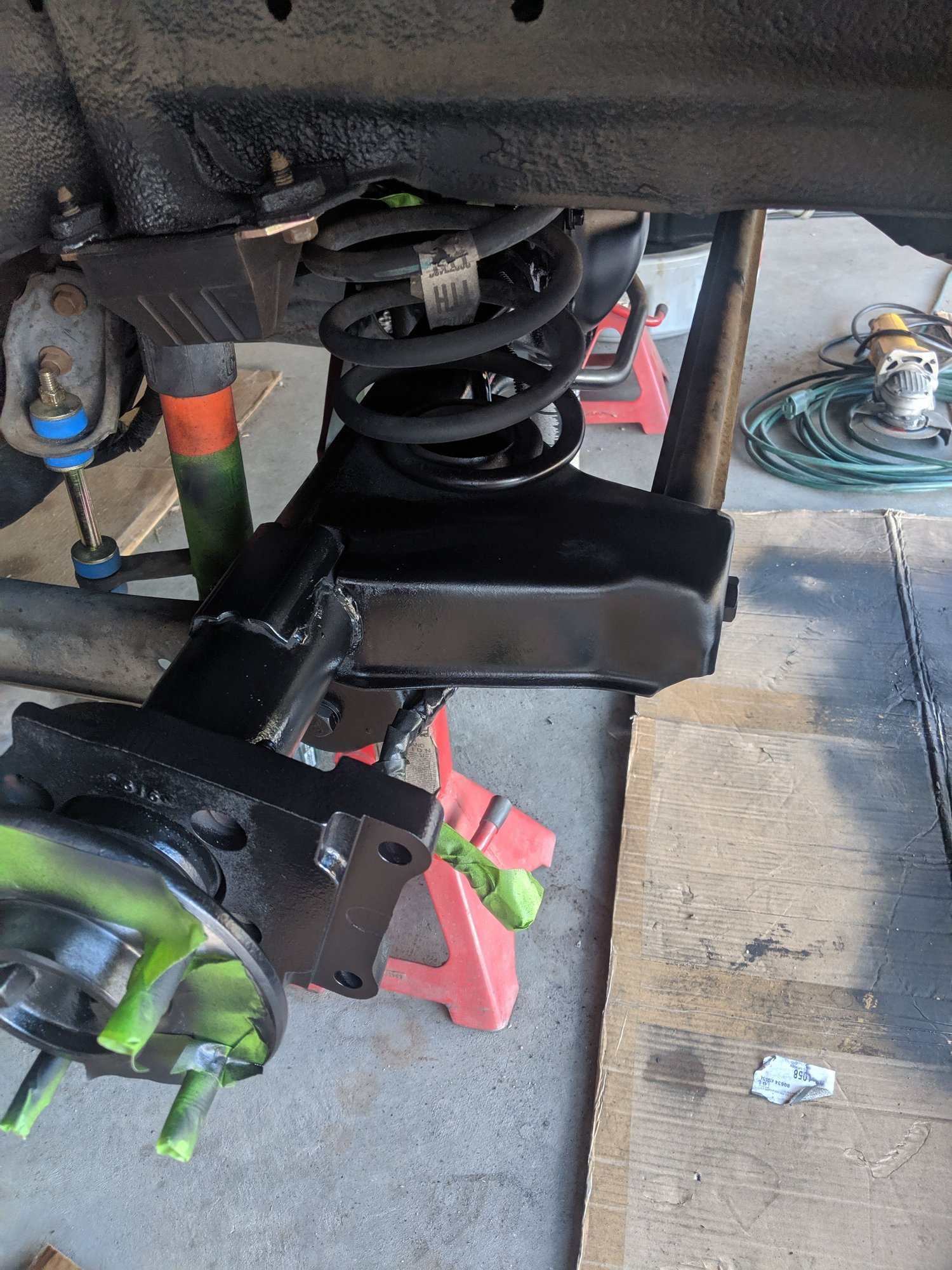

I tore the rear axle down lastnight, prepped and painted the drivers side of the axle. I couldnt wait to install the new brakes, so I threw the drivers side on. I think the outer pad is a little too tight, so Ill probably take it back apart and sand off some of the powder coat on the bracket.

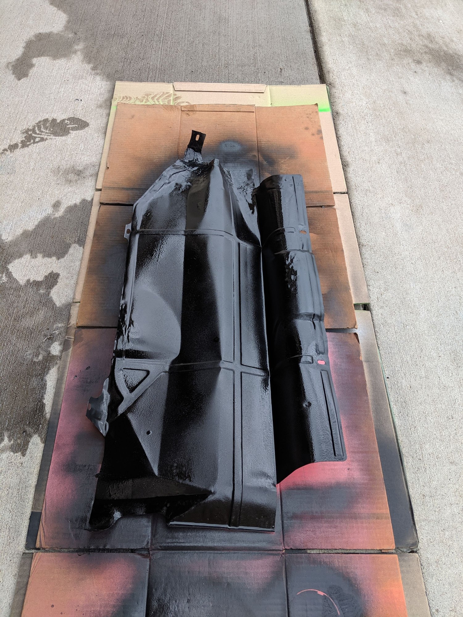

I pulled the gas tank heat shield for cleaning/reconditioning. It is/was pretty mangled up, I straightened it out as much as I could, should be ok I hope. Then I washed it off, scrubbed it down with SOS pads, used the wire wheel, applied sound deading material on the back side and then spray bedliner to seal it all up.
Before:
During:

After:

Next up was installing the rear suspension pieces, so I grabbed the lower control arms and panhard bar. Nathan C was correct, the lower bolt (heim joint end) would not accept the factory bolt, I had to dig one out of my bin for the install.
