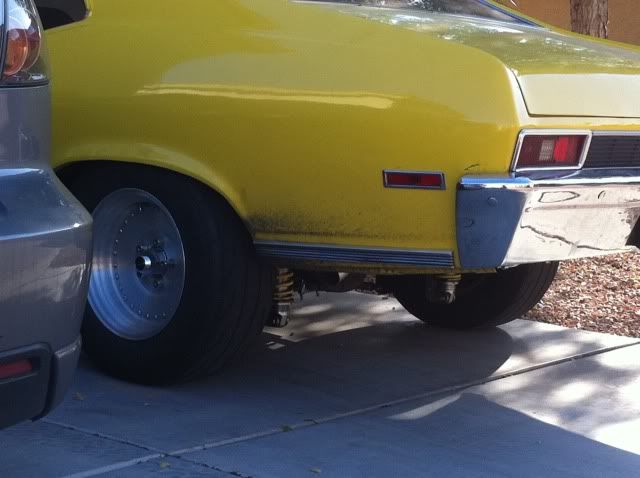

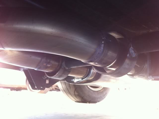

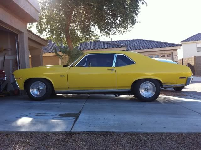

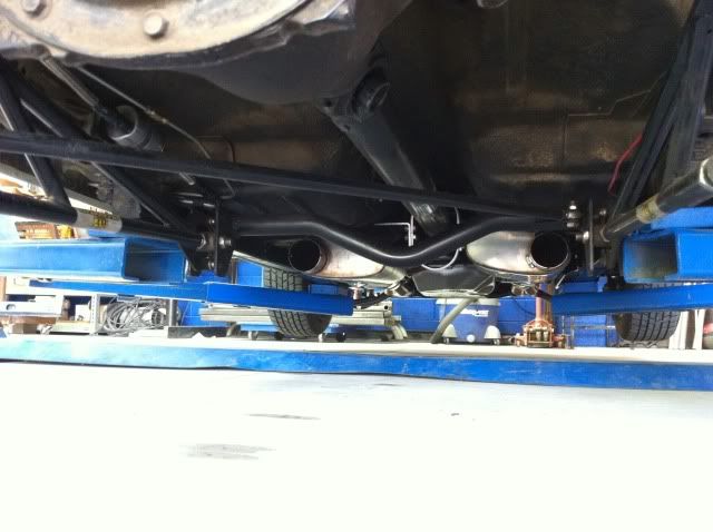

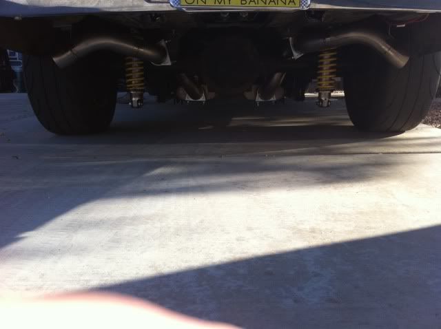

This update has been a looooong time coming. I just got the ladder bar crossmember modified with exhaust cutouts and the 3" Pypes Race Pro exhaust done. Man, it's nice to drive without ear plugs!
You can barely see the tip sticking out behind the rear wheel in the full-car pic. I like how it's mostly tucked under. The fabricator had to remove the diagonal link and install a panhard bar to run the exhaust (luckily I had one for it). I wish I could get rid of some of those clamps, but I wouldn't be able to remove the system if I had it fully welded. I'll accept some functional ugliness.
I also had some fun and scared the neighbors a bit. Got a 'talking to' for that one (and thus the reason I cut it short, so as not to hit the Nissan).

X-member before:
After:
Exhaust clip:

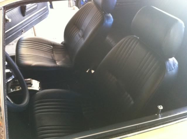

I also added some Procar bucket seats that I picked up from a friend since the last time I updated this thread. They're fairly tall, even though I made my own brackets. But they match the interior very well. Plus I got a pretty good deal for 'em. Adding AC will certainly make the car more fun to drive, which will help break those babies in.
