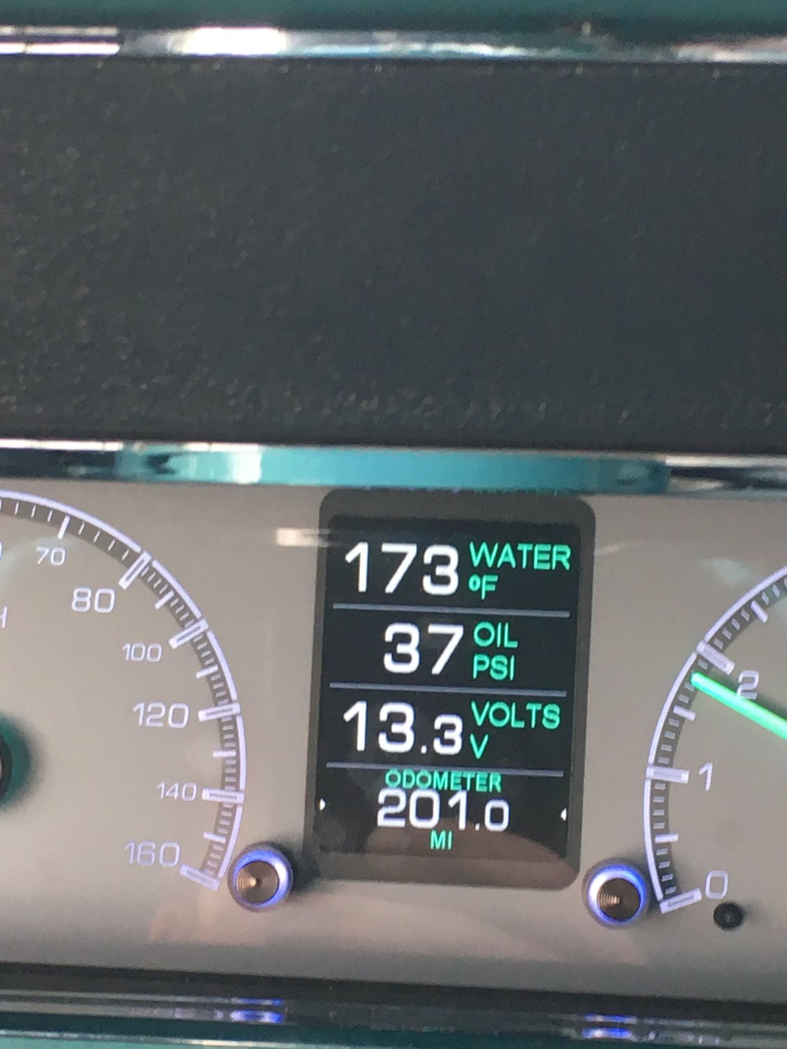

Drove home from the exhaust shop, 10 miles. Actually got it hot enough for a fan to kick on so that’s one less thing to worry about. I’ve got Viking rear shocks coming tomorrow, throwing those on and getting tuned next Friday. I guess that’s it. It’s a weird feeling. Being “done”.
Thanks for the kind words and help everyone.
