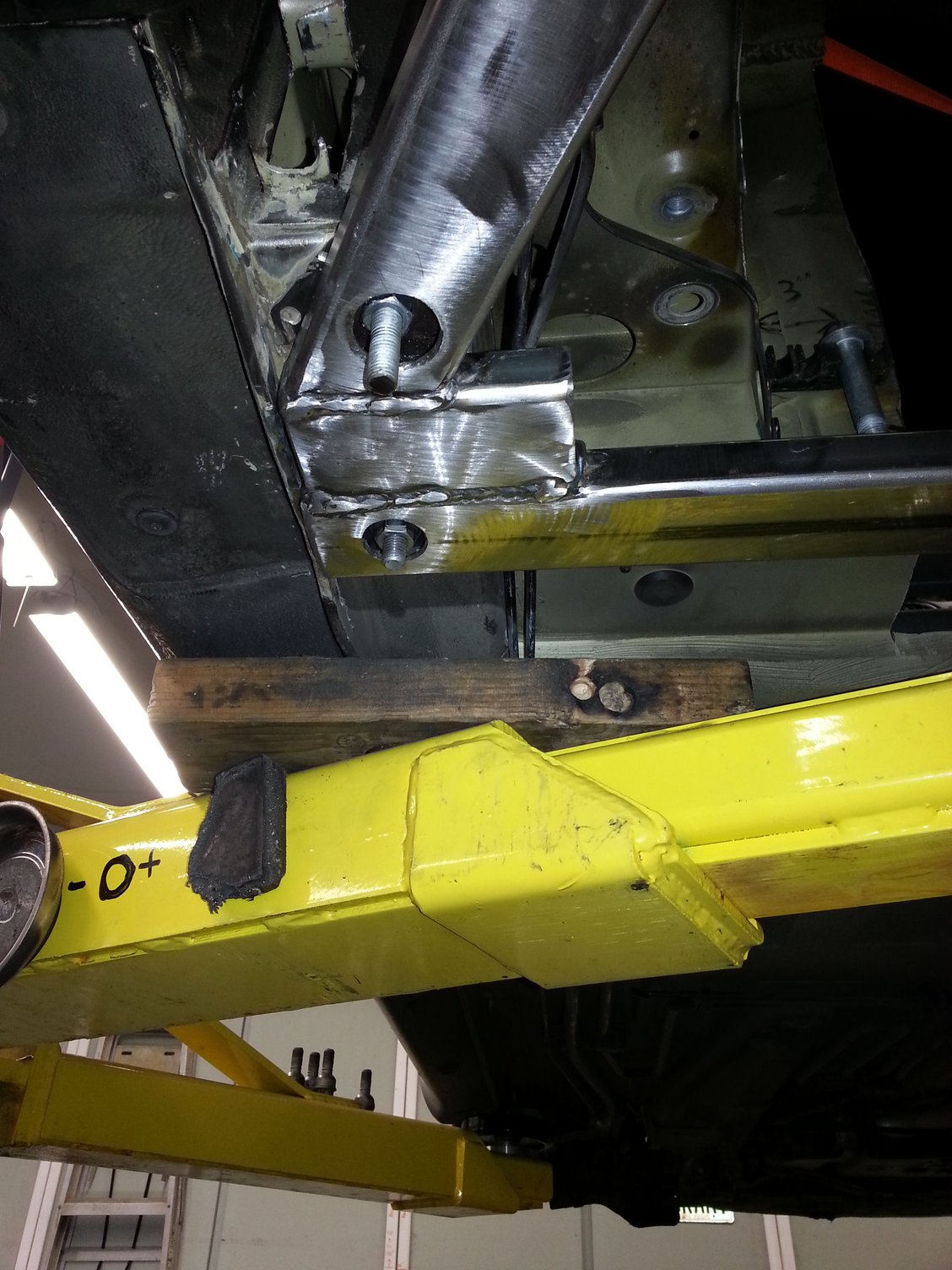

so this is a picture of the inner rocker panel shows the extra fastener employed to support the new engine package. I need a starter
ring gear don't have one as yet, funny it's not an easy thing to find separately !!!!!!!!!!!!!!! Any help ???
here is a picture of the fastener on the outside
another picture of the engine support system, its a busy place and hard to really see what's going on but its coming along.

So I've been looking around feverishly for a flywheel ring gear, can't seem to find just the ring gear !! I am reviewing conversion pictures of other Cayman LS swaps and come across a picture of a Cayman swap flywheel on a LS3. I see the LS3 flex plate ?? LOL For some reason I thought I would be using the Porsche ring gear !!!! Well now I know I have the flex-plate / ring gear I need !!!!

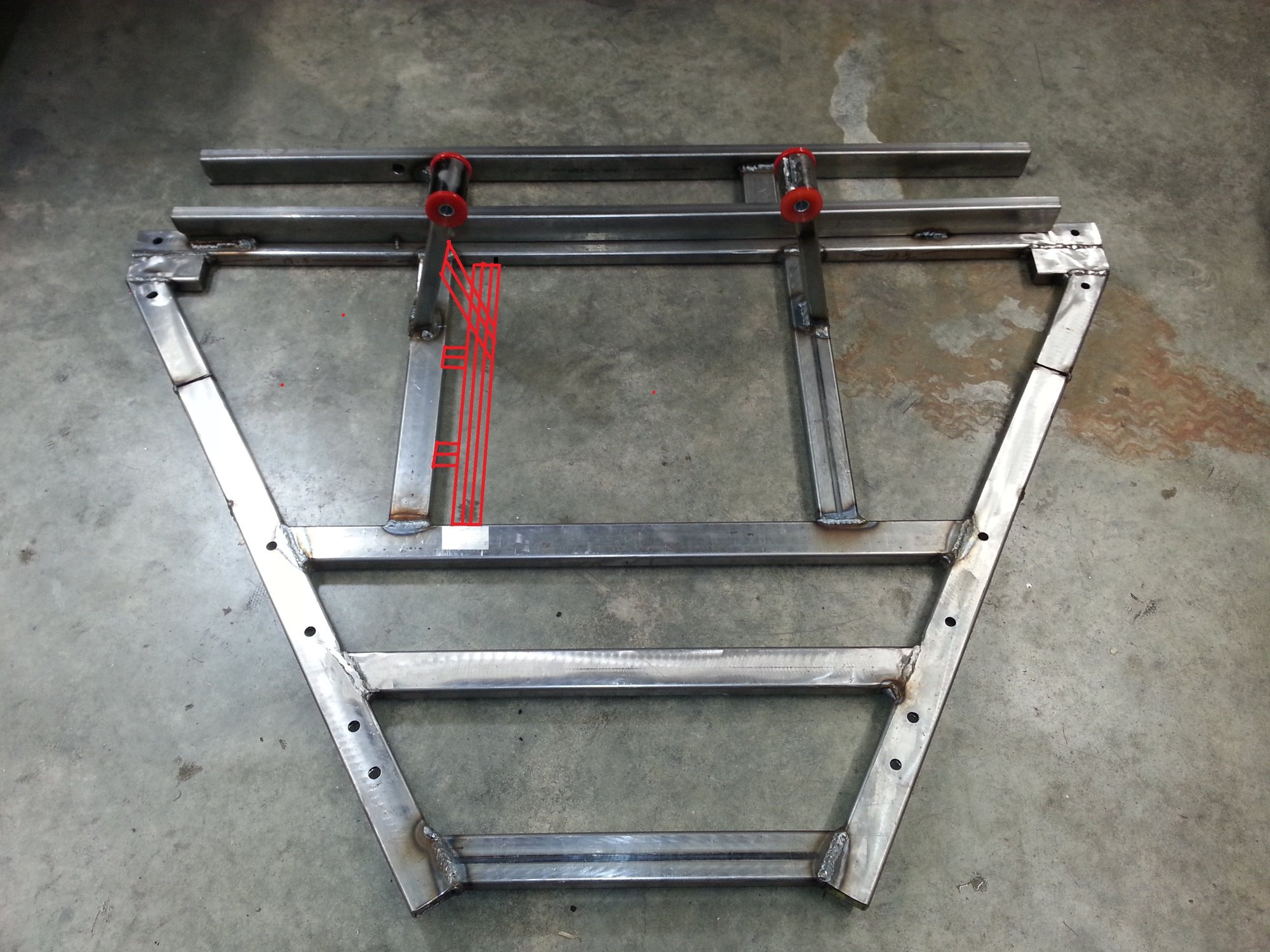

So I am almost finished with the sub-frame. Yes my welds are the uglyest ever. I'm going to map out some drain holes and then paint everything.

Since you have the room why not triangulate the engine mount? Just seem a little tall to have no bracing to me.
I agree. Gonna be a lot of leverage on that TALL mount column.

I agree the engine's going to need more support. This is a work in process and I do want input, So thanks
There is a lot of room in the engine bay because the LS3 isn't nearly as wide as the flat 3.4 . When your building a
car that's mid-engine and a hard top (alone in your garage) seeing everything well and the first time is a challenge.
My CL65, conventional front engine layout is much easier to see everything in one snapshot. My LS6 Porsche 914
was a mid-engine car but didn't have a traditional hard top or concealed engine bay so I could get a good picture of
everything. This car is different a bit more of a challenge. The engine wiring / ECM kit / package is on back-order but
should be coming in the next week or so .

%%%%%%%% So here is a crude drawing (both mounts will have the added structure) of the extra steel I'm going to add to my engine cradle. The peaces are .120 wall and as it is not sexy it will do the job and not get in the way of other future add-ons. Seems like this project is just crawling along slow going but hopefully I can get the car running and driving this year

That should help a lot. I was almost thinking some fore and aft bracing might help, but not sure it's needed if the tranny is firmly mounted.
