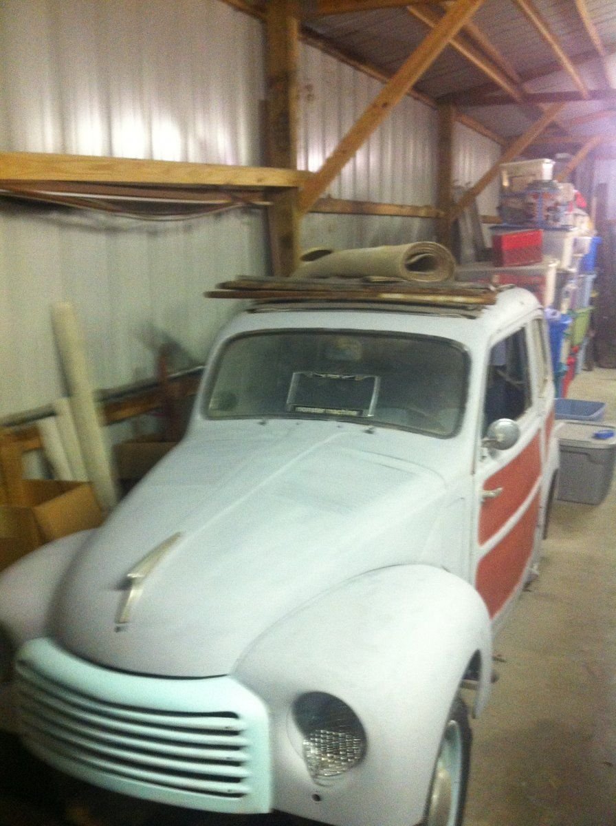

the vehicle is a 1952 Fiat Topolino Belvedere (wood sided wagon). originally born with a 35 cubic inch 16hp motor and a 4-speed transmission...... Its got 3 doors, 4 seats, a retractable soft top and will have a target weight between 2000 and 2200# with as close to a 50/50 weight distribution that I can get. currently the calcs are 50.5 front, 49.5 rear.
The car total length is just shy of 11 feet, and yes, I know that many altereds started life as early fiats and were stretched to fit a V8. this will remain the same length it left the factory, maybe even shorter as the bumpers were removed and I will be fitting a nerf bar style bumperettes.. that is shorter than 4 seater golf carts and literally the same length and currently the same width as an MG midget. currently its just a tick over 50" wide. and 54" tall.
current wheel base is 78", way too short, so that is getting stretched. rear axle is moving backwards, front axle is moving forward. the final wheel base will be between 88 and 90"
to literally fit the width of the transmission and the seats and keep the car a manual, which means the footwells need to go from what is now only 9" wide with the bellhousing and transmission to a minimum of 12"........ it needs to be widened. That is splitting the car down the middle and adding 6+ inches of width. because the proportions are wrong as it sits, and its taller than my daily whip, It will get a mild chop along with having the fenders widened 5-8" on each side
Since I could not find a 3D model of the 500C, I am currently using a model of the 500B - same dimensions, different grill and facia. I will be modeling the complete vehicle including the body sectioning while I am sourcing parts, validating fitment in 3D prior to validating in 2D. in the past I must have hoisted engines and transmissions into a chassis no less than 20 times per build. This build will be planned down to a complete model of the frame, cooling system, HVAC, etc.

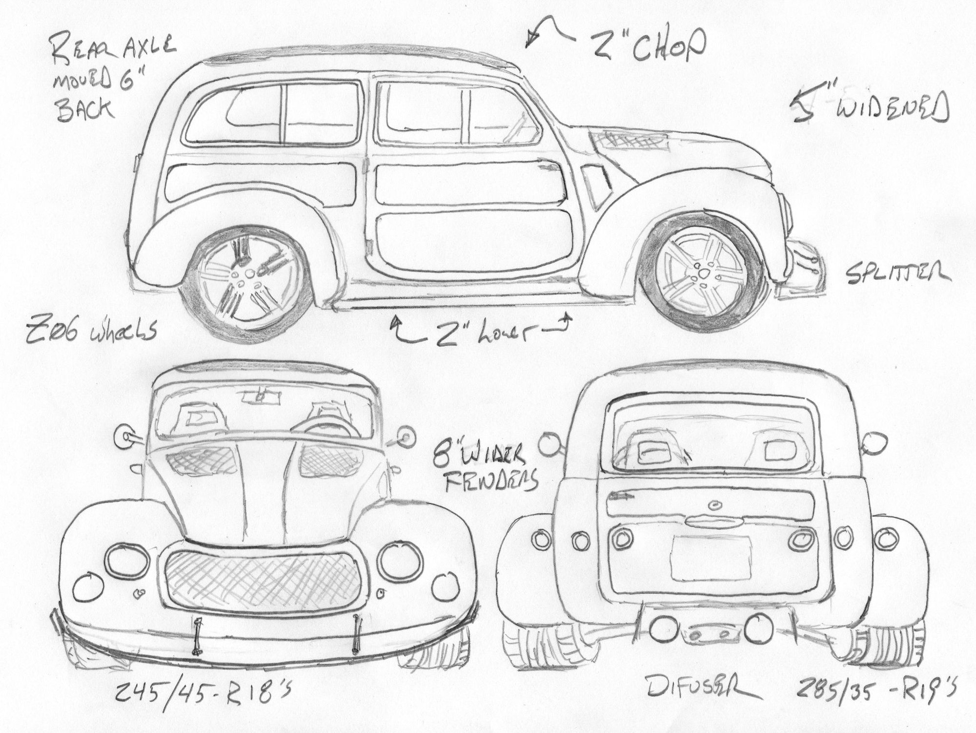

A while back I doodled my version of the crazy vs hot matrix for vehicle projects. its cool vs difficult this project is a solid 8-9 on the difficulty scale while being only a 4-5 on the cool scale currently.
https://www.hotrodders.com/attachments/1769617105468-png.641644/?auto=webp&fit=bounds&format=pjgp&height=1920&opti  mize=high&width=1920
