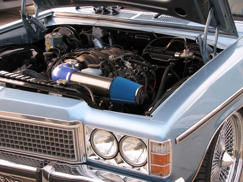

Default LS1 Conversion
1978 Holden HZ Premier Sedan
2003 5.7L LS1
TH350 - 3800RPM Converter
9" LSD with 3:9 gears
See pictures below
Here is a picture of the old setup:
Holden 5L
STA Supercharger with Intercooler
Straight LPG
Old Jun 25, 2008 | 03:33 AM
  #743
rsz288's Avatar
Joined: Apr 2008
Posts: 838
Likes: 12
From: Right here, right now!
Very "nice" HZ mate! Cheers!

^^^ that holden is sick..its like a mini 70's model Caprice/Impala, very nice..any more pics?
