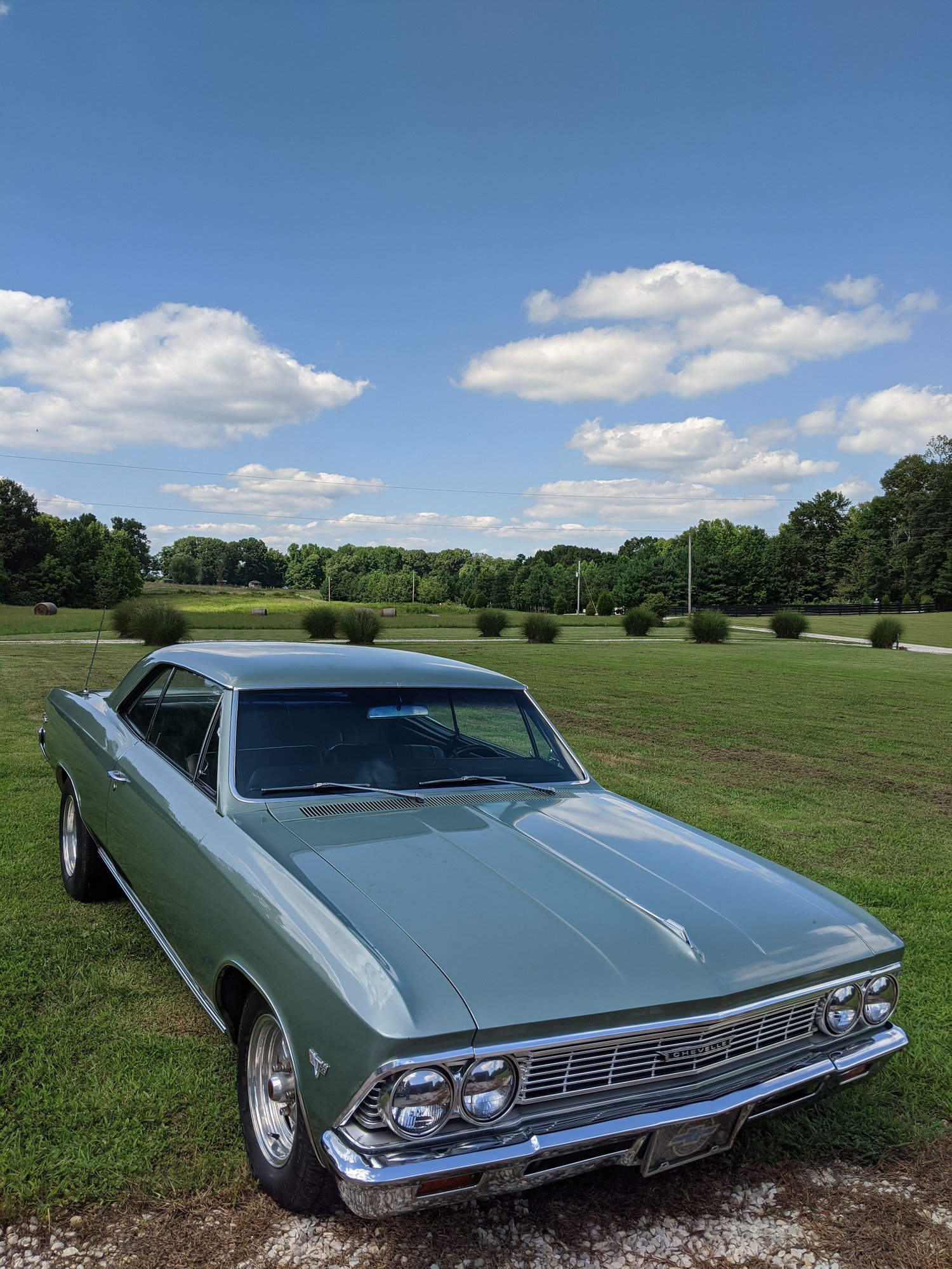

1966 Chevelle
Opinions, links to parts and good deals, advice are all welcomed!
Things to do:
Building 6.0 to replace SBC
TH400 or 4L80E to replace TH350
GM 12 bolt to replace 10 bolt
Disc brakes - hydroboost
Front and rear suspension
Mid frame stiffeners
Wheels and tires
Fuel system
Parts still needed for 6.0 build:
Square port heads
Cam - valve train
Injectors
Fuel system
Turbo manifold - like the FSP manifold
Holley EFI
Oil pump and pan
Engine mounts
Throttle body
Intercooler
Parts I have for 6.0 build:
6.0 iron block
Stock LQ4 crank
LS3 intake, injectors, fuel rails
On order forged pistons and rods
VSR 7875 next gen billet turbo
Turbo Smart 50mm wastegate
I almost want to go twin 7875's. Just not sure. Might see how the single does and possibly go bigger if needed. The 7875 should have no lag and be very torquey. I don't really have a HP number I mind. I'm sure the single is plenty.
Undecided about TH400 or 4L80E. I don't make long trips on interstates. Would like the OD and lockup, but some of the 4L80' are pricey compared to a 400.
Holley EFI. Terminator X? HP? Dominator? If I have the extra money, I'm going dominator. Just depends how quickly I want to get this project done.
Fuel system - Fuel cell, flex fuel, water meth injection.

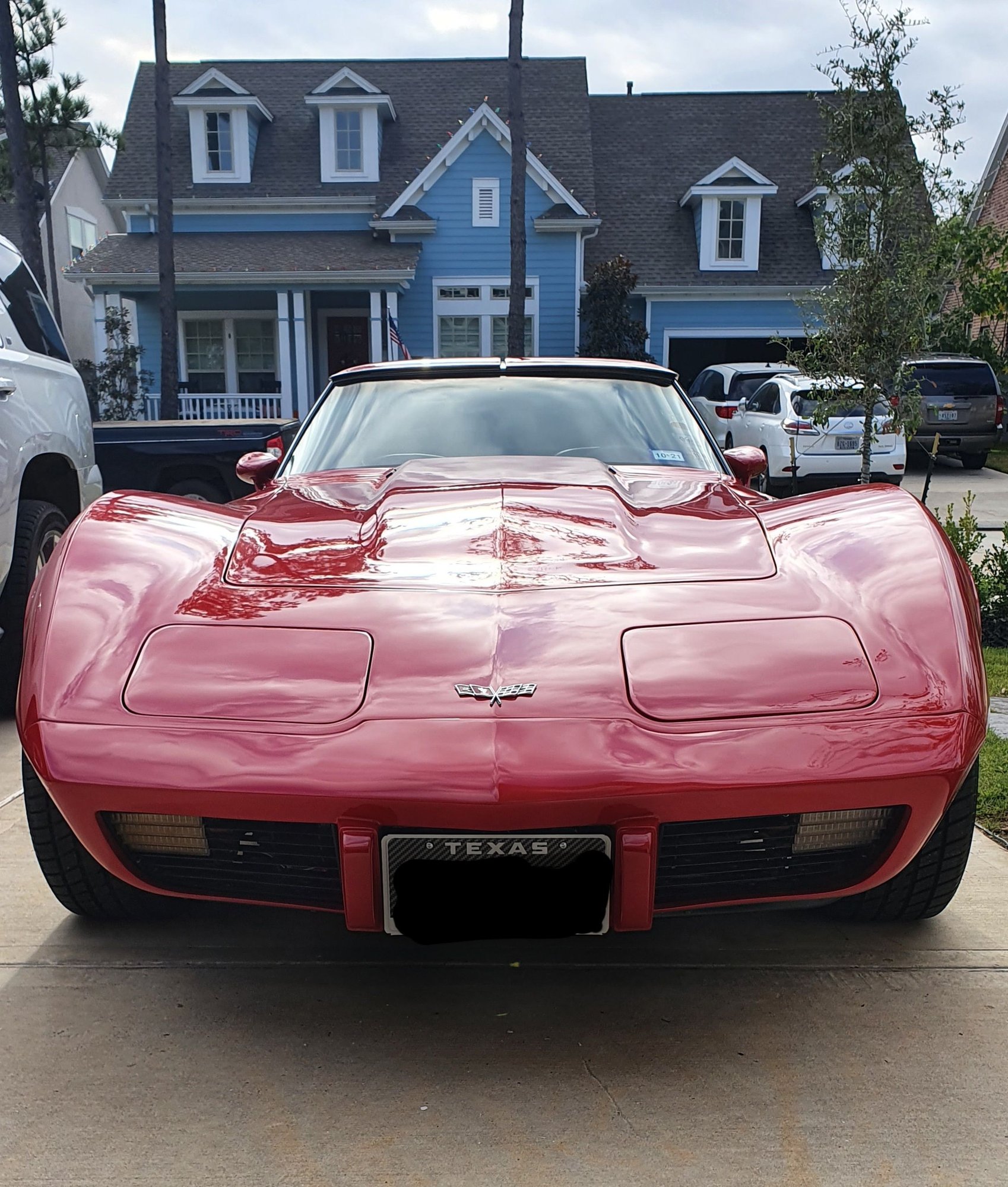

Default C3 lsx
1977 C3 Corvette L82
LS1 with Dorman 901 intake and long tube headers, A4 (4L60e)
306 rwhp @ 6, 052 rpm
295 ft-lb @ 4,871 rpm

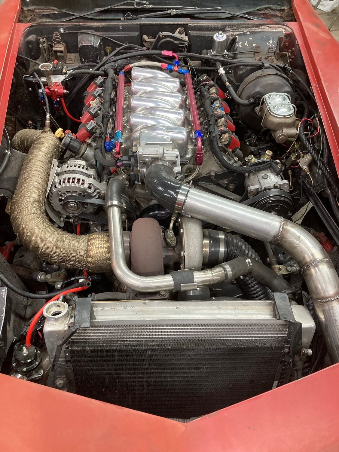

1977 Corvette. Mostly Cruiser, Occasional Drag Car.
88mm turbo, no wastegates
6.0 LS1 with forged pistons and rods.
1000cc Injectors, Walbro Hellcat 525LPH Fuel Pump with dual feed fuel rail
Surge tank
Speedmaster intake, F body Oil pan
4L80E, forged input shaft and drum, dual feed direct, 2nd and 3rd accumulator delete
Ford 8.8 with 9" internals and axles on 4 link suspension with dual adjustable shocks.
Volvo Electric power steering
Denso hairpin digital alternator
Volvo brushless digital coolant fan
LED headlights
4" aluminum sidepipe exhaust.
AEM Infinty engine management.
A/C in progess.
DIY Arduino touch screen with Cruise, Sport, Burnout and Drag driving modes. PWM controls for: 4L80E, coolant fan, Intercooler fans, trans cooler fan, oil cooler fan, alternator, surge fuel pump, primary fuel pump, no wastegate boost control.

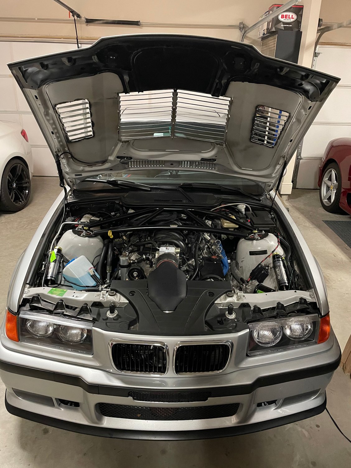

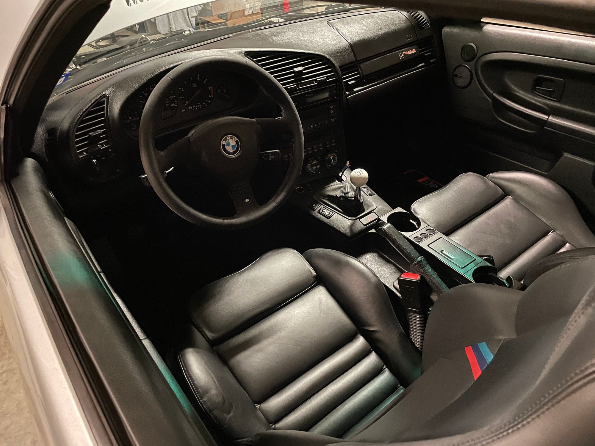

1998 BMW M3
LS3 (CPP 376/480)
Thanks,
98 E36 M3 w/LS3 swap

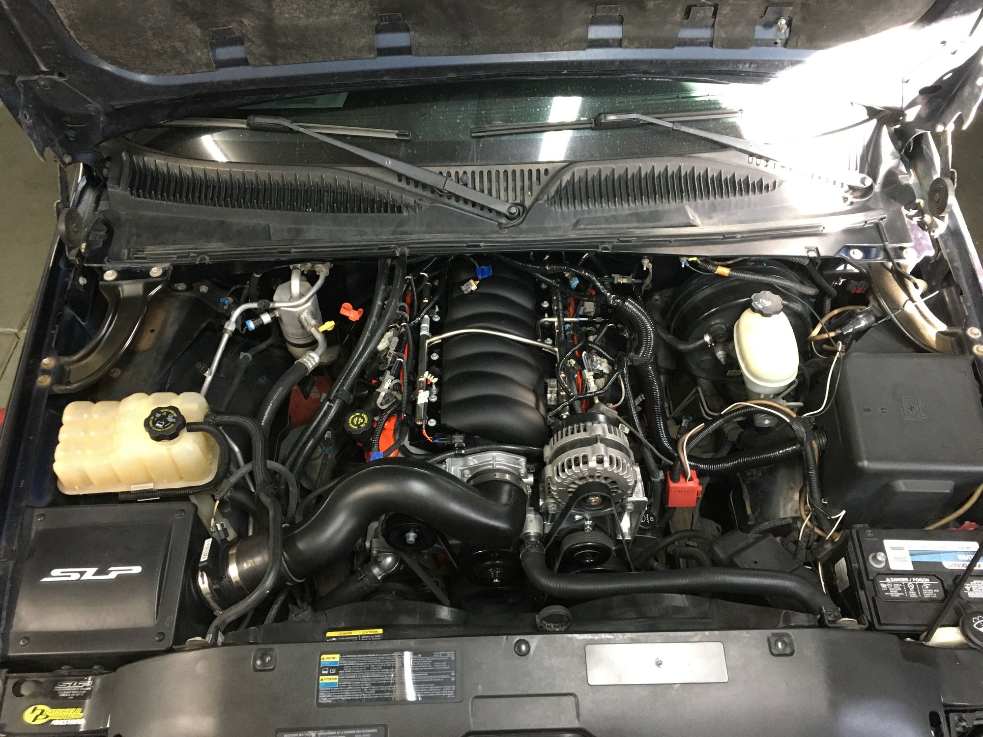

2005 GMC Sierra
6.0 LS3 top end 460/450 crate motor
RPM stage 5 4l60
